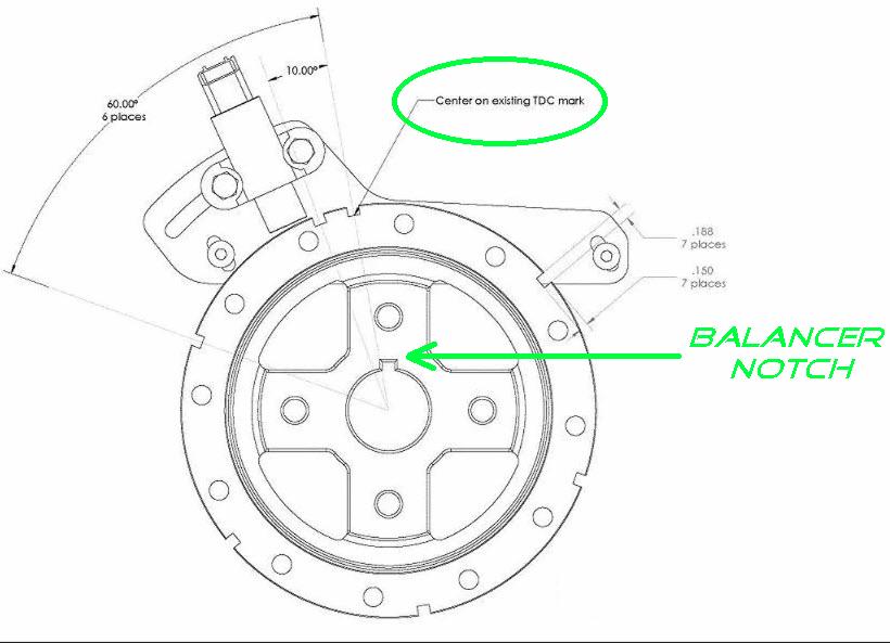

Here is a drawing where the factory damper notch is located in relation to the mounting hub notch.
This is when the balancer slips. Notice how far the notch has slipped compared to the drawing of the stock TDC mark?

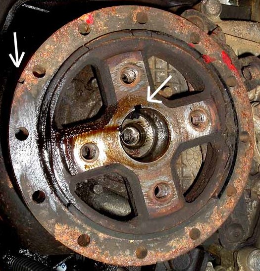

 | | CLICK FOR FULL SIZE |
Heh heh... that's my photo of my '86 GT from 2008, although the image has been rotated and cropped.

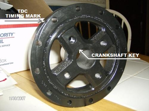

| quote | Originally posted by Patrick Here:
Finally got a harmonic balancer to replace the one which had “spun” on my GT. Here’s a picture of what I saw after I took the crank pulley off. Notice where the main timing mark and keyway are.
Now compare the relationship of the timing mark and keyway with this image of a good balancer.
Had a heck of a time finding a long enough metric bolt at various hardware stores to use to pull the replacement harmonic balancer back on!
