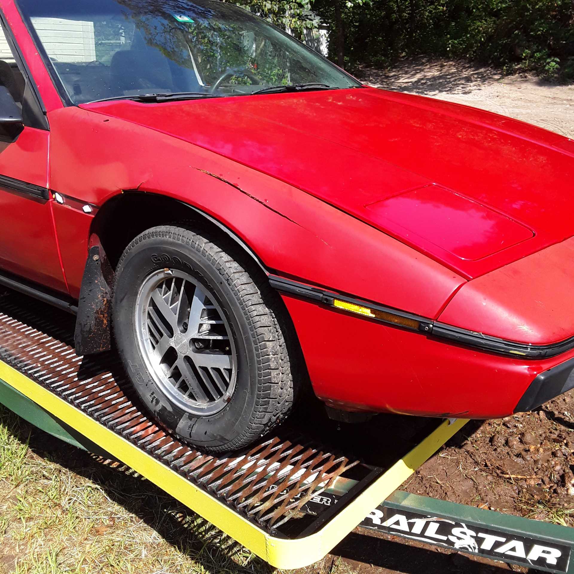

Well, that is one of my issues. The '85 has a damaged front PS fender. I was hoping to pull one off the '84. Do you know if it can be easily made to work? Also, I'm trying to get the damaged fender off, but it looks like I need to remove the lower side trim to get to the last 10mm bolt. Any suggestions? It looks like that is riveted in, so am I going to have to drill those out?

Yes, you can take the panel from the 84 and put it on your 85 or 86. They are nearly identical, just the holes in a couple of the more inconspicuous places are slightly different... not at all a problem.

I have only just begun to dig into both cars so at this point I have no idea what all I might need. I have a damaged front PS fender on one, a non-working parking brake, a missing front hood pull handle, and I'm sure a lot more things along these lines. Not so concerned about engines as much as suspension, steering, body, interior. I just thought the list of things that got changed in the '85 model year would be fairly short compared to what was kept.
I've drilled those large plastic rivets out, and then just used regular (appropriately sized) metal bolts as replacement fasteners.
