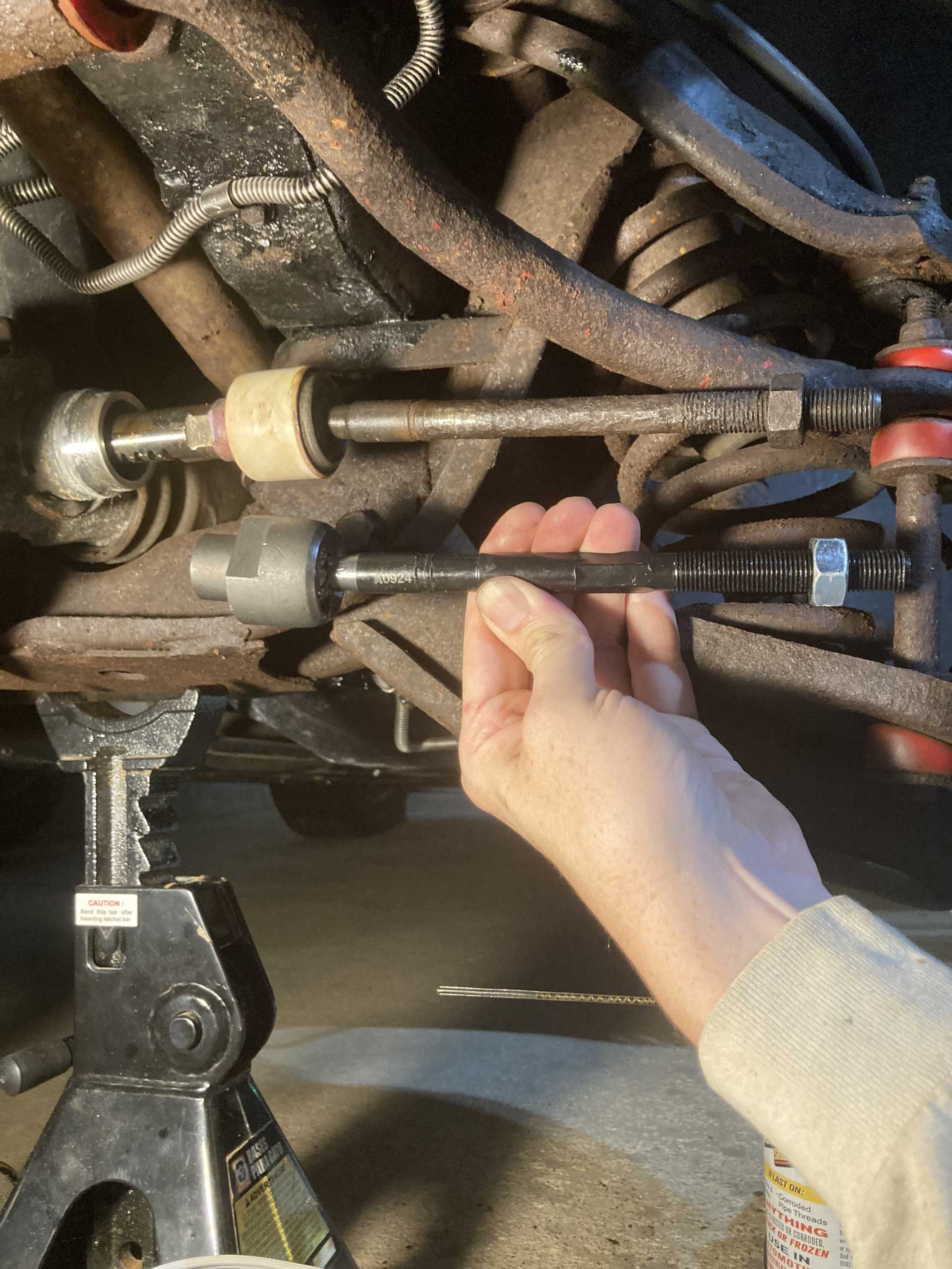

so am replacing the driver side inner tierod now..
another question on this.... i cut off the boot to access the flats on the inner end and there is a white plastic "bushing" covering it. i may try to slide this off. what is the purpose of this "bushing" . it doesnt seem to interface with anything.
i have a service manual and it doesnt seem to talk about this bushing. the replacement tierod didnt come with one.
also... the service manual talks about a staking procedure. as far as i can see the old tierod or new one doesnt have any staking provisions. do people just screw and install the tierod to the steering rack with loctite?
Greg

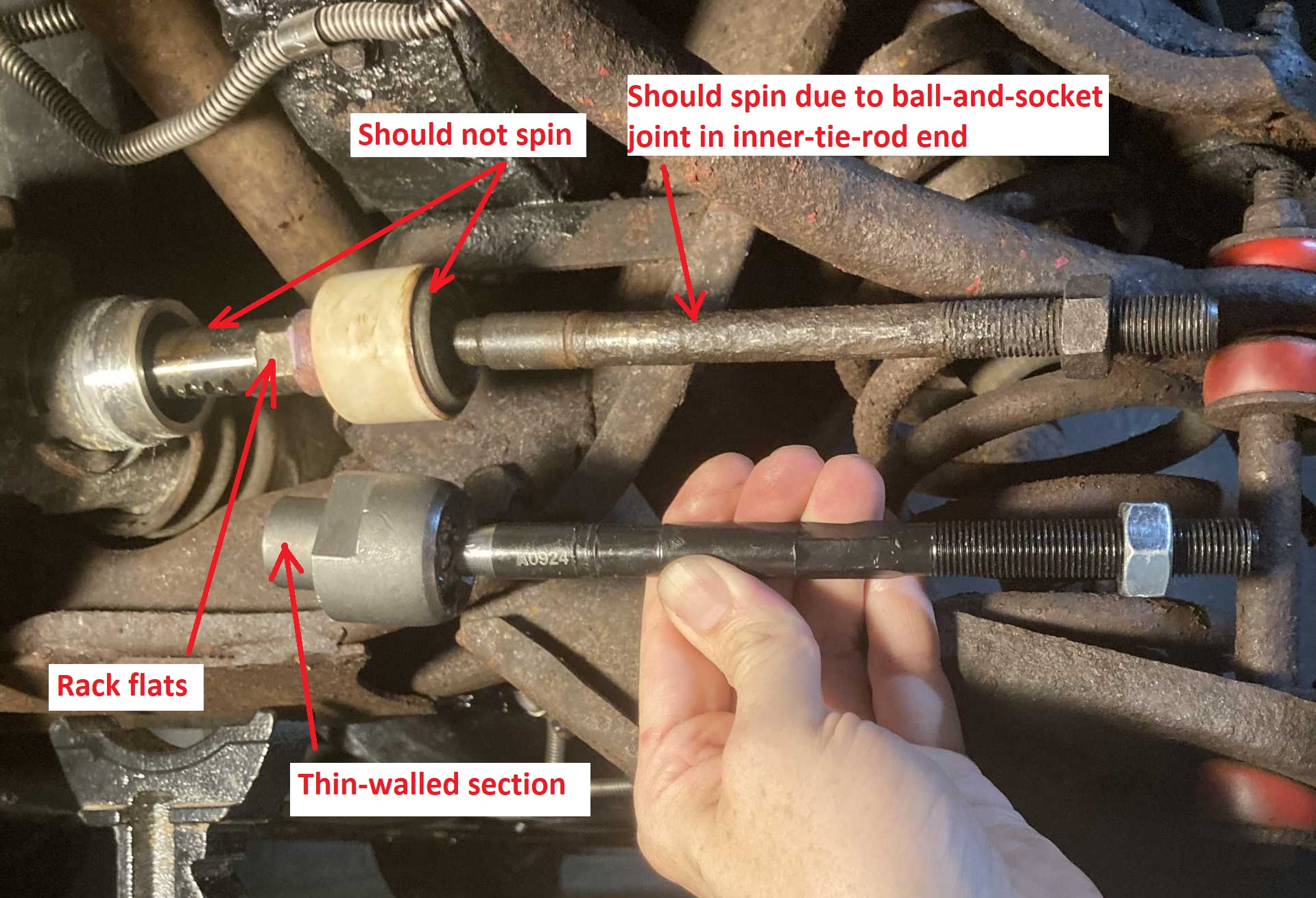

Yes, the tie-rod should spin.
I think that the plastic bushing exists to soften the impact between the toe-rod and the rack housing when you hit the travel limit. I am not sure. It fits with friction around the tie-rod end. You can push it off by hitting around it with a hammer + punch.
Staking here means that once the tie-rod end is screwed onto the rack, you smash the thin-walled section of metal onto the rack's flats so that the tie-rod end cannot unscrew easily. I am not sure how easily this can be performed with the steering rack assembly still in the car.
There is a lot of shoddy work out there, so I am sure that some folks will just Loctite this and call it a day.

gregr75
AUG 01, 03:06 PM
awesome! thank you! now that you said it, i looker closer at a youtube video where the owner peened that thin wall area you show in your pic.
