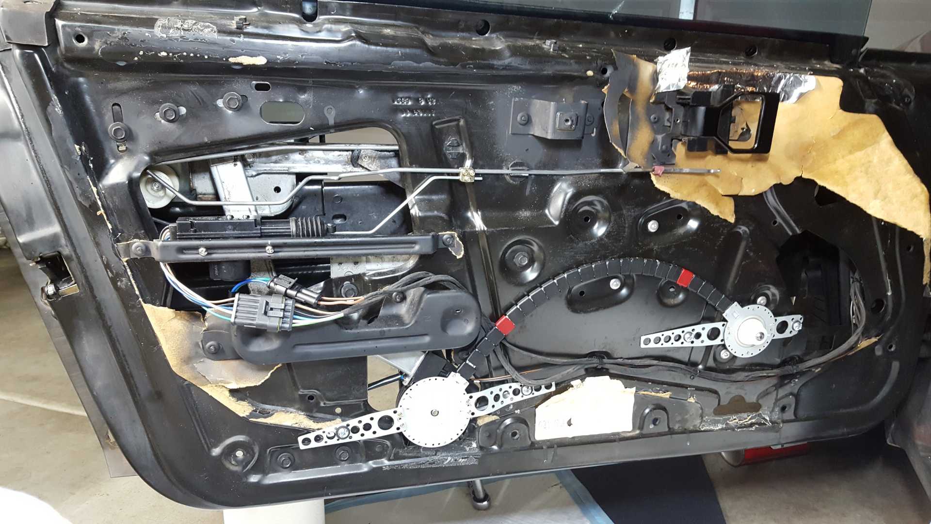

Power Locks with module:
Power locks installed:

this is very helpful.is that an aftermarket power window setup?
cyrus88
JUL 06, 04:20 PM
Yes it's an aftermarket window setup
i stole your design completely.thanks.
