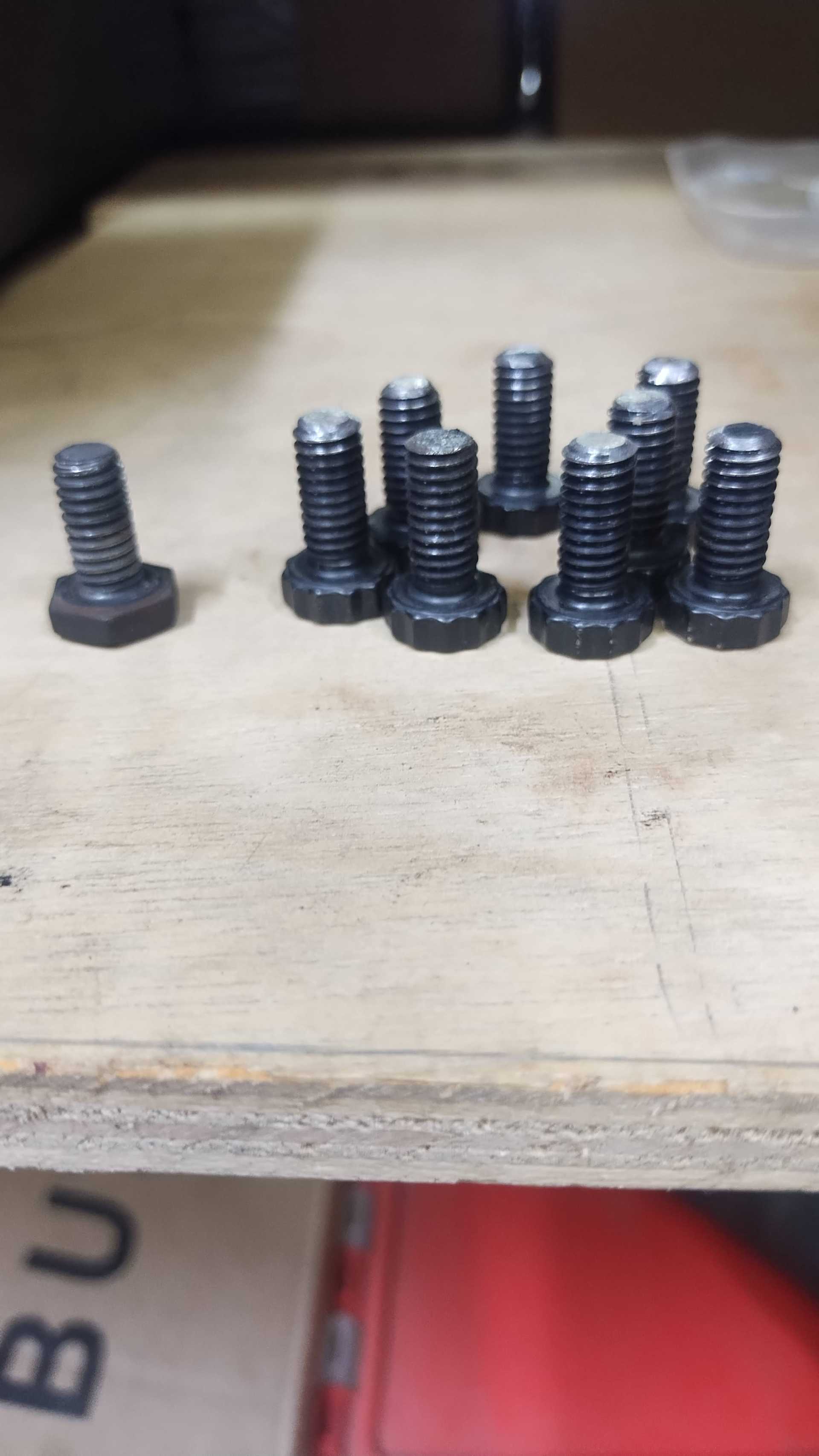

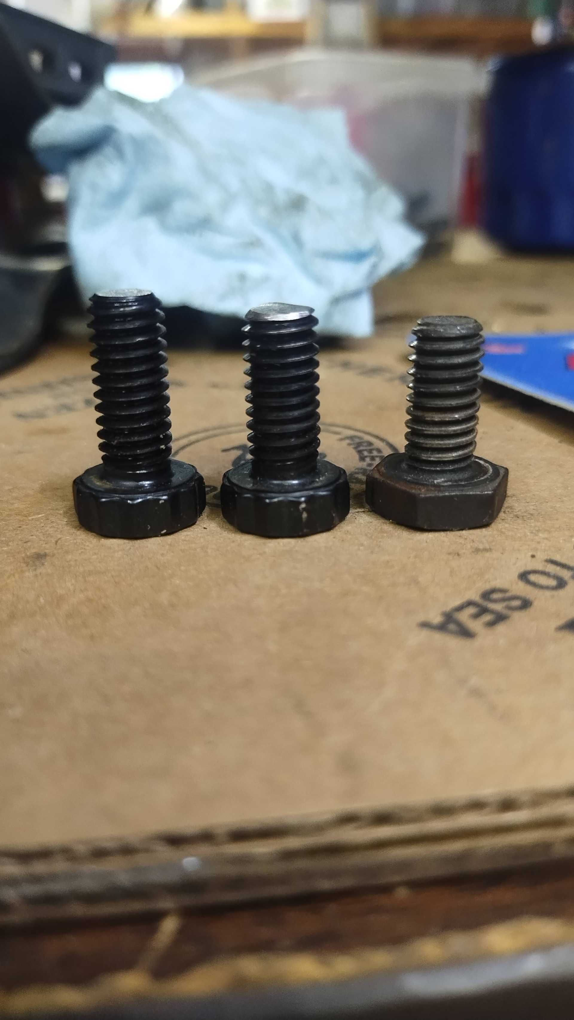

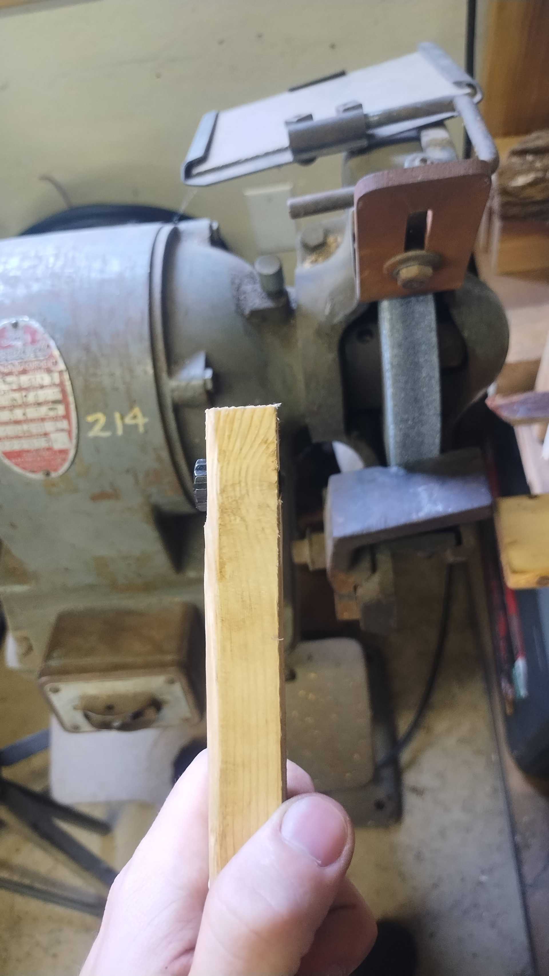

I have been looking on here and on various forums for info on using the ARP 234-1001 cam bolts for flex plate bolts (I didn't feel like paying $200 for ZZP one time use bolts i'm still in school not made of money). I found minimal info so i figured I'd make this post for anyone who may be curious. I went ahead and bought 3 sets of the cam bolts, and as I expected, they were too long, bottoming out in the crank before the head seated on the flexplate. I did some measuring using the old bolts and determined that the max a bolt would thread in was about 0.540" and the flex plate is 0.170" thick. The ARP bolts are 0.750" long so i needed to take at least 0.040" off to clear. I made a jig out of wood that would let me take 0.065" off (i figured extra clearance is good) and made 8 custom length bolts. These bolts are a bit longer than the factory bolts which i like because they use all the thread available. Hope this helps someone, let me know if you have and questions or concerns.

if the bolts fit thats good BUT you should consider using a Grade 8 bolt hardness for them to hold up. Grade 8 bolts are expensive because they are made of high grade steel. Check with ARP for the grade or look at the top of the bolt head. Also check the GM part number as they still may be available. ------------------ " THE BLACK PARALYZER" -87GT 3800SC Series III engine, custom ZZP /Frozen Boost Intercooler setup, 3.4" Pulley, Northstar TB, LS1 MAF, 3" Spintech/Hedman Exhaust, P-log Manifold, Autolite 104's, MSD wires, Custom CAI, 4T65eHD w. custom axles, Champion Radiator, S10 Brake Booster, HP Tuners VCM Suite. "THE COLUSSUS" 87GT - ALL OUT 3.4L Turbocharged engine, Garrett Hybrid Turbo, MSD ign., modified TH125H " ON THE LOOSE WITHOUT THE JUICE "
Your typical grade 8 bolt has a yield strength of 120,000 psi, whereas these ARP cam bolts claim 200,000 psi. These bolts seem to be what most people run for their flywheels on 3800 swaps.
