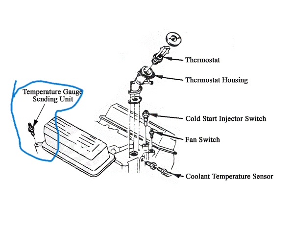

Rune82
MAY 25, 10:10 PM
 This is the one i have been testing and replaced
1985 Fiero GT
MAY 25, 10:39 PM
| quote | Originally posted by Rune82:
I have tried a known good sensor and im replacing and testing the one just below the distributor
I never saw one near the thermostat housing?
Also its a resistor on both sides does it affect it if its the wrong way around? |
Ok, and what are your symptoms, is it that the gauge isn't working? Or that the ECM doesn't see the right signal and triggers a check engine light for the temp sensor, if it's ECM, it's a different sensor, if it's your gauge, your testing the right sensor. It's not a temperature variable resistor on both pins, that's only the one pin for the gauge, the second pin is a simple on/off temperature switch, like for the fan, to turn the light on and off, if the switch is wired to the gauge, you'll have no signal (like the wire is cut) until it overheats and the switch turns on (supposed to turn the light on, in this instance it would then peg the gauge all the way over past hot). My guess is the wires are swapped, one pin on the sensor should be open (not connected to ground), one should have a resistance to ground, ground the wires individually to identify them, the one that turn the light on should be connected to the open pin, the one that pegs the gauge should be connected to the pin with resistance to ground.

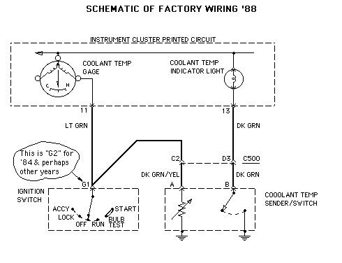

Vintage-Nut
MAY 26, 10:33 AM
Coolant Temperature Sensor {to the Dash Guage} and Switch {for the Hot Idiot Light} GM 25036809 / AC Delco 213-71 / Standard TS-168
One connection feeds the coolant gauge and the other feeds the high-temperature warning light.
Schematic
Sensor Temperature vs. Resistance
