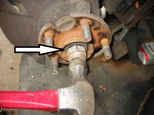

| quote | | The new bearing hub has a new 30mm nut, discard the old one but save the washer that was behind the nut as this will be re-used |
How to replace the rear bearing hubs, with pics. https://www.fiero.nl/forum/Forum9/HTML/000022.html
PS - This thread photo shows the 1984 rear hub
*Dorman 618-026 Rear Spindle Nut Washer Fits 1984-1987 Pontiac Fiero
Perhaps '88 doesn't have the washer...? [This message has been edited by Vintage-Nut (edited 05-26-2025).]
