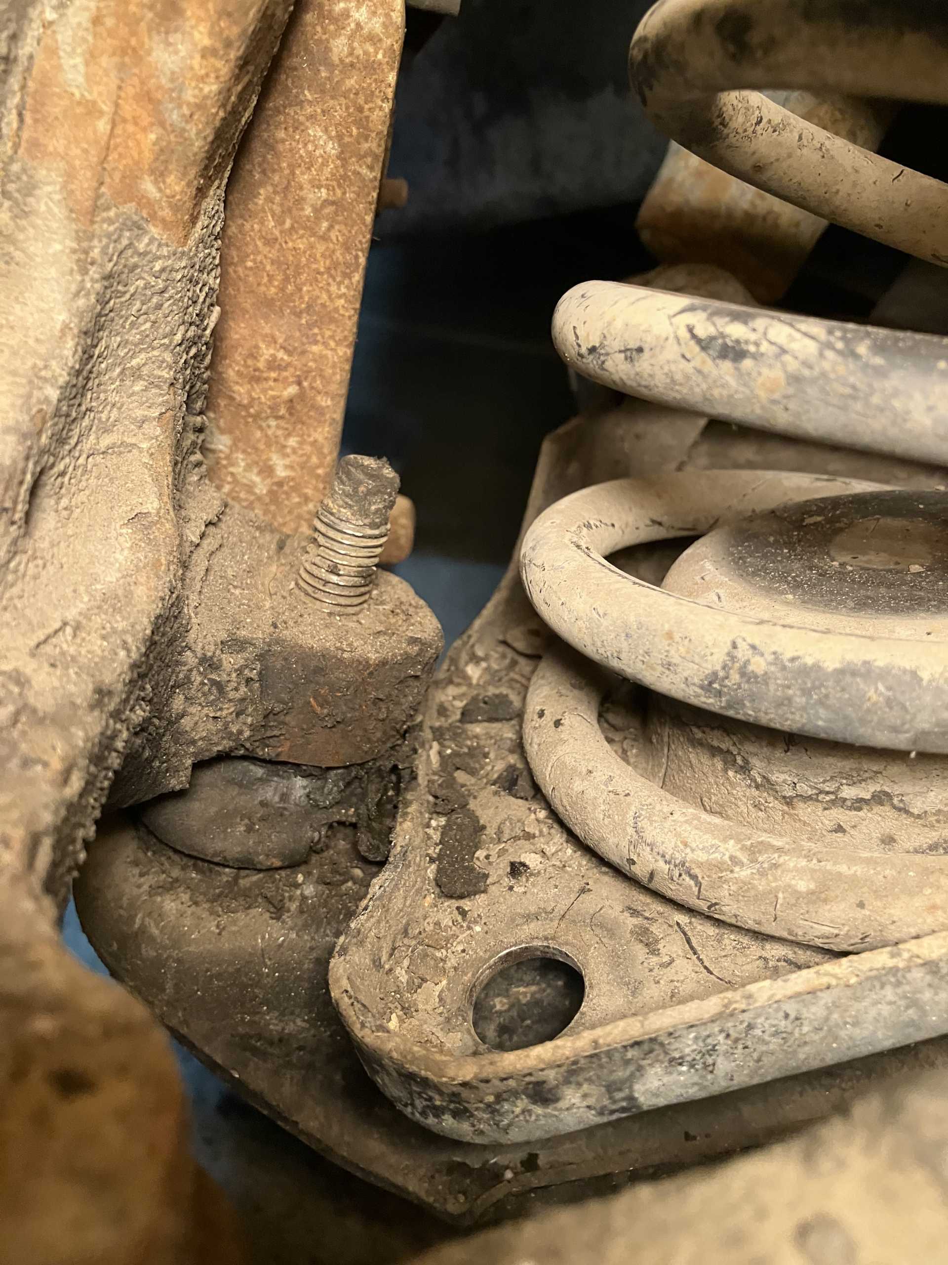

Hello all .
Trying to figure out why the front oem springs are not coming out? Note: All the suspension components on this car is OEM / original and overtime. Dust and rust did accumulate in the wheelwell area and is now cleaned. My project is to add performance springs. I did as instructed removing the required nuts to the sway bar. shock absorber & ball joints. To me. It seems that the ball joint assembly is sticking and is not allowing the lower control arm to freely fall. I hit against the knuckle & spindle without any luck. Have any of you had a similar outcome? Are there specific applications involved with the Fiero in order to get these springs out? Any suggestions would be great

You'll probably need to disconnect more things to let the lower control arm drop farther. I popped out one of the ball joints, and still the spring was under tension and needed to be levered out with a prybar.
If you have a spring compressor that will fit, that will help a lot. (mine did not fit, there isn't much space to work with)

Yeah the front and rear springs are under compression even at full suspension droop (the rear is held captive by the shock, the front by the suspension geometry).

| quote | Originally posted by MERATIME:
.........not allowing the lower control arm to freely fall.
| quote | Originally posted by Vintage-Nut:
After the knuckle assembly has been removed, carefully and slowly; lower the bottom control arm to remove the springs...
Keyword.....SLOWLY lower the control arm. When I see the term "freely fall" so will the spring......freely shoot across the room.

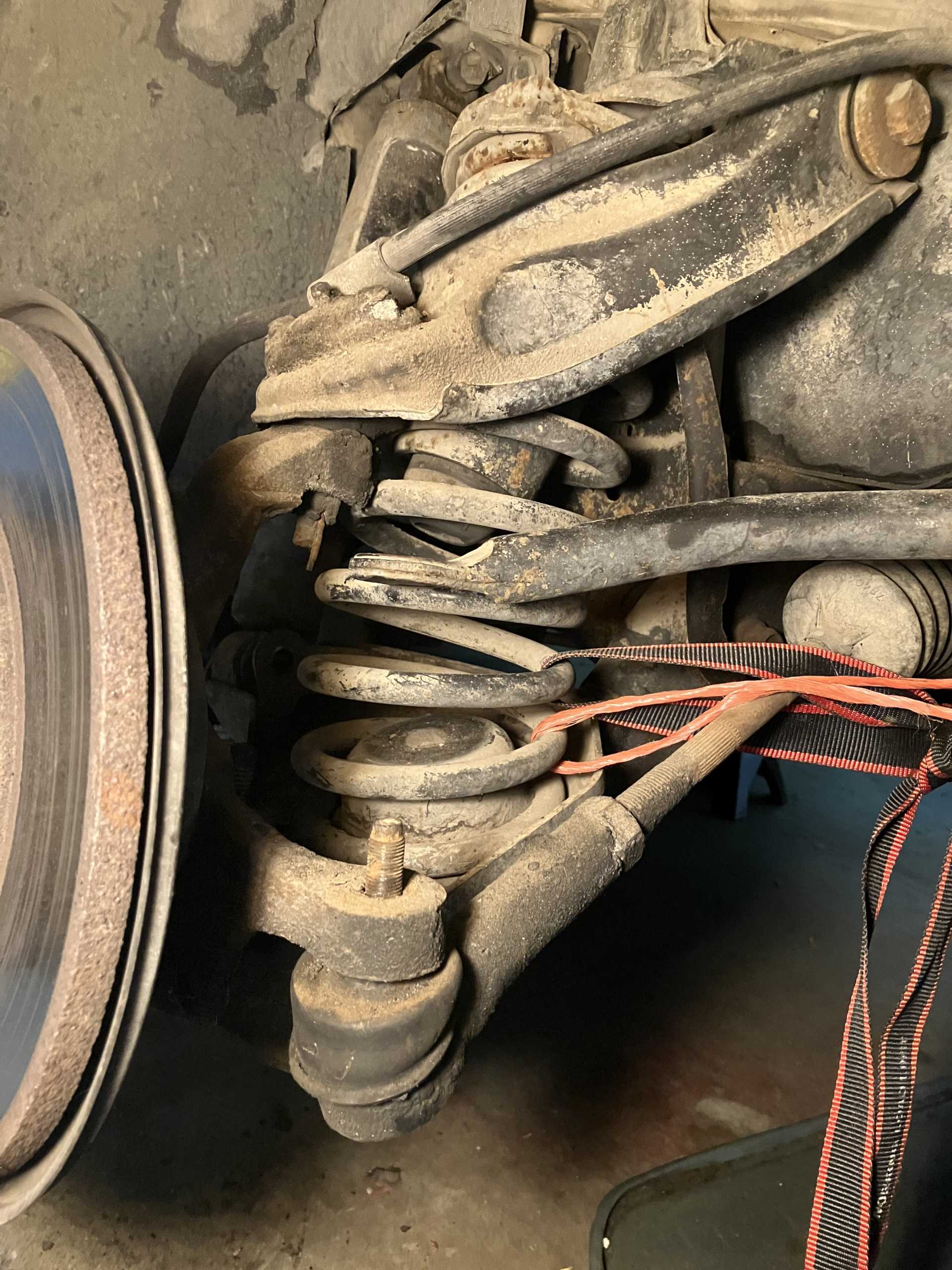

This is how my lower control arms were hanging when I popped the front springs out of my '84 years ago. I remember I had to pry the bottom of the springs up and over the centering hump in the LCA. I used a chain to prevent the springs from inflicting damage to my face.
If you plan on installing lowering springs, I hope you're planning to shorten the metal "cones" which center the top of the springs. Otherwise, you'll be riding/bouncing off the bump stops. They need to be shortened from 5-1/4" to 4-1/2". (The rubber bump stop is missing in the photo below.)

THANK YOU ALL …. For all your help After looking for availability on all the tools you all mentioned , I ended up using this one showing in the image below and it worked successfully Patrick. I cannot thank you enough for your photo and advice to hold up the rotor assembly. Here is a photo of what I did to temporarily remove the springs. I really appreciate all your help!
