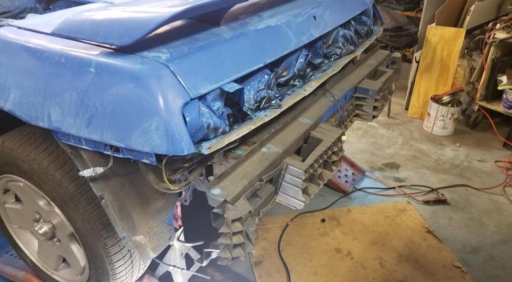

Pull the taillights and loosen the top (push pins) and sides of the bumper cover (side marker lights, wheel house liner)
There is a metal shelf below the taillight area.
Bend the metal shelf up to restore the desired gap.
Reassemble.
It should take an hour or two to accomplish.

My '84 and '86 are metal, I believe my '87 is metal as well. The design was changed for '88, as my Formula has a plastic shelf.
If I remember correctly, there's some adjustment available with the position/height of the shelf. But yeah, the metal ones could've sagged downwards and might need to be bent back up.
The shelf can be seen below.
