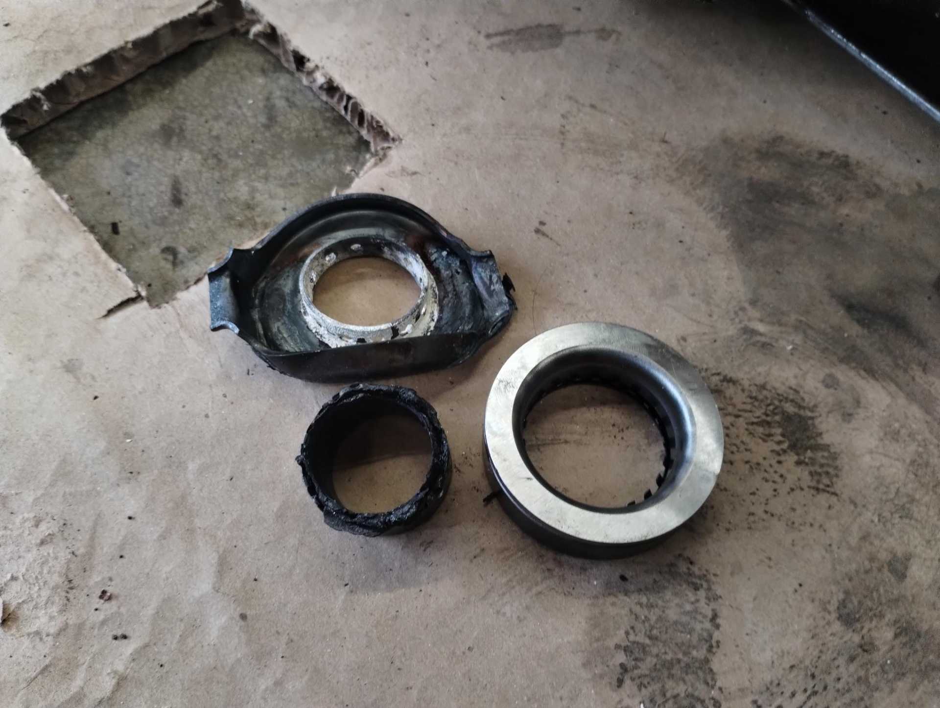

Apparently the throwout bearing was completely destroyed.
All I can figure is I installed the throwout bearing in backwards (is that even possible?). Anyone have any thoughts and or confirmation that's what I did? I've ordered a new clutch kit so I'll replace everything. (again).
I've been searching and most of the older pictures are long gone, so which way does the TB face? I don't recall it being marked.

Was this throw-out bearing re-used? It looks really burnt (but all that could be simply because it failed).
I'm no expert here (only done this twice)... but I know that the throw-out bearing can only go one direction because the little pads are supposed to rest against the fork-arm... so if you were to put it in any other way, it wouldn't operate properly.
Some thoughts:
- Maybe the throwout bearing had never been greased? Normally they come pre-greased. - Did you use any grease other than what was supplied with the kit? - What was the quality of the clutch kit you used, was it made in China?

Thanks. It was new. LUX clutch kit, and just grease supplied with the kit. She sure did smell burt too!

looks like it was installed backwards as there looks lie no wear or burning on face of bearing. All burning on bearing retainer side
