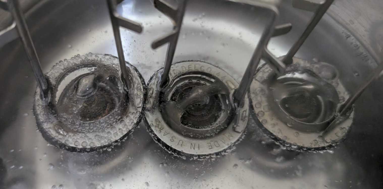

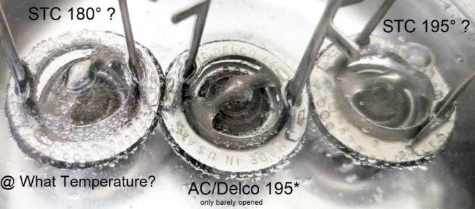

I tested the two 195° thermostats I have here and they opened but one only barely. Surely not enough for unobstructed coolant flow. The other one opened a bit further but still not as much as a third thermostat I tested. This third thermostat is a 180° thermostat and it opened much further than the other two.
So the best performing was the STC 180°, then the STC 195° and the worst performing by far was the AC/Delco 195°.
I haven't driven with the 180° thermostat yet, so I will try that today and see if that makes a difference.

| quote | | I haven't driven with the 180° thermostat yet, so I will try that today and see if that makes a difference. |
It will either solve the problem or another data point....I hope that the shop didn't leave a rag in a coolant tube!
BTW Water boiling point is 212*F and your water looks like it is barely boiling....did you use a thermometer?
