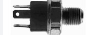

Hello friends, I have just visited two different auto parts stores and they are showing in stock under an 87 Pontiac Fiero, SE 2.5 L engine this option oil pressure switch
My question to you guys: Will this work for this engine? I have heard something about there are different oil Pressure switches required for different years. Please share with me your thoughts. Thank you.

Well, it not the OPS for an 88, so that's a plus.
If the parts store says that's the one, at least the prongs look right for an 87.

AFAIK the oil pressure sender/switch is a combined unit. It provides the sensor signal to the gauge but also provides a secondary voltage line to the fuel pump relay. The ones that I have seen are all three pin units. ------------------ " THE BLACK PARALYZER" -87GT 3800SC Series III engine, custom ZZP /Frozen Boost Intercooler setup, 3.4" Pulley, Northstar TB, LS1 MAF, 3" Spintech/Hedman Exhaust, P-log Manifold, Autolite 104's, MSD wires, Custom CAI, 4T65eHD w. custom axles, Champion Radiator, S10 Brake Booster, HP Tuners VCM Suite. "THE COLUSSUS" 87GT - ALL OUT 3.4L Turbocharged engine, Garrett Hybrid Turbo, MSD ign., modified TH125H " ON THE LOOSE WITHOUT THE JUICE "
FEB 19, 08:46 PM
This is true on all Fieros.

When I was looking for pressure sensors for my daughter's 85 Fiero, I ran into a few and did a little bit of research. Not all of them will actually give you an accurate reading. Some of them simply provide a boolean on whether the pressure is good or not. One circuit is for pressure reading, the other is for the warning light. I could be wrong, but I don't think that flat small one you ordered will actually give you a pressure reading, it likely will only tell you if there is pressure or not (which I think means it'll be stuck somewhere in the middle of the gauge... until one day it does not).
Hope someone chimes in, but I was steered away from those flat ones... because most GM cars in the 80s and 90s didn't have an oil pressure gauge, just a warning indicator, and used for the fuel pump relay.

this isn't the one on my 1987 2.5.it looks completely different.my replacement came from rockauto.it was the same as the one on it.the oil guage still doesn't work.i replaced it because it leaked.

that is an idiot light sender only. the 85 fieros use the sane one. you want the one off rockauto. i think the v6 ones work as well
