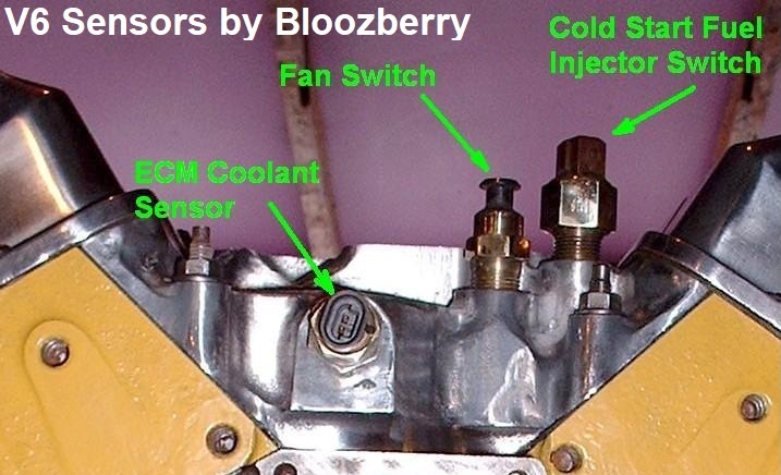

I have a 1988 Fiero Formula with stock 2.8 V6 engine. It's been garaged over the winter and little used over the past 4-6 months. Normally it starts and runs perfectly normally. Just recently however it seems to have developed a problem.
- the SES warning light is on and when checked via the diagnostic socket it gives only a Code 15;
- it needed more gas-pedal than usual to start, and it backfired, idled roughly and stalled a couple of times;
- with plenty of gas it revved up and ran fairly OK, but once warm the idle remained high (around 1400rpm);
- the idle speed did tend to fluctuate unpredictably, and once the warm engine stalled it wouldn't restart.
All this seems to point to a bad coolant temp sensor (CTS) giving no (or low voltage) signal, which tells the ECM the temp is below -30 degrees. So it feeds a rich fuel mixture into the engine which effectively floods the cylinders with unburnt fuel. Hence starting and idling problems, backfire, and high idle.
Okay, so I have to replace the CTS. First - how to find and access it. Not easy or obvious. Both this post from 2012, and this YouTube video give helpful guidance. But before I start - and I still have to order the replacement CTS - I need to clarify this mystery around the mounting of the CTS inside an additional brass bush or bolt. This additional fitting seems to have no part number, is not supplied with the new replacement CTS and according to the YouTube clip, is a standard plumber's fitting from a hardware store!
I'd like to know - (1) is that additional bushing or bolt always present? (2) Given that access and removal of the CTS is already a real challenge, any tips or tricks for extracting it without any parts breaking off or jamming in the hole? And (3) - this might be an obvious question, but is it possible to replace the CTS without draining down the entire cooling system?

I was just putting my top end back together yesterday, I seem to remember that bushing, but it doesn't need to be removed, the coolant sensor just screws into it, unscrew the coolant sensor, replace just it, and that's all you need to do, I think the bushing is to make it more durable, as you expect to replace the sensor, and if it was just threaded into the cast aluminum that might strip. And you don't need to drain the coolant at all, some will drain out, but that can be topped up through the thermostat housing. It should just be a 3/4" (I think) deep socket with some extensions as needed, the sensor is horizontal protruding from below the thermostat housing over the belt toward the passenger strut tower

GM 25036979 / Sensor, engine coolant temperature for ECM
When you get a 14 or 15 code; don't waste your time - REPLACE IT! {Many members didn't get a 14/15 code and reported a 'high' idle issue that was a 'mystery'. By replacing this sensor, their idle problems were solved...}
quote | I'd like to know - (1) is that additional bushing or bolt always present? (2) Given that access and removal of the CTS is already a real challenge, any tips or tricks for extracting it without any parts breaking off or jamming in the hole? And (3) - this might be an obvious question, but is it possible to replace the CTS without draining down the entire cooling system? |
1) The bushing is called a reducer fitting as the sensor is smaller than the manifold threads / When I replaced my; the reducer didn't move and only removed the sensor. 2) Unbold and Remove the EGR Solenoid and push the main wire harness out of the way. 3) You don't need to drain fully, but yes, you'll lose some coolant to the sensor level.
GM use a sealant on the threads; if not, I use high-temp RTV

Thanks to those who posted helpful advice, and especially the picture....
