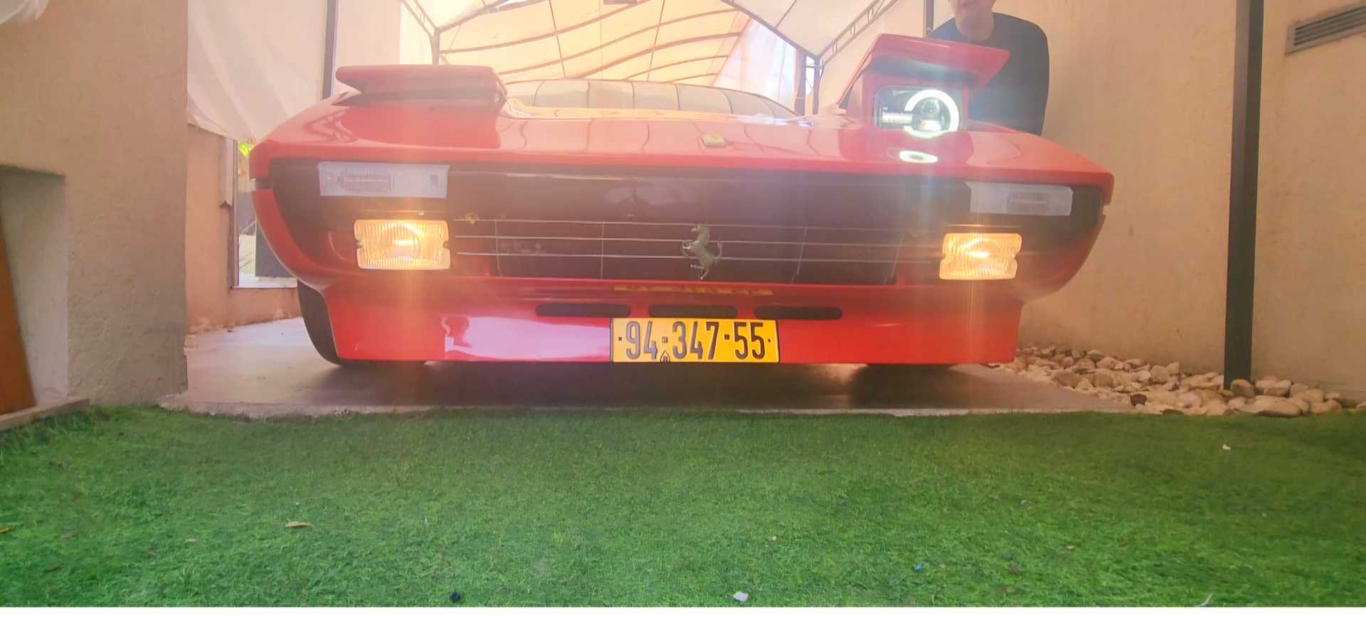

Hi,
I have an 86 SE 2.8 manual 4 speed, it's a ferrari 308 replica, my driver side headlight works good, the passinger side is weak, I checked the current to both, it's the same, I checked doors load, it's a two doors at each side. the original Fiero and the aaded one of the replica, both are nearly the same, all gears inside the motor are in perfect condition and the rubber tubes as well, it's perfectly assembled and srop OK at both ends, please see video attached, is th here any other ideas side buying a new one which is quite expensive
Itzik

you need a replacement motor unfortunately. buy one off fiero store
the problem is what i had faced just a little less extreme. your brushes and contacts are getting worn down and weak and it needs to be rebuilt
i put new brushes in mine and it worked once before shorting out the commutator and never moved again. luckily pick and pull got a few fieros and they all had rebuild motors

If each motor is having to lift 2 doors, each with the same tension as the original single door, then that will be a recipe for worn, overheated motors and wiring. The Fiero doors alone already have a lot of load, compared to say the firebird.
