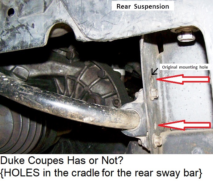

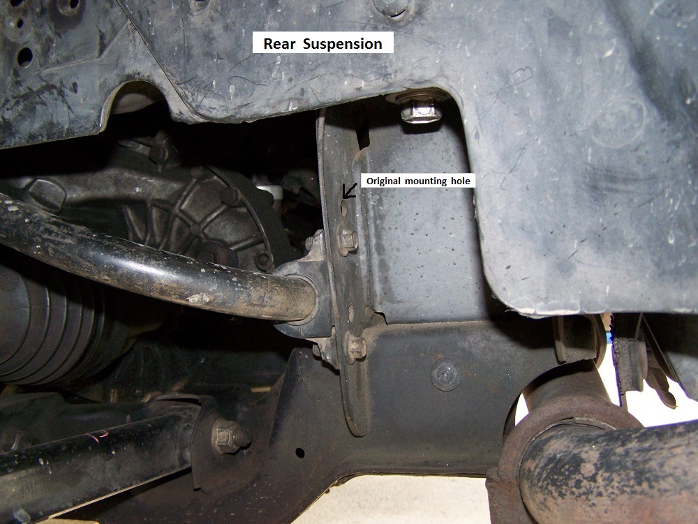

Here is a pic of where those holes should be located (Note; I modified (Lowered) mine to improve turn-in but eliminate Snap-oversteer)

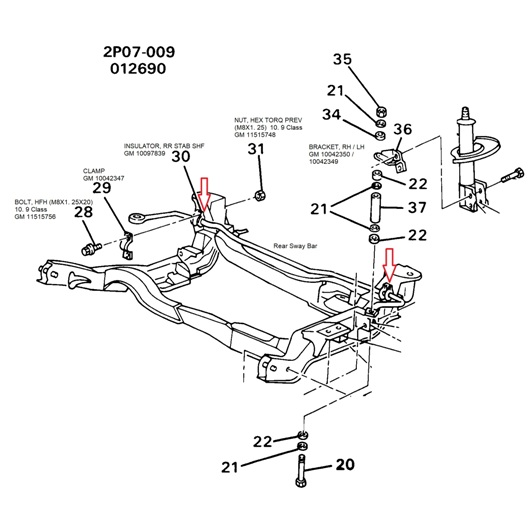

I believe the rear sway bar was an GM option plug-and-play "option"; as all '88 frame cradles are the same meaning, no drilling.....

SO LS4FieroGuy; the rear sway bar on a '88 is a 'plug-and-play' "option" {not a GM option} without drilling.
Get the bar, cradle hardware and the brackets like the eBay listing - https://www.ebay.com/itm/167271057013?
Get standard End Links or Zero Lash End Links - https://rodneydickman.com/p...o.php?products_id=97
Since you will disassemble at the struts to add the brackets; I suggest getting Camber Adjustment Bolts, I brought TRW 13209A - https://www.ebay.com/itm/183354731856[This message has been edited by Vintage-Nut (edited 02-14-2025).]

| quote | Originally posted by Vintage-Nut: as all '88 frame cradles are the same meaning, no drilling.....
While every 88 rear cradle has the holes for the rear sway bar, all 88 cradles are not the same.
There are 2 styles of 88 rear cradles: 1. Used on all manuals and V6 autos. 2. Used on the 4cyl autos - these have an extra transmission mount bracket welded to the cradle for the mono-transmission mount setup.
