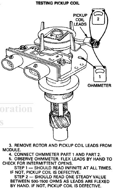

Had a friend with exact same problem. Engine would just "shut off" after 10 minutes. Would start and run fine at next "cold start".
Problem turned out to be the pickup coil in distributor. Test it with a multi-meter the next time engine shuts off. It's a $10 part.

Step 1 Result: Infinity from distributor housing ground or chassis ground, both pins from the pickup coil Step 2 Result: 880Ohms consistent

| quote | fierosound: Problem turned out to be the pickup coil in distributor. Test it with a multi-meter the next time engine shuts off. |
When you test the pickup coil; clean the connectors on both the coil and in the ICM.
Perhaps 'it' is a weak connection: No Pickup Coil Signal - No Injectors------------------ Original Owner of a Silver '88 GT Under 'Production Refurbishment' @ 136k Miles
