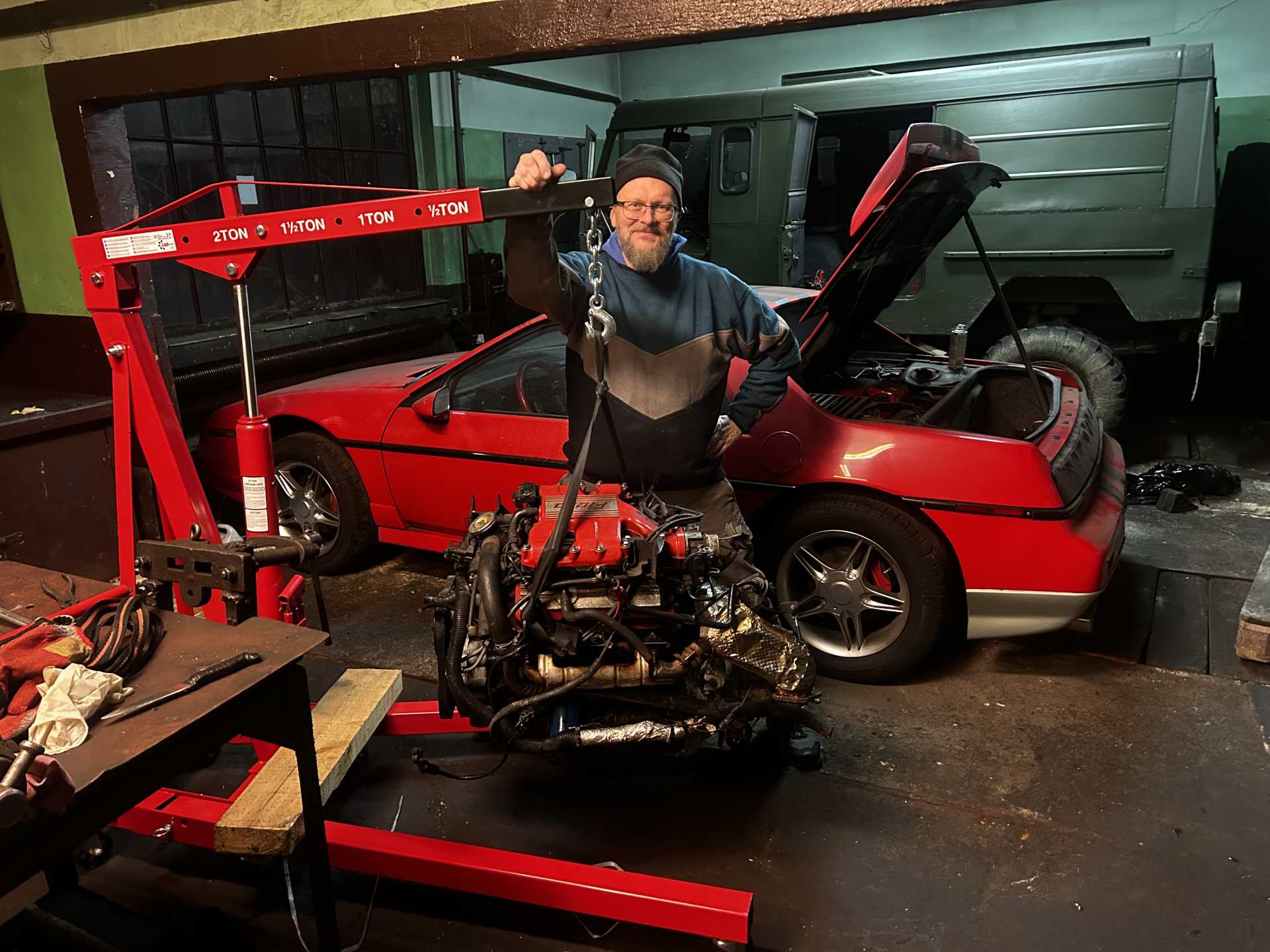

Hi,
As I mentioned in another post, I've got this '88 Formula with an auto trans that's seen better days. The engine had a blown head and block at one point, so I rebuilt it with a FieroStore performance kit and a CompCam. Threw in an MSD ignition too, just for kicks. Well, after about 6k miles, a hydraulic lifter popped, and after the repair, I could still hear the engine knocking.
Long story short, the motor's toast. It's been sitting in my garage collecting dust for almost a decade. I finally decided to bring it back to life. After eight months of searching, I found a donor engine from an '88 GT. But it's got a manual trans.
Originally, I was just going to swap over all my stuff from my old engine to the new one – new gaskets, hoses, rebuilt injectors, the whole nine yards. But now I'm really tempted to switch to a manual. I've managed to find a lot of the parts I need: shift linkage, hydraulic line, clutch master cylinder, used pedals, and the slave cylinder comes with the transmission. I'm just missing the shifter and the floor assembly.
I'm not sure if I'm forgetting anything. If you guys see anything I'm missing, let me know. Maybe this whole thing is a dumb idea? I could just stick with the auto and do what I originally planned.
Any advice would be appreciated. Remember, parts for the Fiero are pretty hard to come by in Europe.

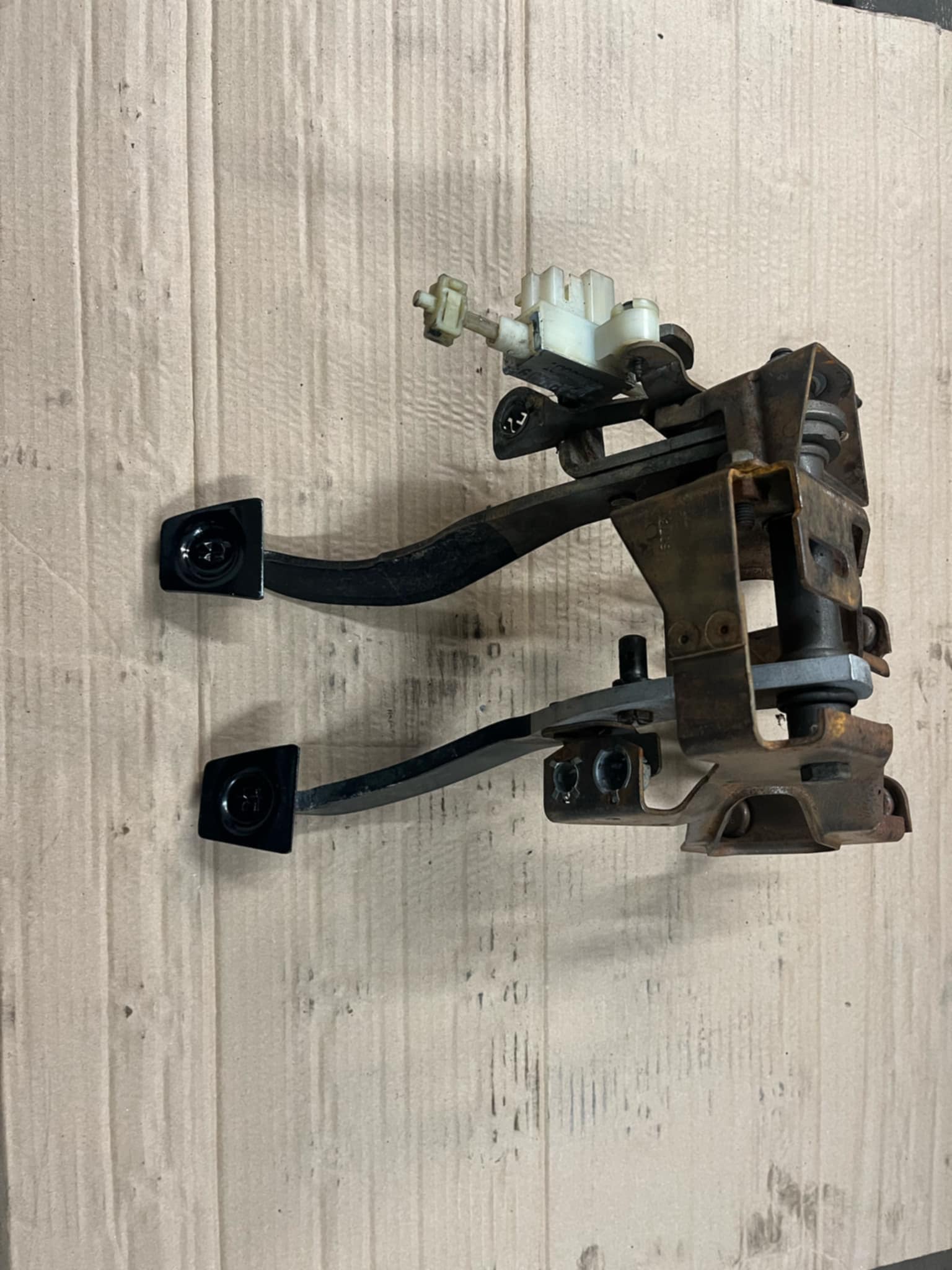

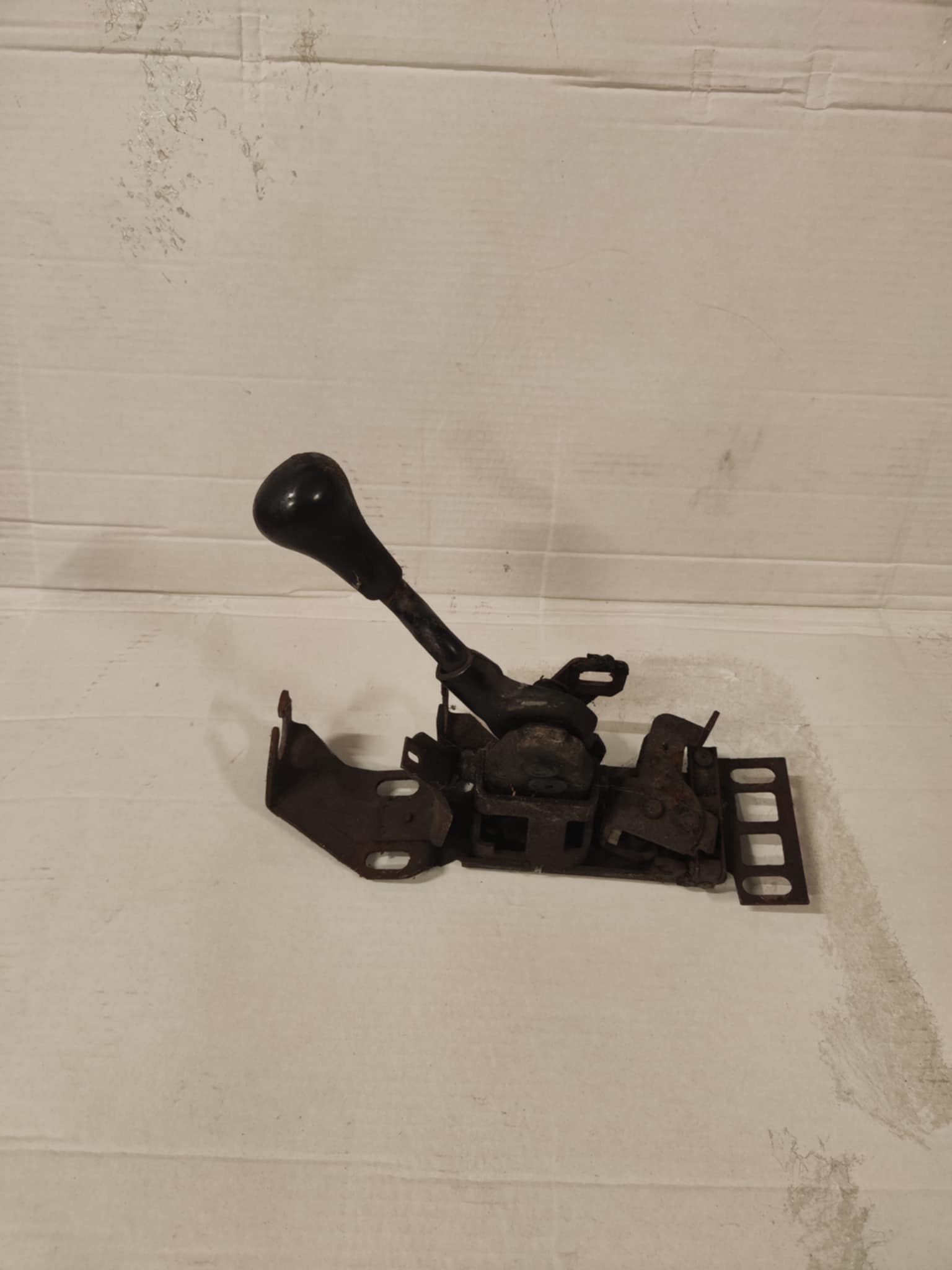

Hi, Can someone confirm that the following shifter and pedal assembly will fit a 5speed Getrag '88 transmission? I'm pretty sure about it, but I'd rather double-check. Supposedly, the parts are from an '85 GT. Damian
