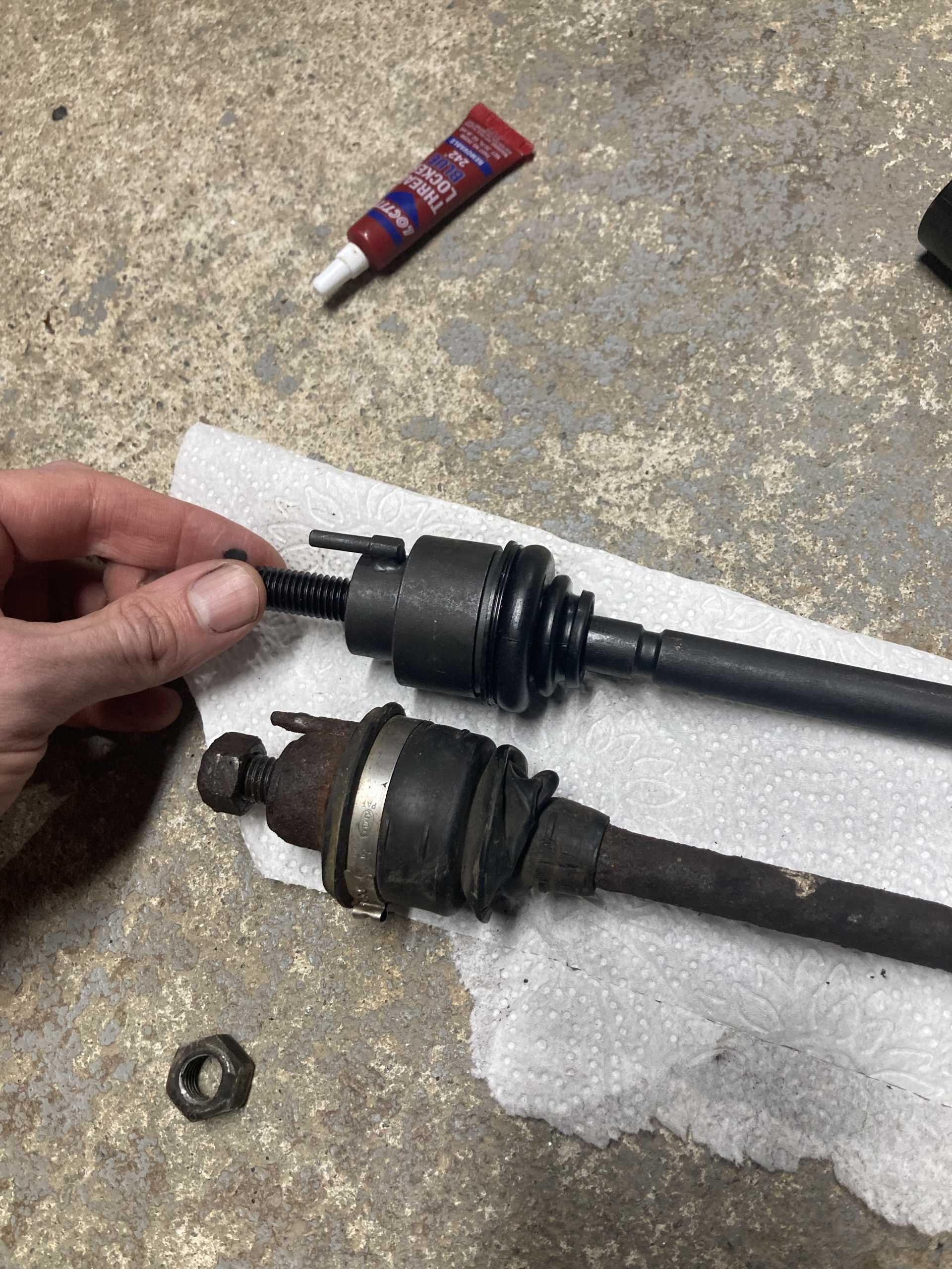

just got a replacement rear toe link rod (inner tie rod). the stud that mounts it to the cradle spins. i can spin it by hand as shown. is this supposed to spin?
doesnt seem right because how would i thread the nut on

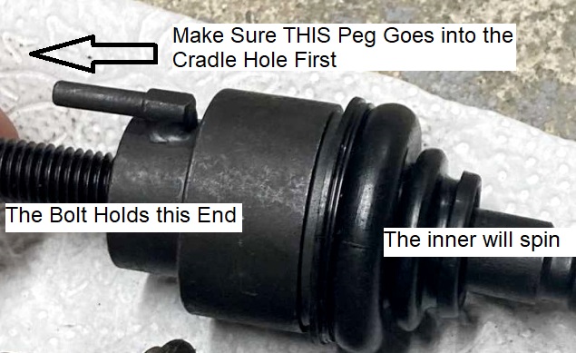

It needs to be on the cradle to tighten it down. That little metal rod above your finger goes in a hole on the mounting bracket that keeps the whole thing from spinning when attached to the cradle.

right, when i insert it into the cradle the tierod wont spin but the stud still will. it seems to me that the stud should not spin relative to the tierod.

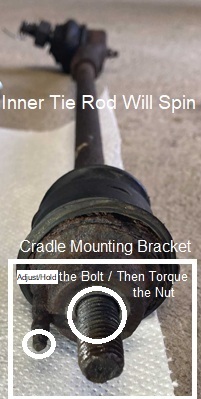

You have it backward....
The Peg into the cradle hole and the bolt HOLDS the joint as the inner tie spins....

ok im not sure what you mean by the inner tie spins? do you mean during installation or normal operation of the car?
i think i answered my own question though. i looked again this morning. the replacement tierod has a hex cutout inside the stud (or bolt as you call it in figure above) to hold it stationary when tightening the cradle attachment nut. the original tierod just had a solid immovable stud. my confusion was why the replacment tierod stud had a spinnable stud and i didnt see any provision for holding it stationary last night.

When everything is bolted down on the car, the rod should be able to spin, as the ball joints that make up the two ends can bend but also spin.

thanks for the pics and explanation. i ended up salvaging another junkyard inner rod that i had lying around that had a rust welded nut. its the same design as original. im going to see if i can return the new one i just bought. [This message has been edited by gregr75 (edited 01-05-2025).]

If you look at you pic of the 2 rods the new one has a hex for an allen key to hold it as you torque the retaining nut. sleek
sleek fiero
JAN 05, 06:51 PM
sorry I messed the last post up. Just above the pic you can see what I said. there is a hex in the end of the stud to hold it as it is tightened
