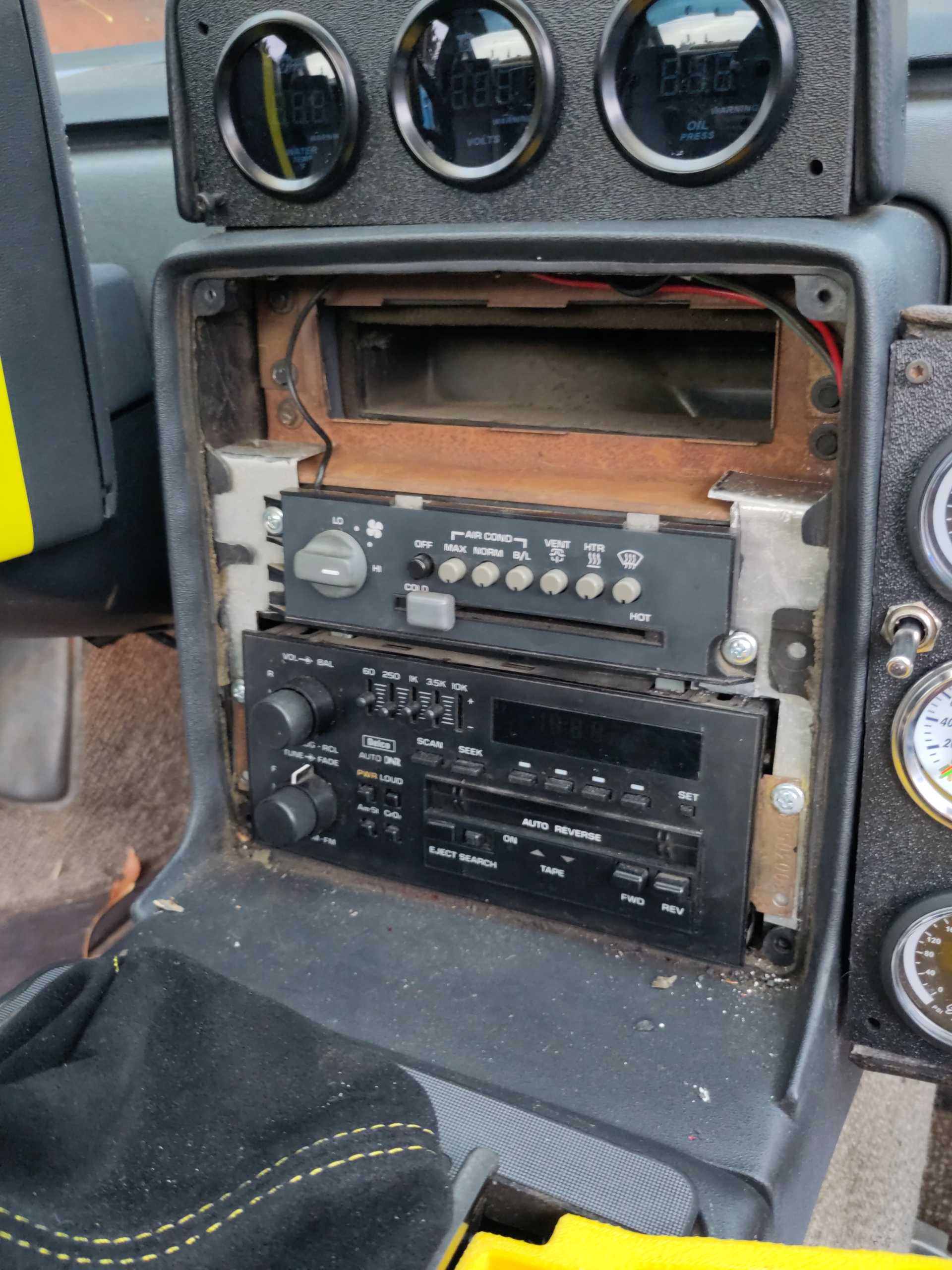

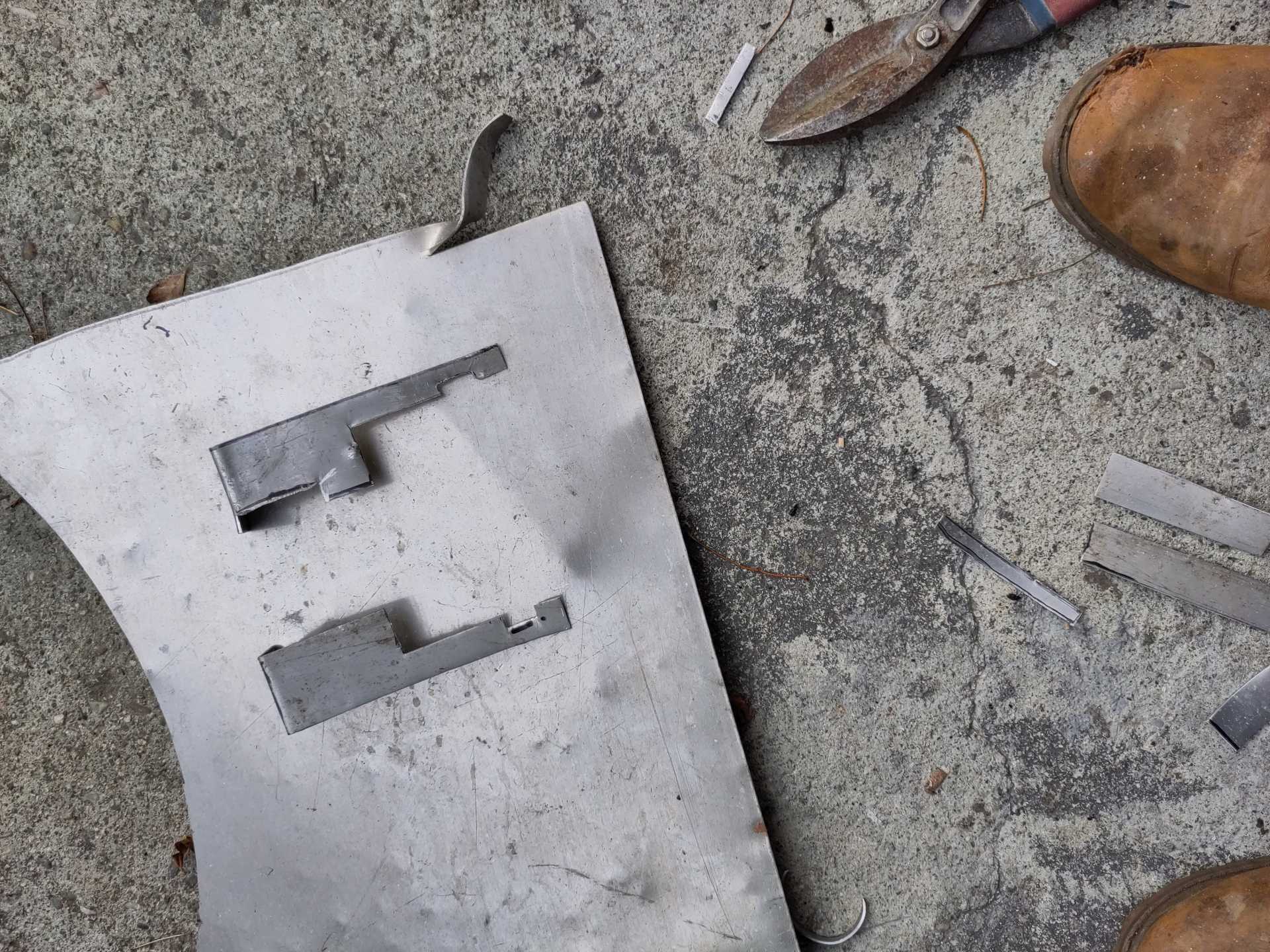

Or center console repair, or loose hvac unit fix, I dunno. Any who my mounting tabs for the hvac and radio fell off and theres a whole lotta nothing there to mount stuff too. Grabbed a sheet o alum and made some shemmy shem shims and they look like this down hyah
 Held errthing in w self tapping screws, they slide in between some tabs n whats left of the frame
 Once the hvac n radio are screwed in, the whole things tight. Feliz navidad!

Those are very nice, too nice for my beater lol. Im more of a mad max kinda guy, boogers n duct tape all the way. Whatevers laying around I can repurpose quickly saving a trip to the store.
