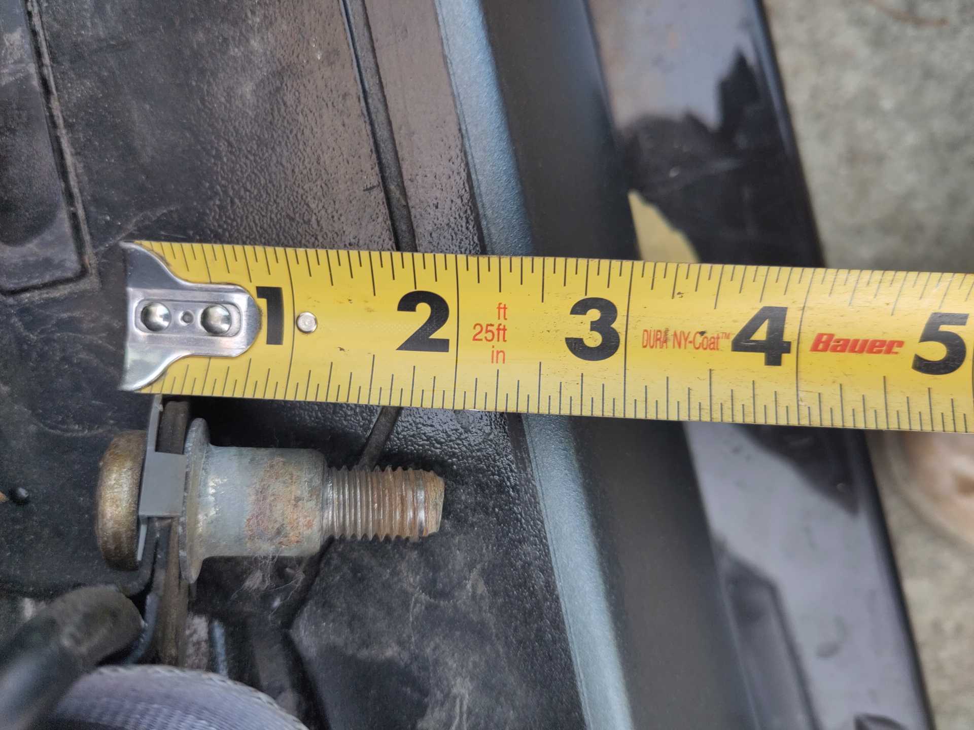

Cant get to the lower bolts wo pulling a seat, thats next weekend if you can wait. I did pull one of the top ones and take a pic for you

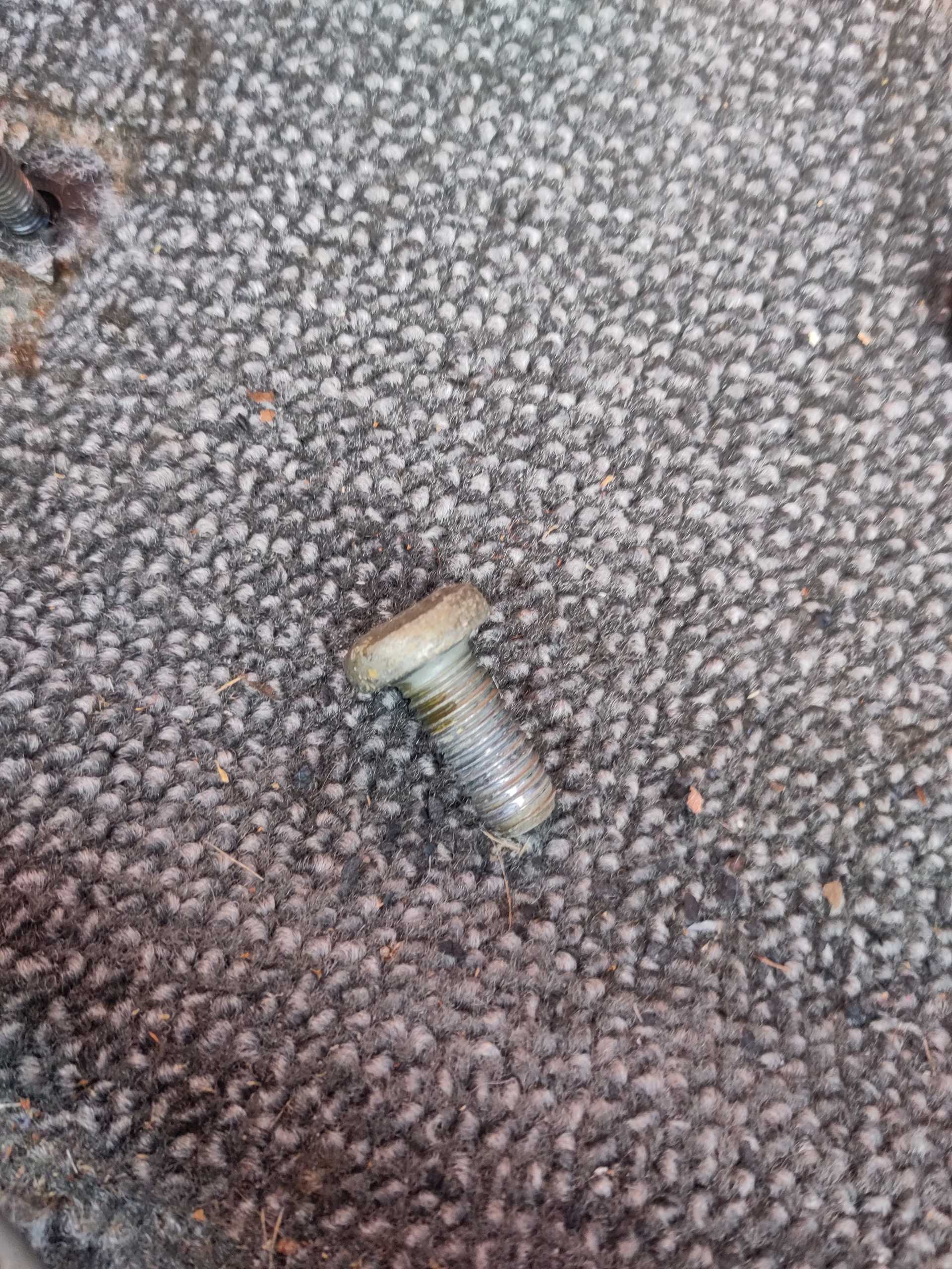

The shortest one holds the retractor box to the wall

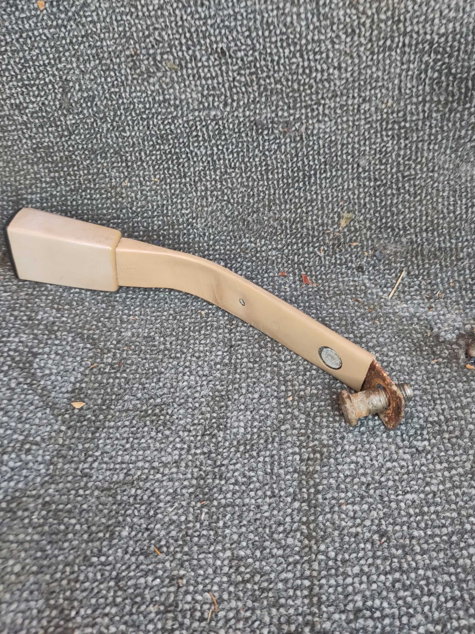

 Buckle

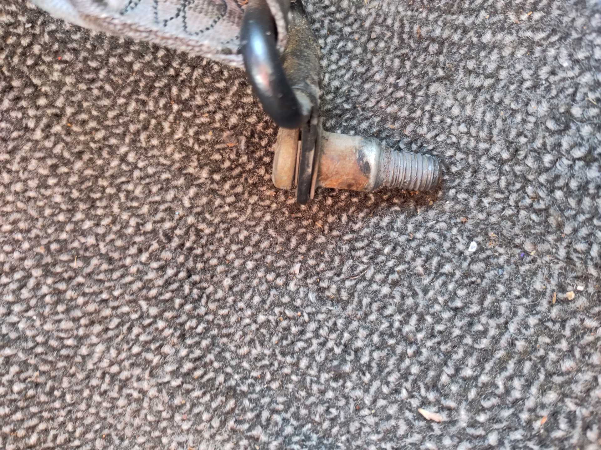

 Top one

JAN 02, 09:30 PM
Thanks Shemm, this is perfect! I very much appreciate you taking these pictures!!!
