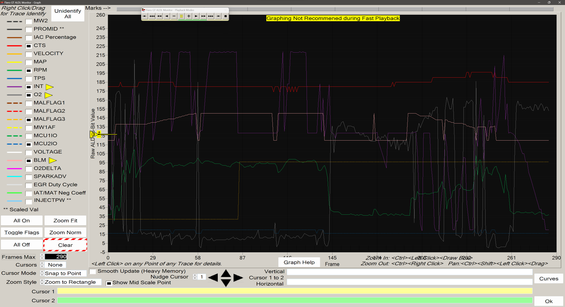

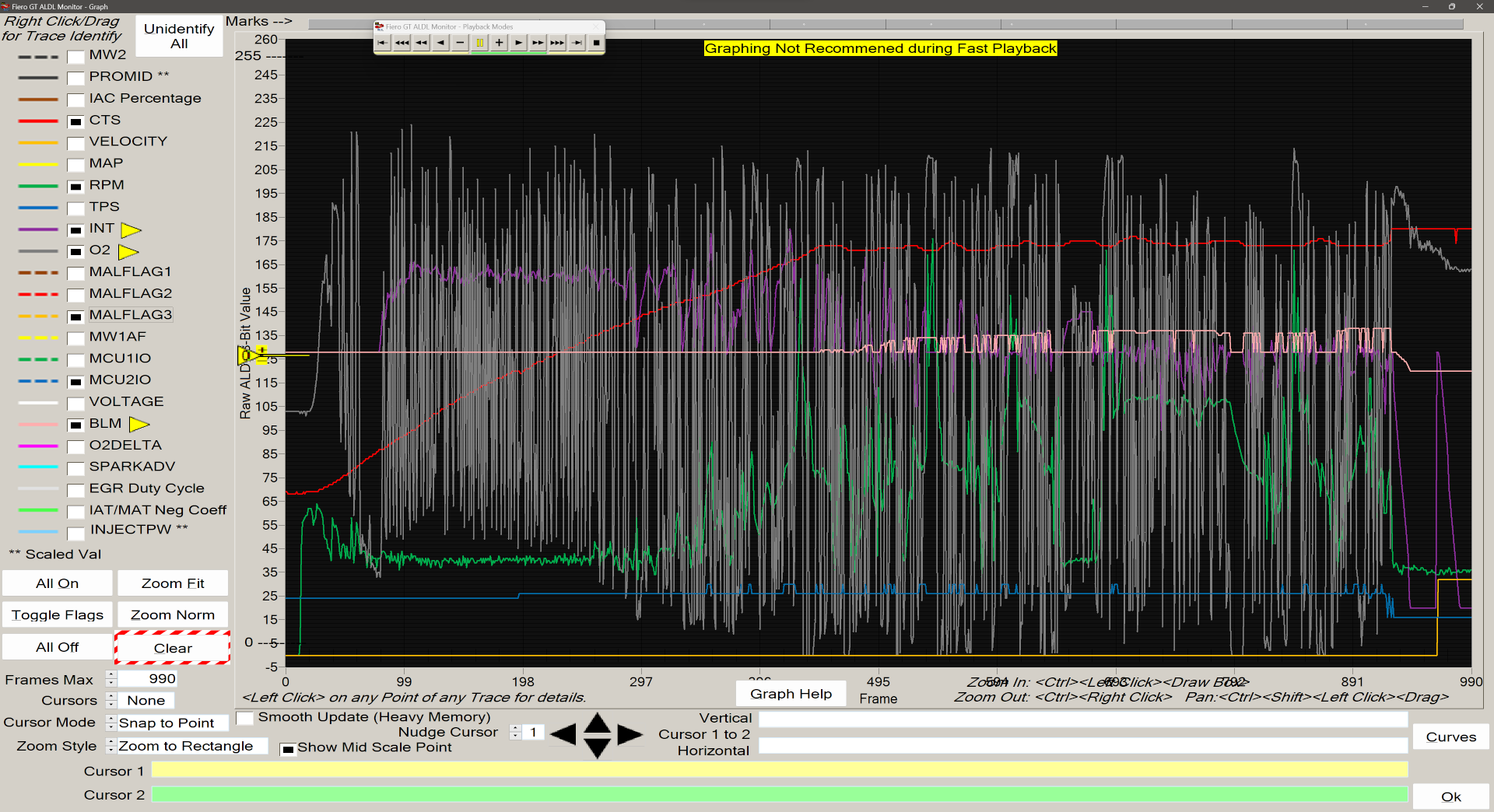

One day I took the car on the highway and drive it for longer than usual, the car started to loose power and throws a rich O2 code. Luckily I had my ALDL adapter plugged in and recording, so I can share what happened. Here is the graph of that run, I've been recording for 26 minutes so it's a bit squished.
After this happened I restarted the car and crawled to the closest rest area. The car apparently figured out it was very lean, so it gave the O2 lean code and runs badly. This is the graph of that second, shorter run.

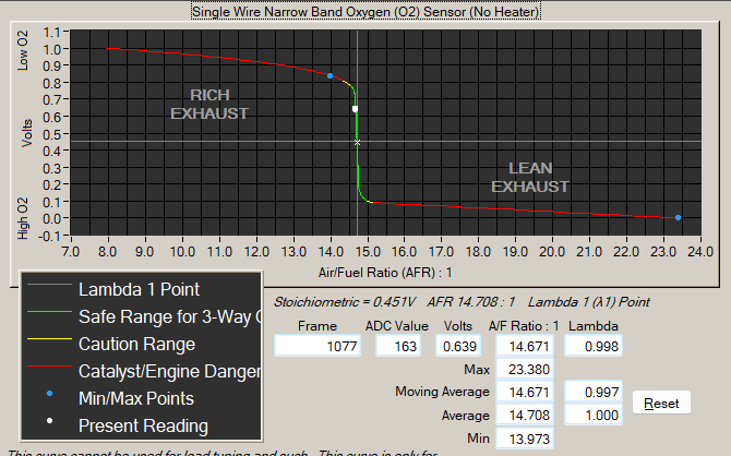

Once the engine is warmed the ECM will go into closed loop. The Oxygen sensor output will now vary quickly from lean to rich and back except at WOT. This is normal operating as it is seeing the fueling adjustments as you drive. Some but not all scan tools will provide an average O2 sensor reading and that can provide the true operating parameters, Most OBD2 scanners provide this but many even top end OBD1 scanners do not. ------------------ " THE BLACK PARALYZER" -87GT 3800SC Series III engine, custom ZZP /Frozen Boost Intercooler setup, 3.4" Pulley, Northstar TB, LS1 MAF, 3" Spintech/Hedman Exhaust, P-log Manifold, Autolite 104's, MSD wires, Custom CAI, 4T65eHD w. custom axles, Champion Radiator, S10 Brake Booster, HP Tuners VCM Suite. "THE COLUSSUS" 87GT - ALL OUT 3.4L Turbocharged engine, Garrett Hybrid Turbo, MSD ign., modified TH125H " ON THE LOOSE WITHOUT THE JUICE "
Hello Dennis, thank you for your input. The GUI I'm using has such feature, it's very complete actually.
As you said, the ECM seems to operate correctly, for most of the time. The O2 seems to average slightly on the lean side and you can see the ECM trying to compensate for it with the BLM (long term) and INT (short term) values. At one point tho, the car lost all power and I looked to my laptop to see that the O2 is not going up and down anymore. That can be seen at the very end of the first graph I shared. For some reason, out of the blue, the engine started running rich or better, the O2 sensor started measuring rich.
I'm trying to figure out why it's running lean in the average, and also why at some point it goes nuts. From the graph I shared above you'd say it's not averaging lean, but that average includes the last bit of very rich reading that is misleading.
