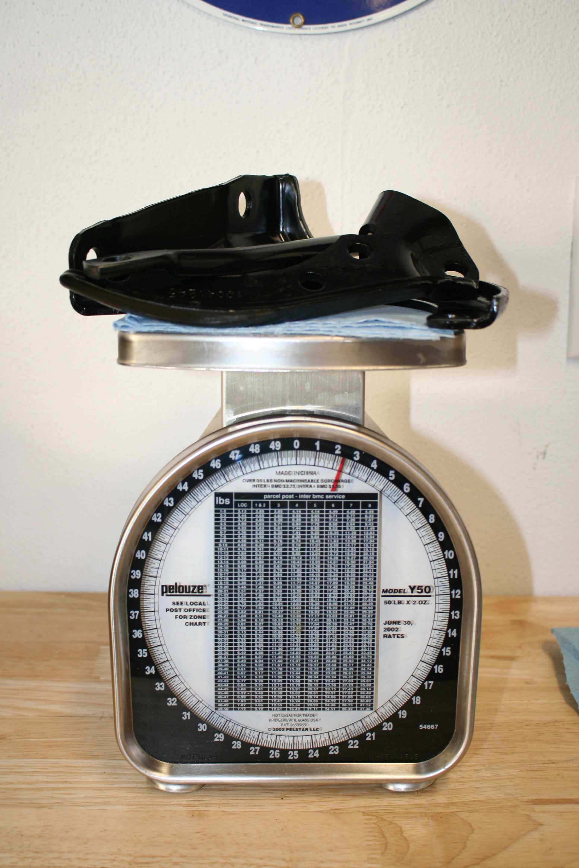

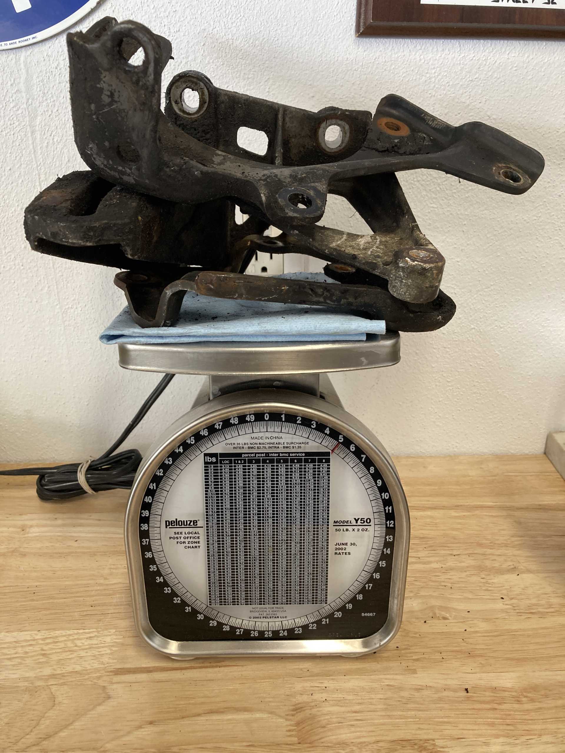

The 1984-1986 Fieros utilized a SEPARATE V-belt for the A/C compressor, in addition to the V-belt that powered the water-pump and alternator (off the crank). So if you decide to stick with the V-belt, you'll need to get an 84-86 set of A/C brackets (Which I have, and will give you for free). In that configuration, the A/C compressor is adjustable, meaning that you move the compressor in order to tighten the V-belt. There are THREE brackets that weigh in over 5 pounds, compared to the 87+ which is only 2.5 pounds.

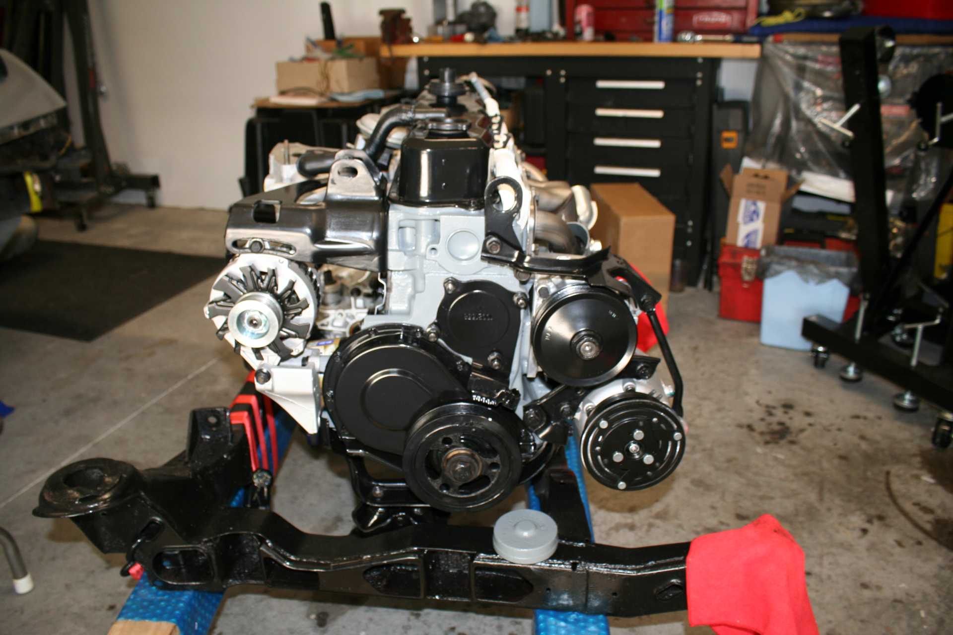

84-86
87-88

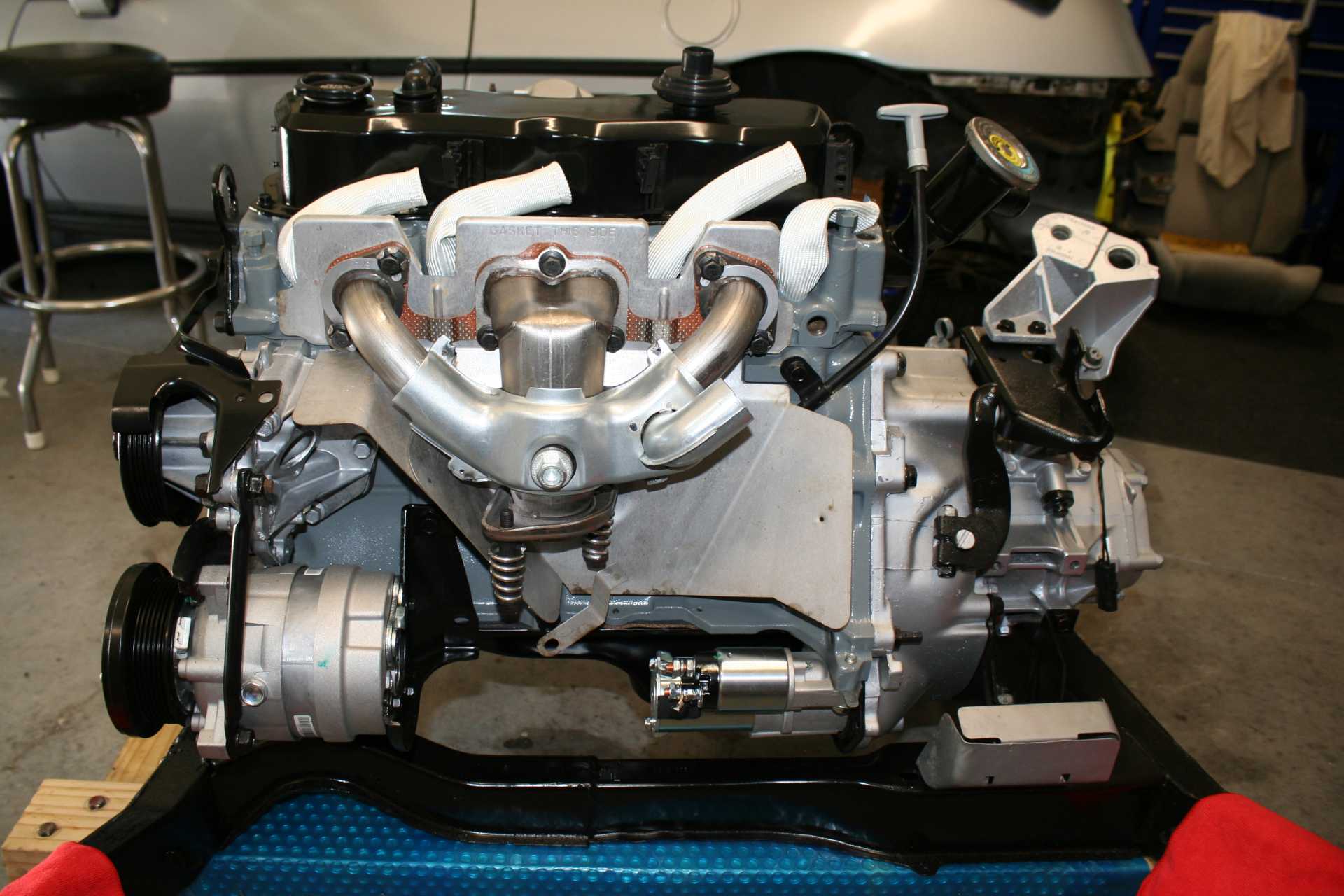

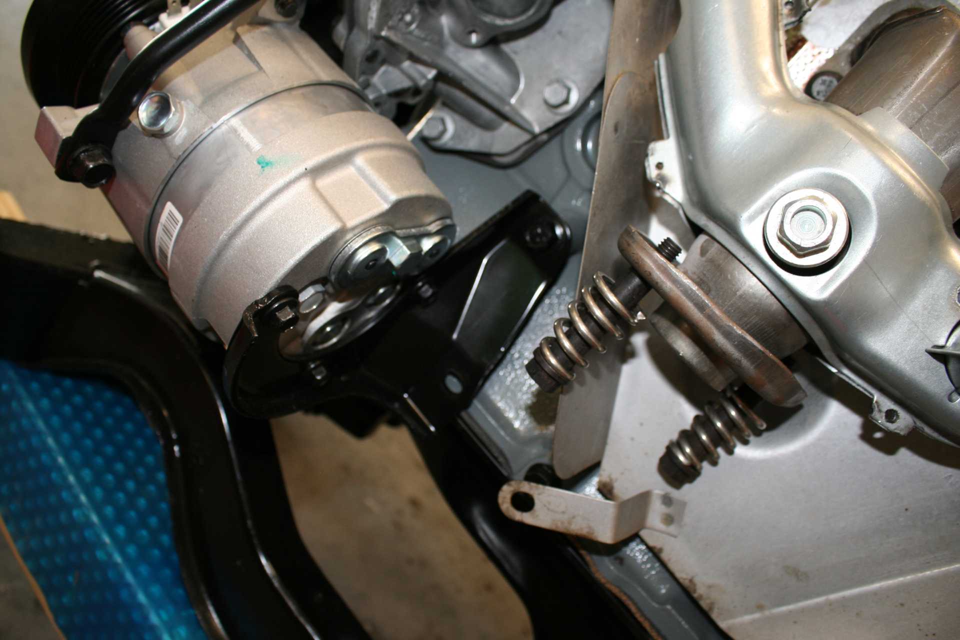

On the 1987-1988 Fieros (which you've asked about), the A/C compressor is fixed. There's a top bracket, which also attaches to the water pump, a rear bracket (which has three 10mm screws) and two that affix it to the block), and then a SINGLE bar that attaches the side and goes all the way up to the water pump.

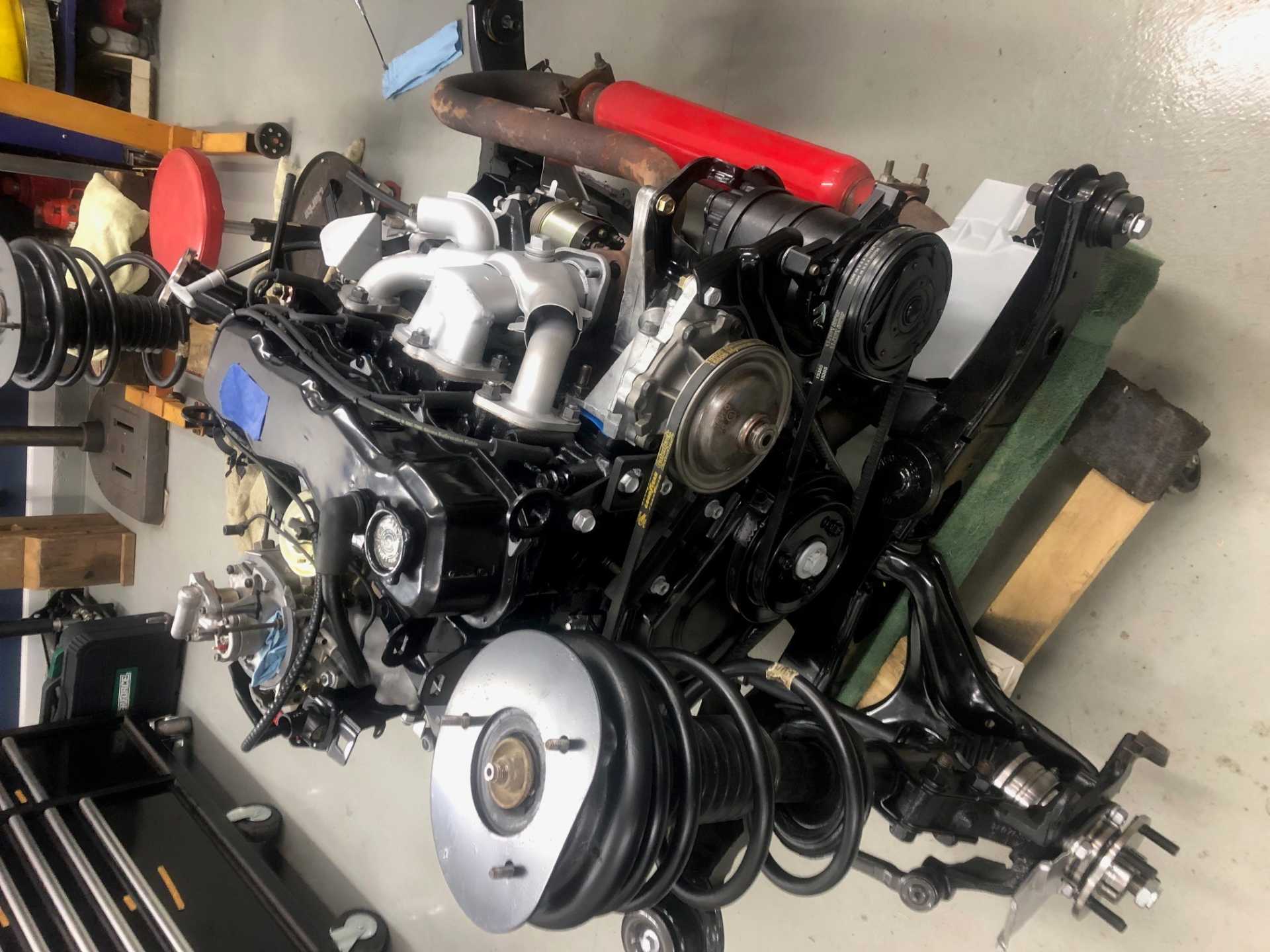

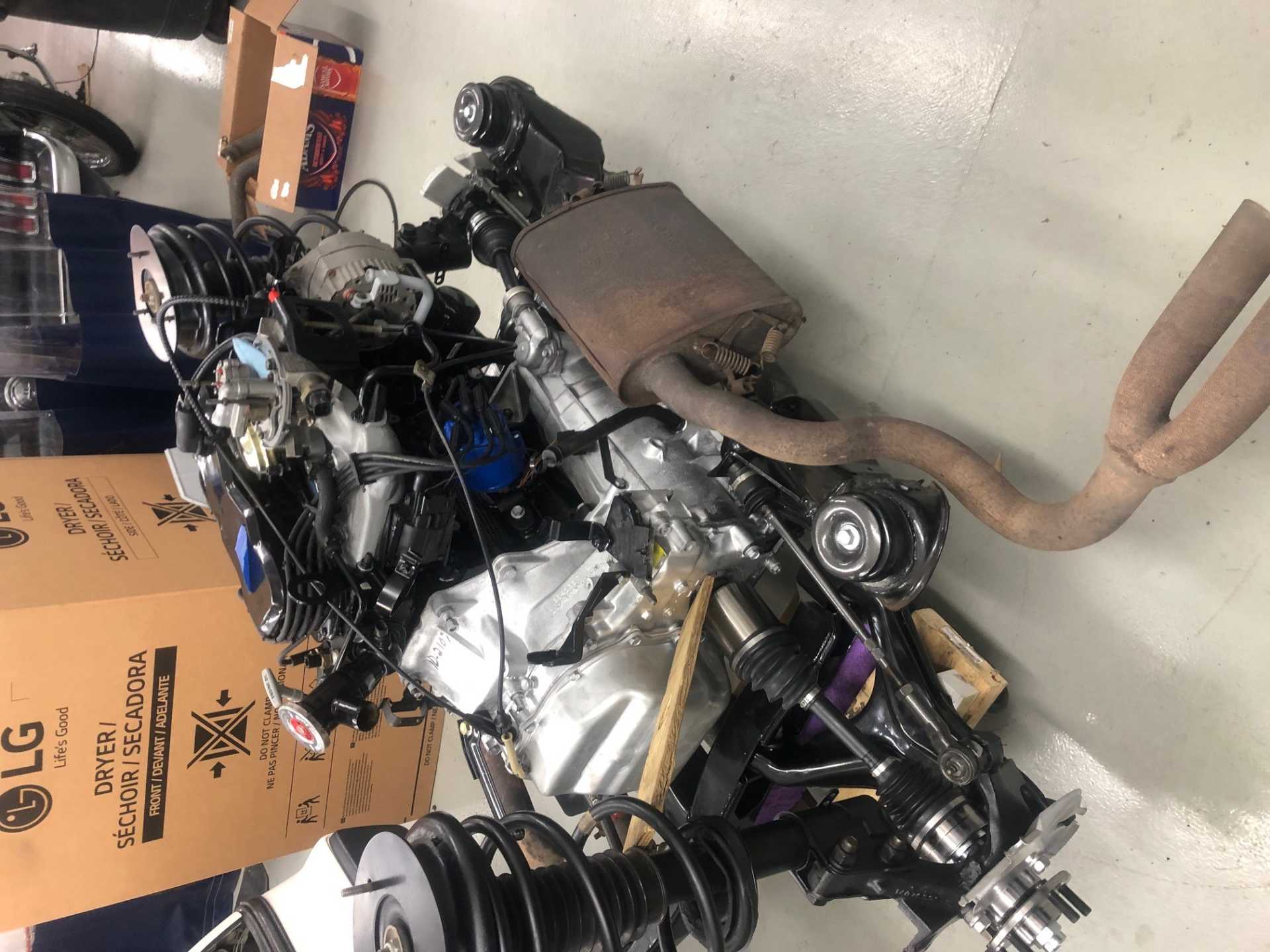

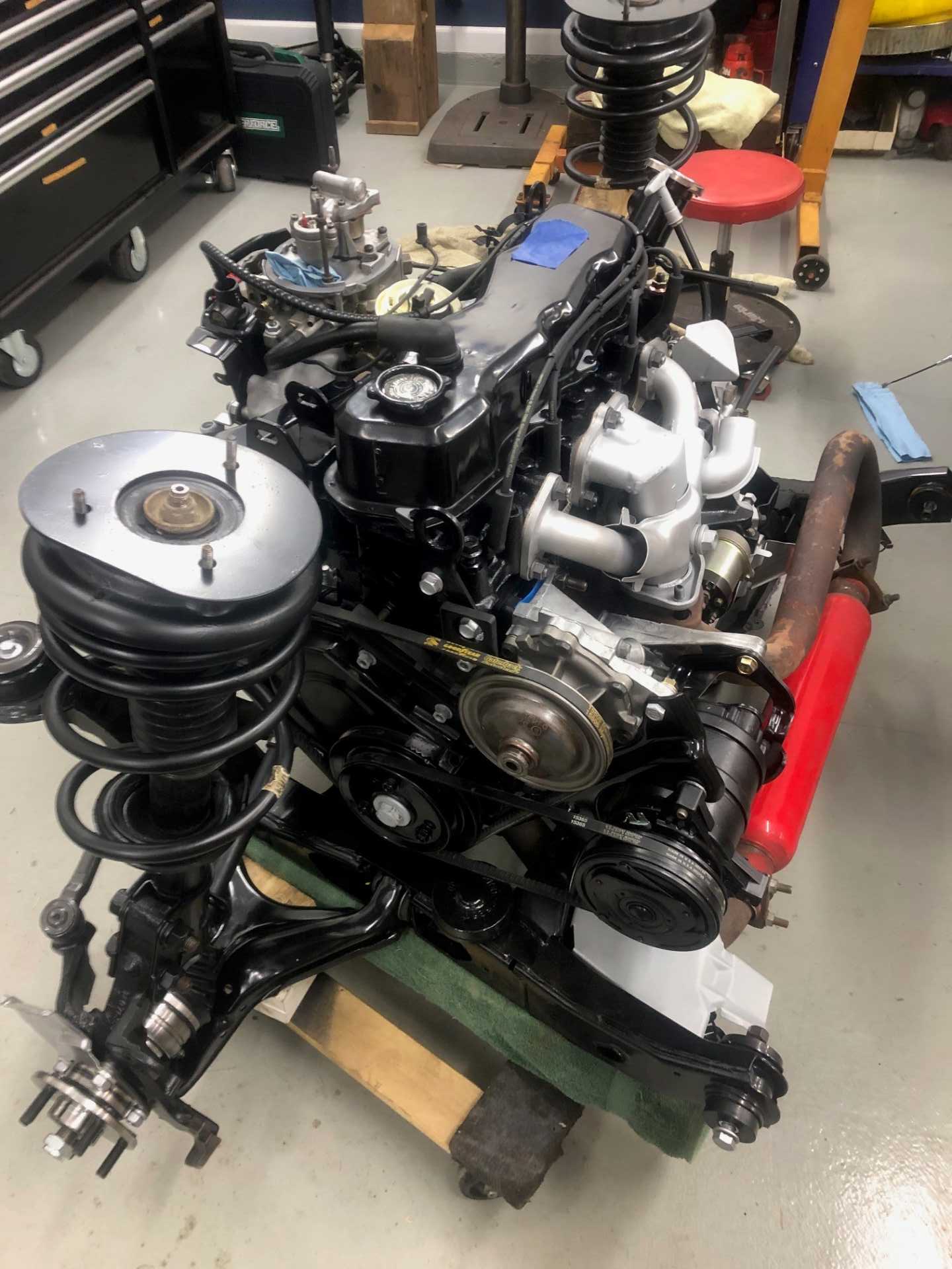

Here are some pictures of my daughter's 1985 motor, that we converted to serpentine system (we use the alternator as a tensioner). This is an 85, but it has all the brackets you will need... you'll have a belt tensioner, so your upper alternator bracket will look different. Everything else will be the same.

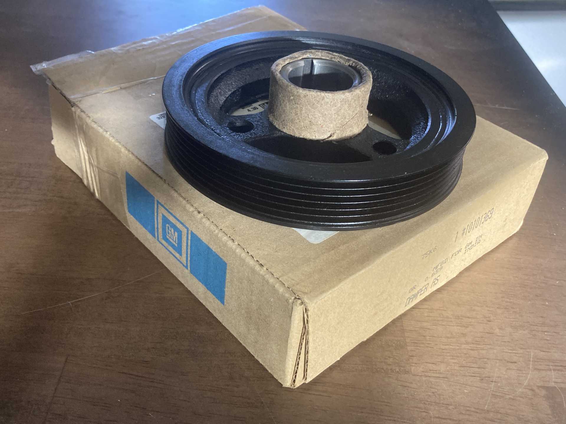

Note, I have a harmonic balancer installed. These never came with Fieros, but if you can find one, it'll solve two problems for you. Better engine balance, and also give you back the serpentine pulley. Part number is on the box. They are basically impossible to find.
