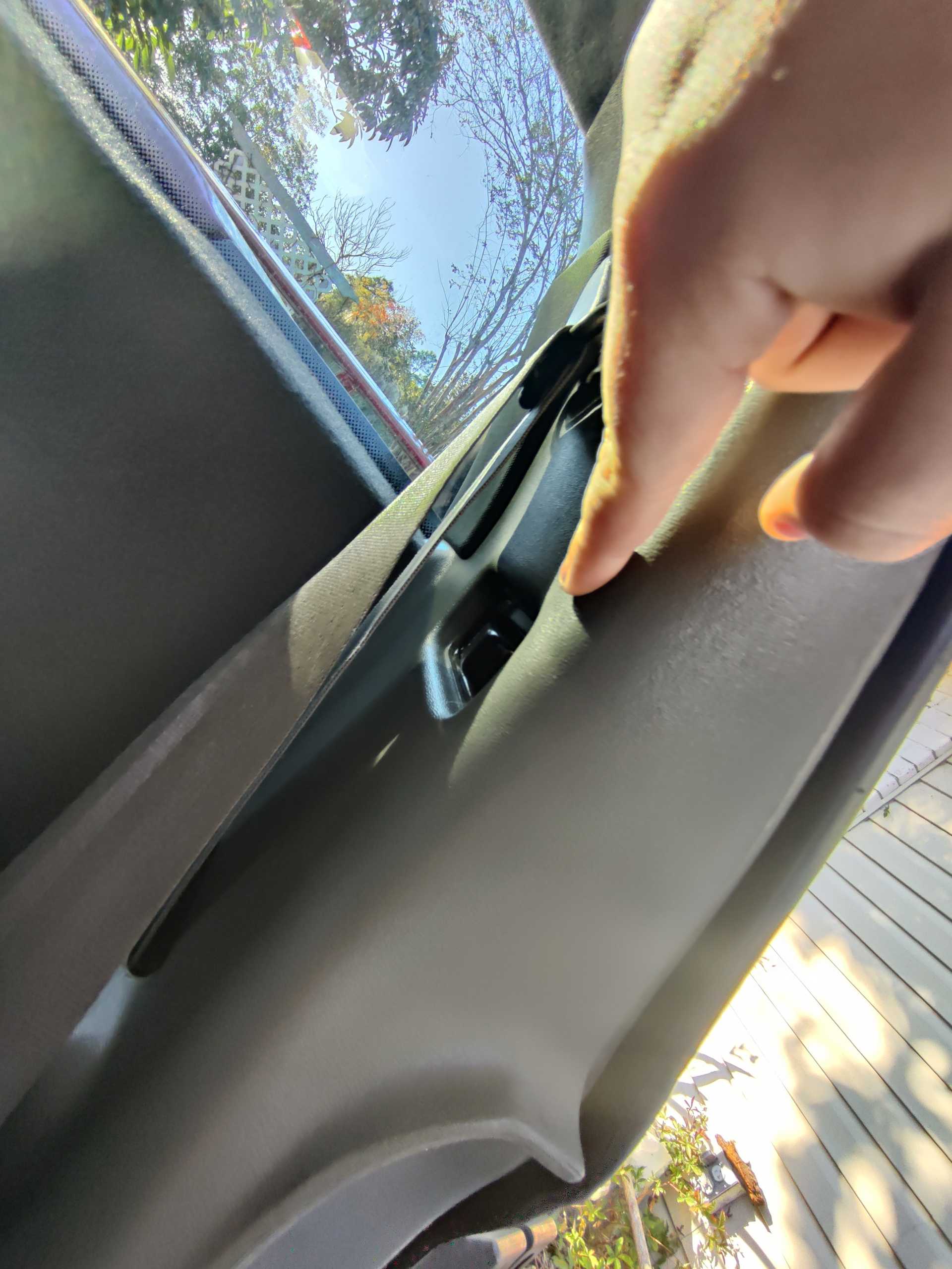

I stated in one of my previous posts my fuel door will no longer open when I pull on the lever inside I was wondering if anyone knows how to remove the inner body panel to get access to the levers mechanism

1. The seat belt where it's bolt to the pillar needs to come off. 2. There is one screw on he inside of the door frame that needs to come out. 3. The bottom kick panel needs to come off as it lays over the top of this panel. 4. There are also more screws to be removed on the bottom, you will see what I am talking about when doing it. 5. Un bottom the emergency brake boot as it will slide over the top of the handle when removing the panel. I can't remember if thst needs done or not but doesn't hurt.
Don't...I repeat don't remove the speaker cover. It comes out with the panel.
Fairy straight forward.
