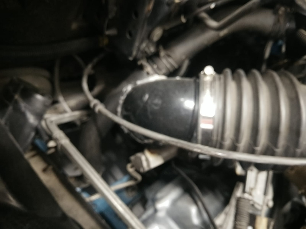

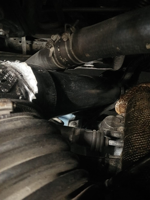

i also have an 84. i used a 3" plastic elbow - like used for drain pipes, and with some tape to take up the slop in the fit, it went into the rubber of the 3800 intake. This was attached to a piece of 3" pipe down to below the engine and i put on a cone filter there to pick up the relatively cool air below the engine.
 Showing the elbow into the rubber of the 3800
Showing the clearance with the coolant rubber line as well as the clutch slave cylinder.
