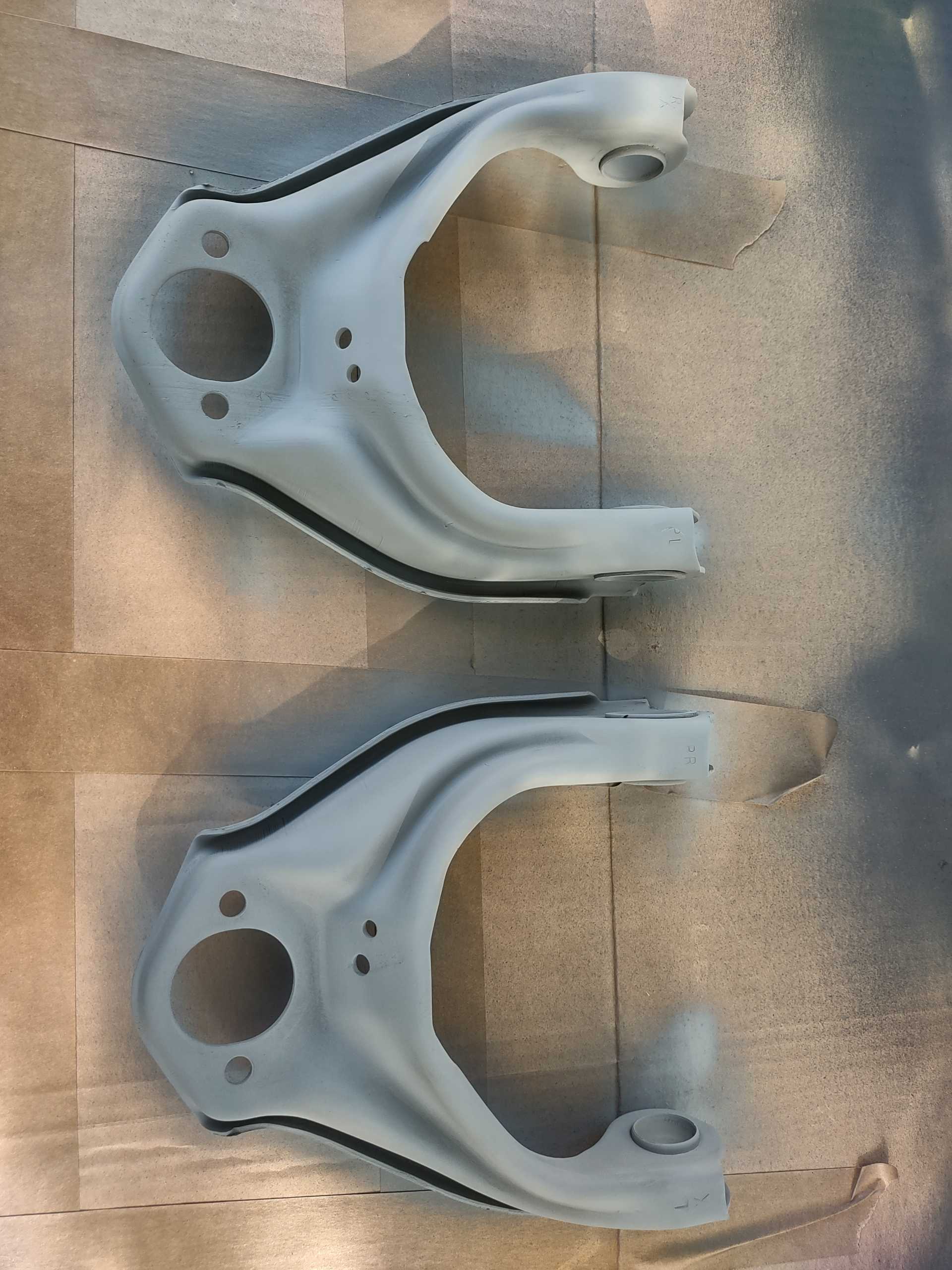

Can you recognize which of these go to which side of the car? Either by looking at them or their stamp markings?

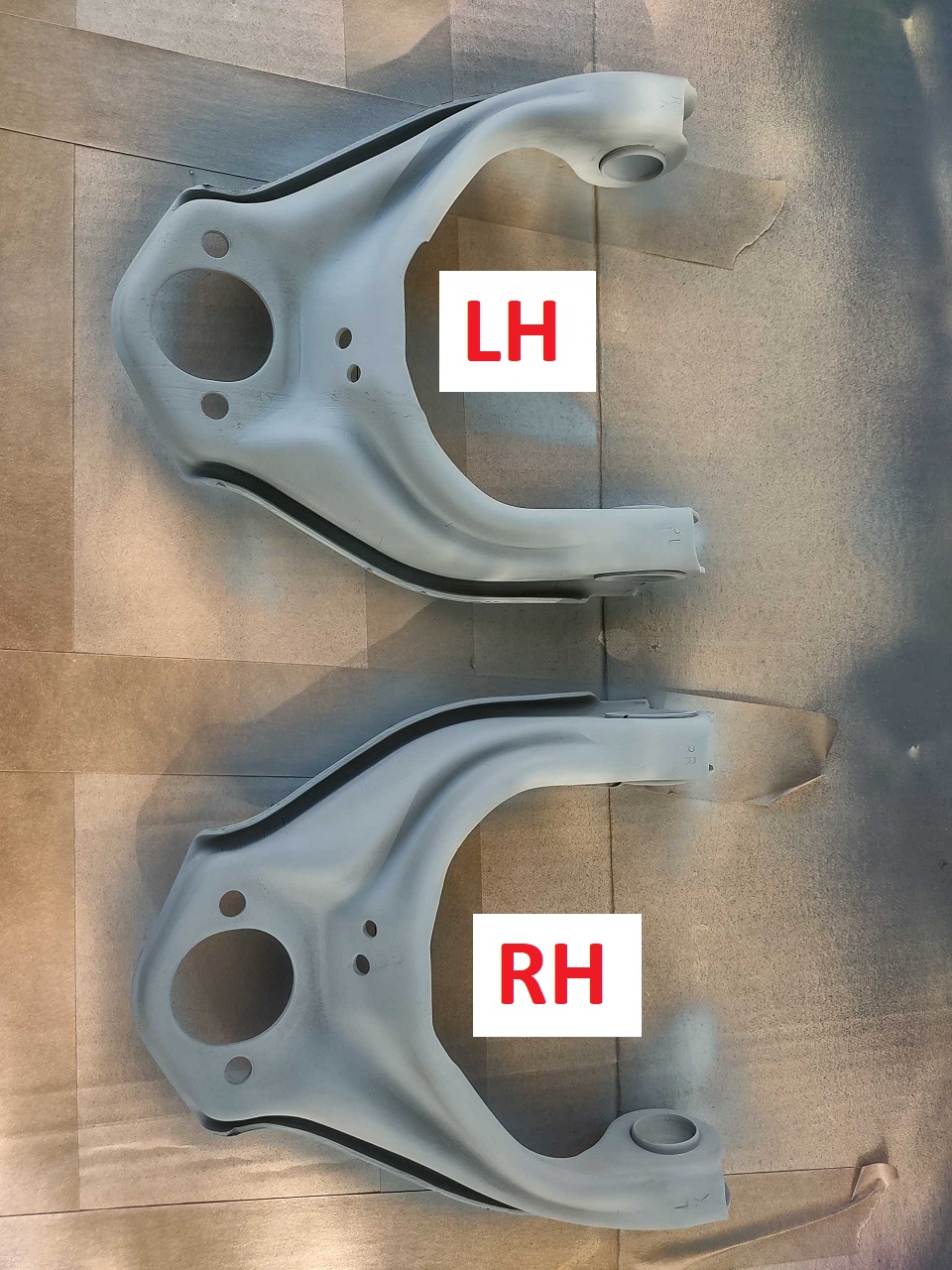

I believe in the first photo, the top one is the driver side and the one below is the passenger side. [This message has been edited by IMSA GT (edited 10-15-2024).]

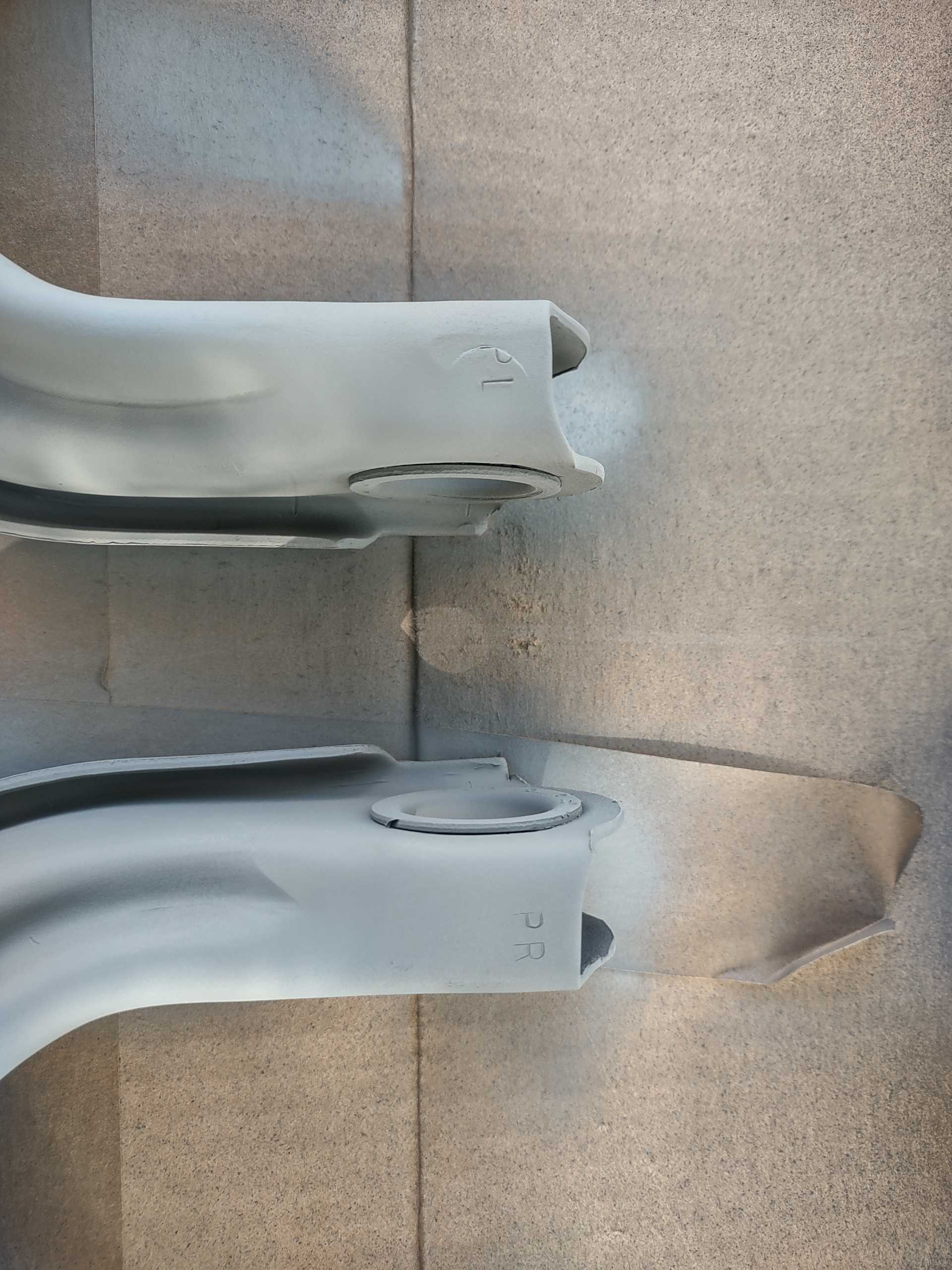

The arms on my 87 GT were stamped L and R. Look for those markings as they show in your pictures. That tells the story of where they belong.

I agree with both of the above. I took pictures of my passenger control arms when I was working on the RF suspension several months ago. The passenger is the only side I took out, so I know that's what's in the pictures. My RF upper control arm matches the bottom arm in your first photo.

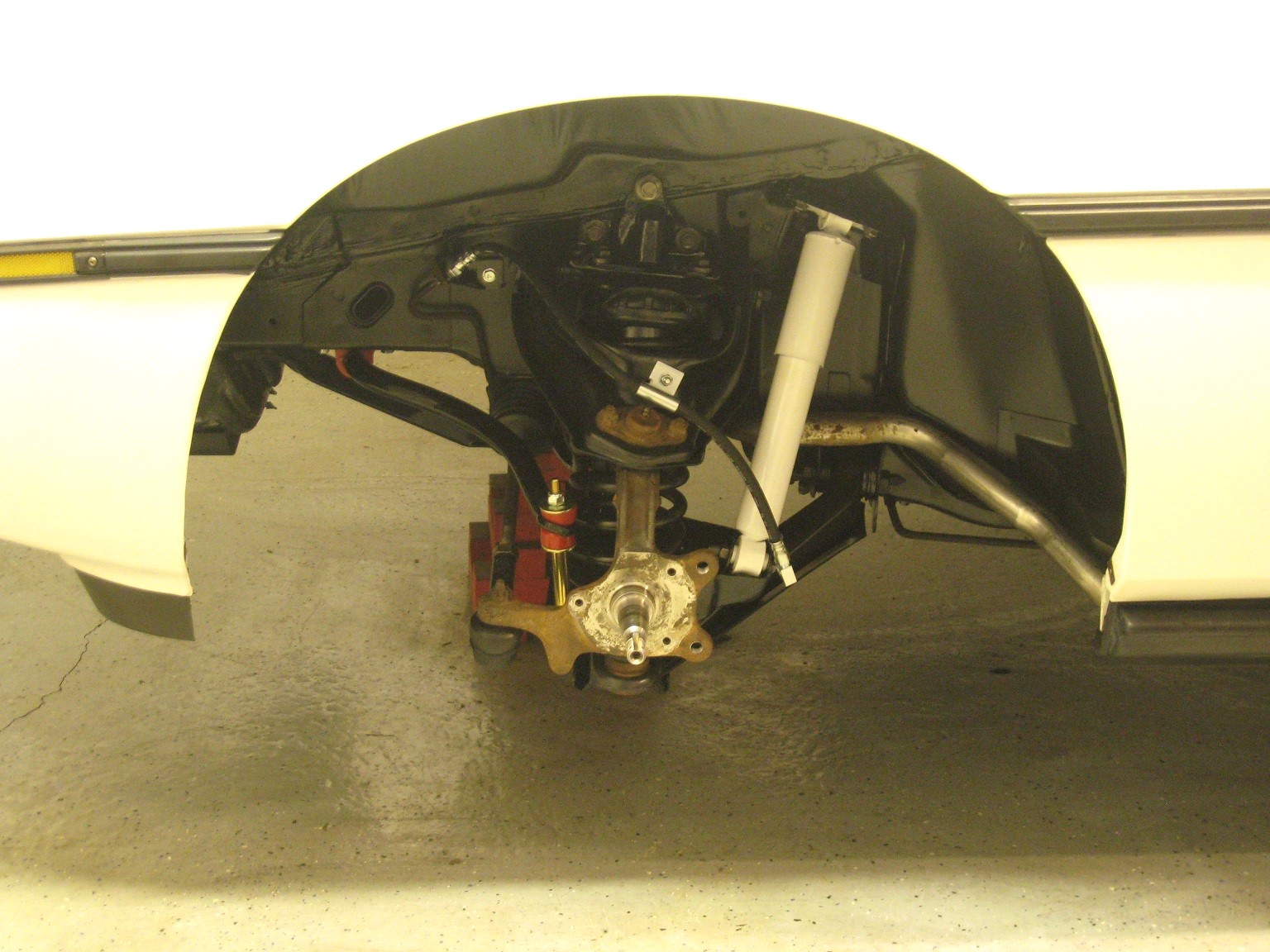

This is a photo of the left front suspension of my Fiero:
There are two holes where the brake hose attaches to the control arm; by looking at the holes, I was able to work out which arm was which.
