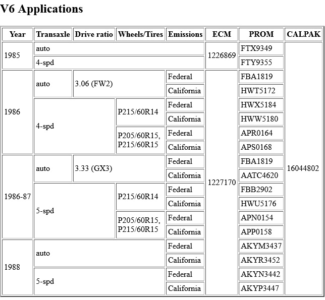

For MOST Fieros, the ECM is the same between manual and automatic for all years except 1985. The 1985 ECM is actually slightly more desireable as it has additional features such as support for a Knock Sensor and some other things. Otherwise, the ECM is the same across the board. The difference is only the PROM (and of course, the wiring harness).
Here's the V6 PROM / ECM Application Guide:
You'll also notice that the only difference between the proms are for Federal and California. Cars sold in Canada had the "Federal" programming.
