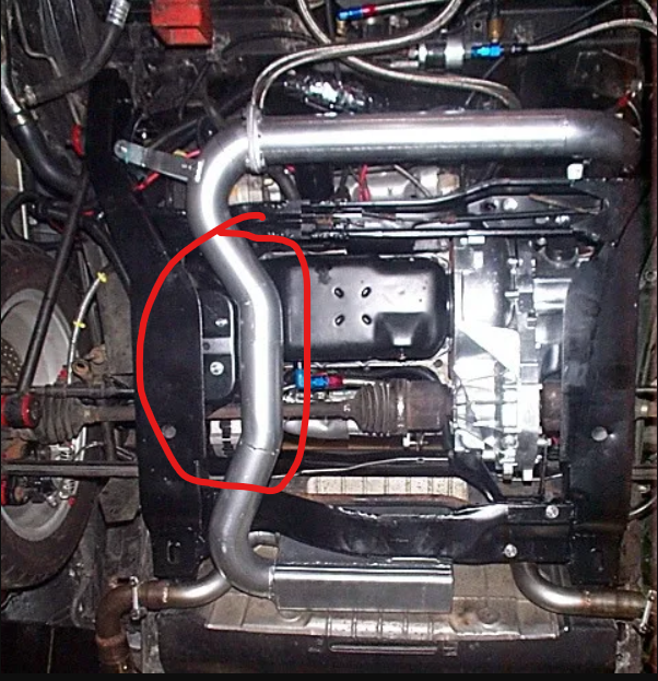

  I am planning to get my exhaust re-done soon.  My car has a Series III 3800 with the aluminum oil pan
  The exhaust runs the stock fiero route, using WCF headers
  The existing pipe running "around" the oil pan has basically no clearance and is mostly "below" the cradle, and has scraped on the road as a result.  I see that many people switch to the steel oil pans when installing Series III motors.  Is this because it gives you better clearance for the pipe?   I am hoping to be able to run the new exhaust at the same level or slightly higher than the cradle
  It is 3" pipe currently.  Maybe that is the issue?
  The photo above is NOT my car.   I have circled the problem area on mine, and this photo looks like a steel oil pan- hence my question
  On my car, I can't really fit the pipe between the pan and the cradle[This message has been edited by cam-a-lot (edited 09-14-2024).]

            I have an aluminum pan and 3" exhaust.  My front engine mount is attached to the top of the cradle and the original front mount bracket has been removed from the cradle.  It's a snug fit, but there is clearance and the pipe does not contact either the pan or the cradle.  The pipe is not lower than the cradle. [This message has been edited by 87GT3800SC5SPD (edited 09-14-2024).]

            When I did a 'WCF 3800 swap 3 inch exhaust' swap, he only way we could get the exhaust above the bottom of the cradle was to clearance a steel pan.  Do a search for   Rikker    His posts show all the mods we did.

            Hello, Your headers make the front pipe go under the car? I would try to modify them to make the front pipe/crossover go over the gearbox. As in most 3800 applications. I wouldn't want a heat source running close to my engine mount.
  Yes, the steel sump pan is probably a better shape if you have to pass exhausts in the stock position. And steel is slightly easier to work if you have to modify it.
