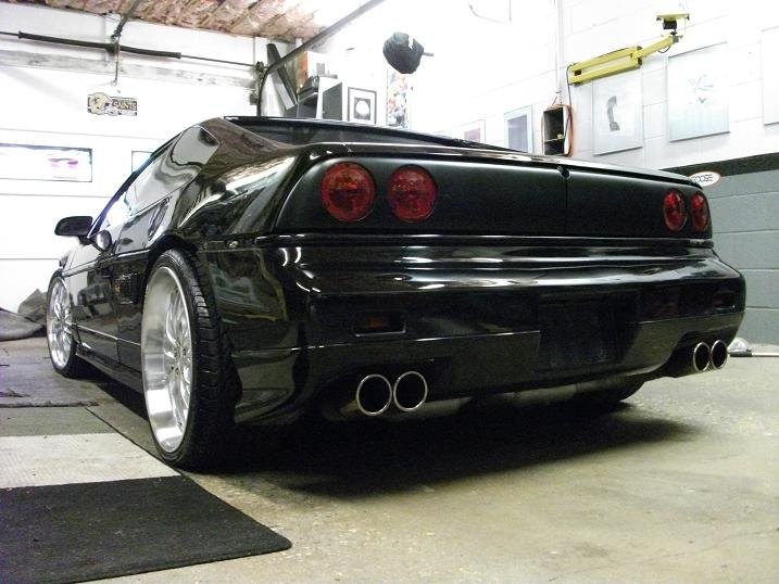

IMSA GT
AUG 23, 04:34 PM
To give you an idea of fittment, this is Nosaints car. He runs 19x9.5 in the rear with coilovers so you can see he is at the limit of the fender.
