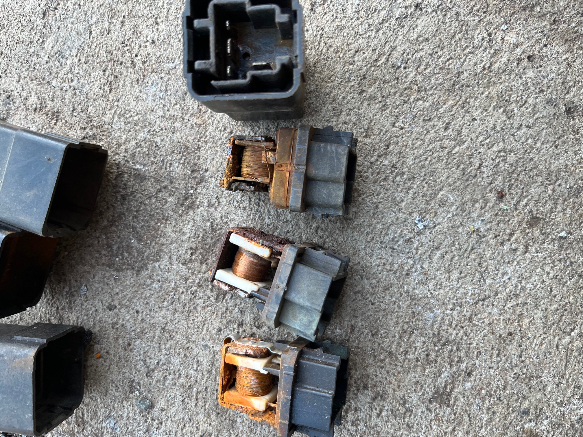

pull the connector from the FP relay, look at both the relay and connector for corrosion, if that is all good, pry the cover off the FP relay, it will be very apparent then if the relay is good or not . If the relay looks good, check the wiring right at the connector.
 a few bad relays, once you pull the cover off[This message has been edited by jelly2m8 (edited 08-18-2024).]
