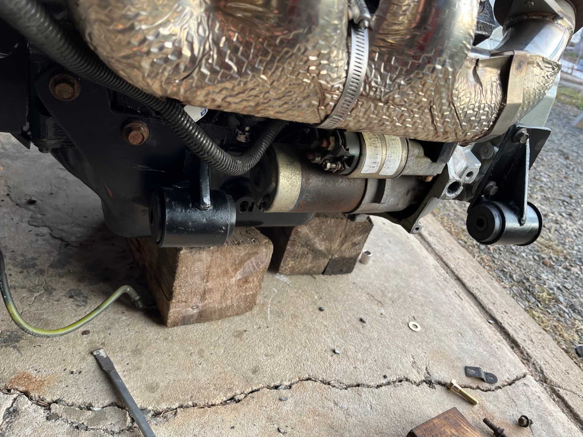

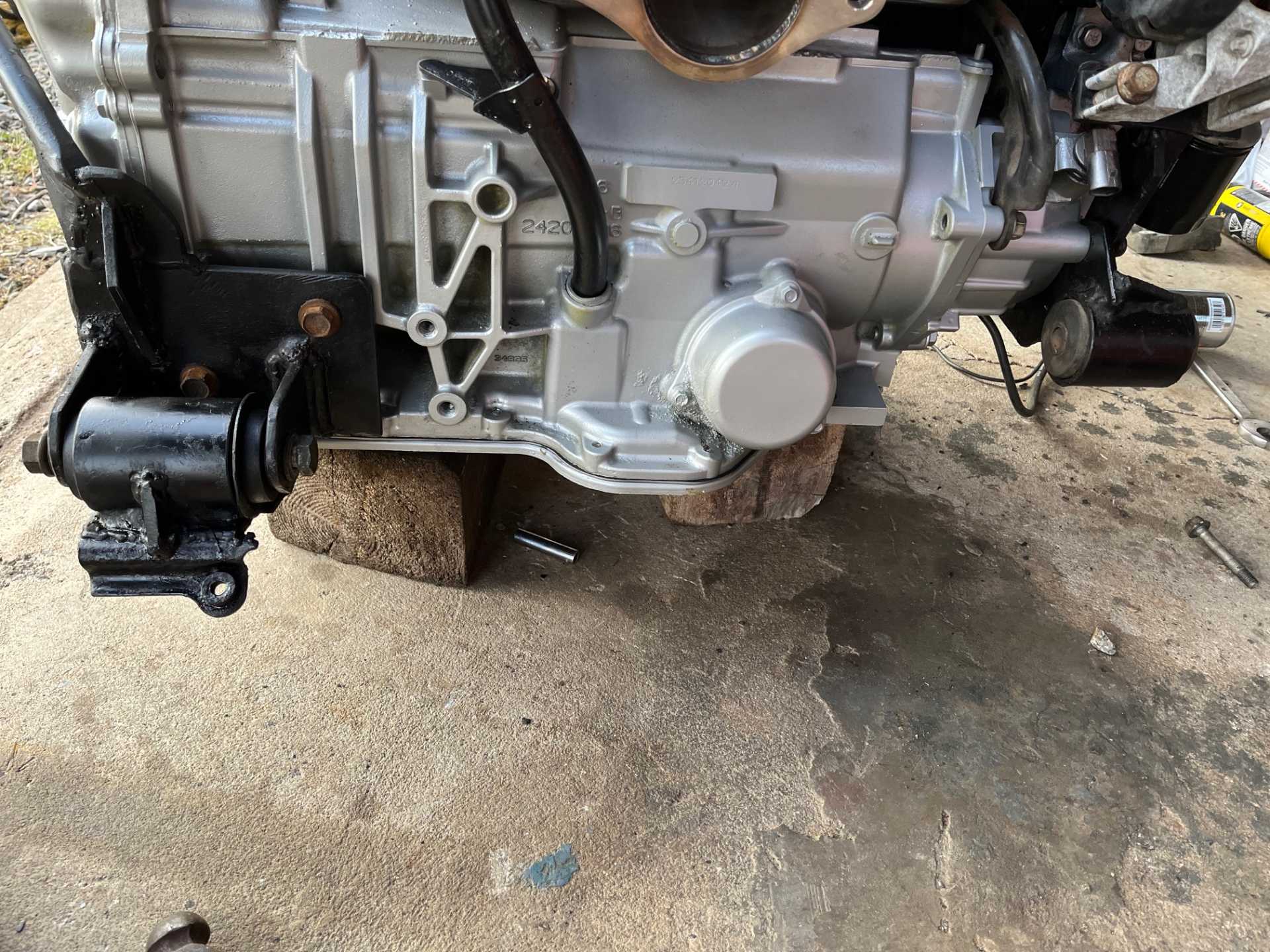

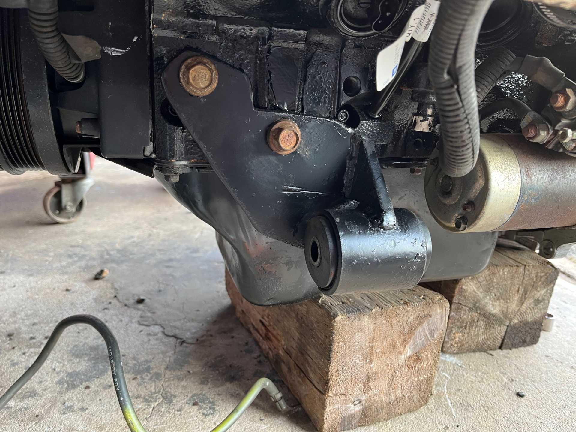

jelly2m8
AUG 17, 03:03 AM
| quote | Originally posted by Frenchrafe:
The cotton reel style mounts that "Jelly" shows are great for not breaking, but rubbish for confort.
You are 100% correct there, which is why I said un- forgiving. Driving it is fine, no vibration noticed, BUT at Idle in drive......I feel the vibration, I usually slide it into neutral at the coffee shop drive through etc.
I have thought about changing the mounts to something more compliant, but they need to be readily available. Perhaps these Mitsubishi one's are viable.[This message has been edited by jelly2m8 (edited 08-17-2024).]
