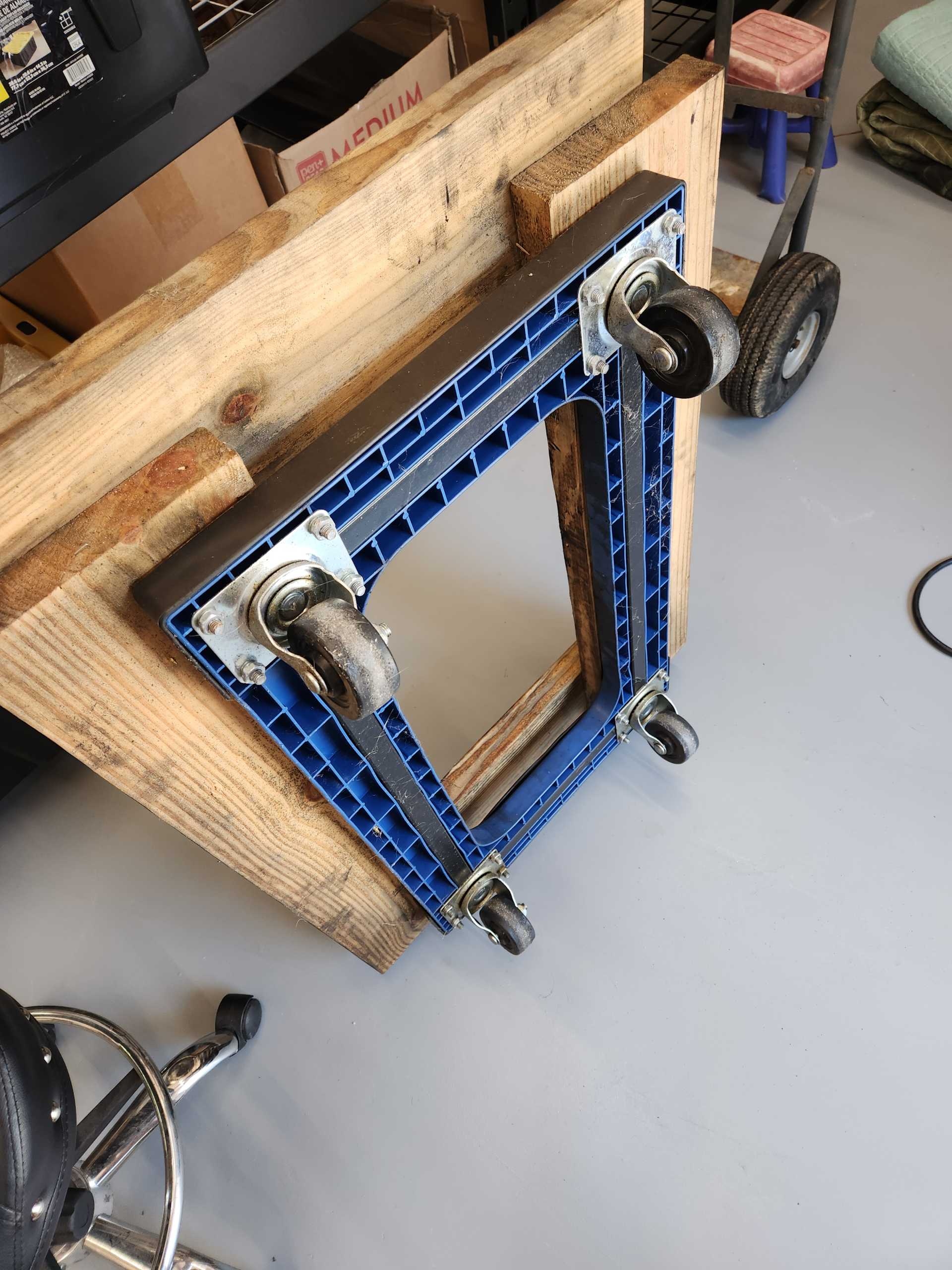

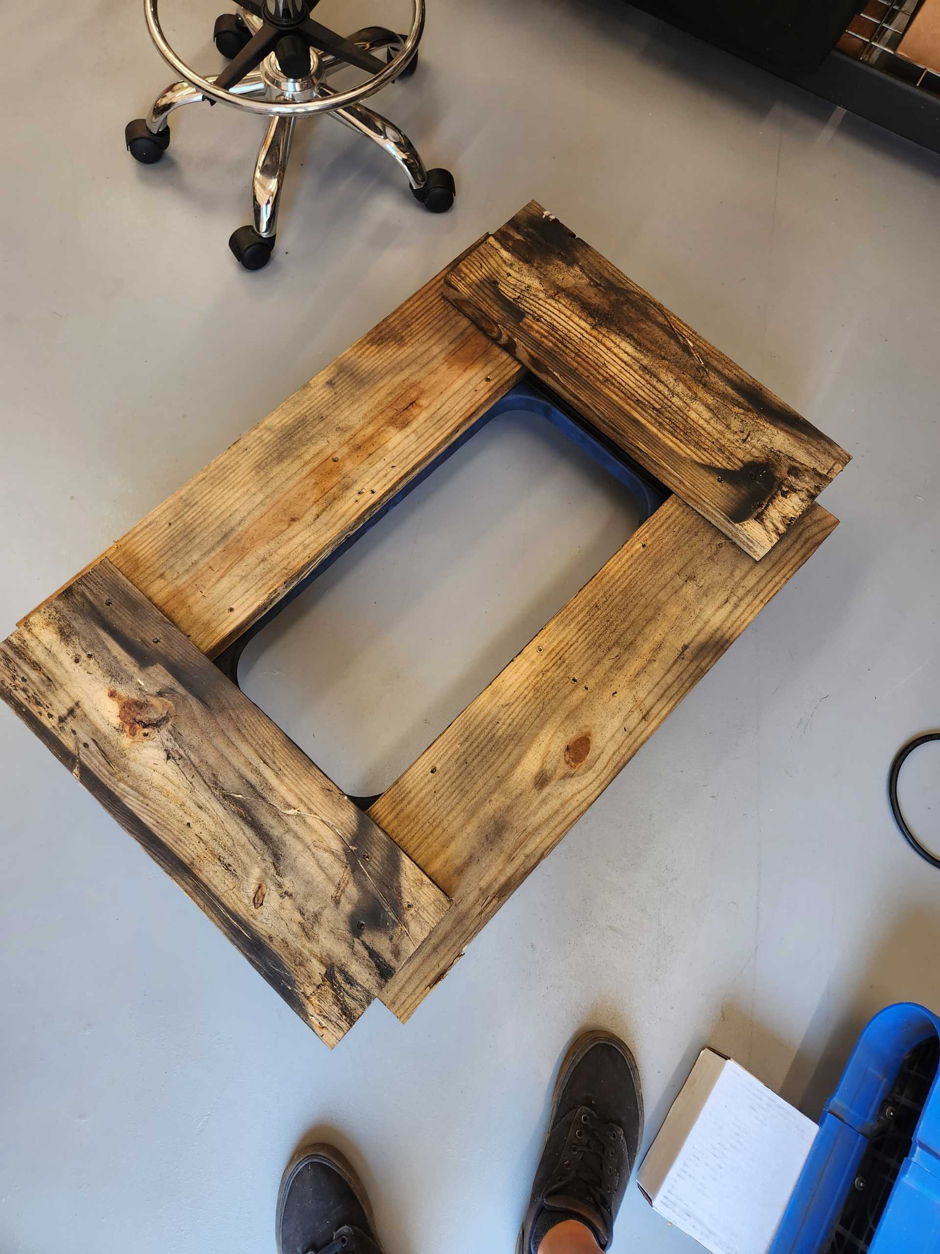

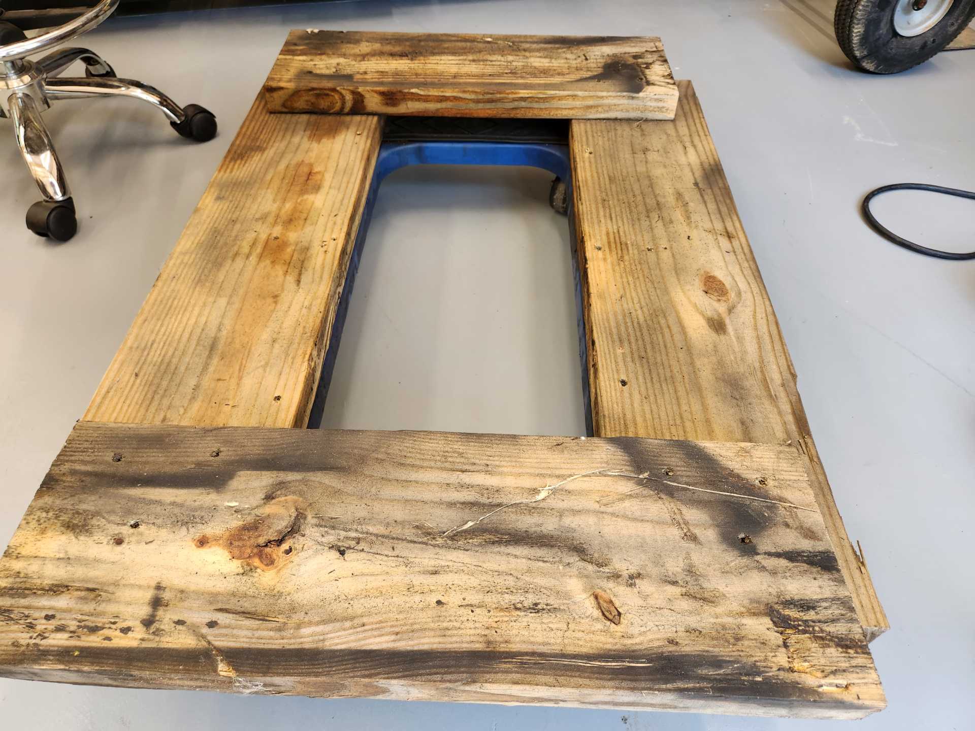

Dropped many motors with the lift. I use a Harbor freight dolly to hold the engine cradle. I do modify the dolly to have a bigger footprint with wood to match the cradle. Lower the car down to that dolly and unbolt the cradle from the car and lift it out of the way. Then just roll the whole thing to where you need it. I will take a picture of the dolly for you later.[This message has been edited by Spadesluck (edited 08-10-2024).]

It's all depends on what you are putting the engine/cradle on during removal. You don't necessarily want to drop it on the ground. You want to make it mobile. If you are working with a mobile platform that is taller then you can lift the car up higher to remove bolts.

This is the harbor freight dolly that I modified to lower the cradle/engine onto.
