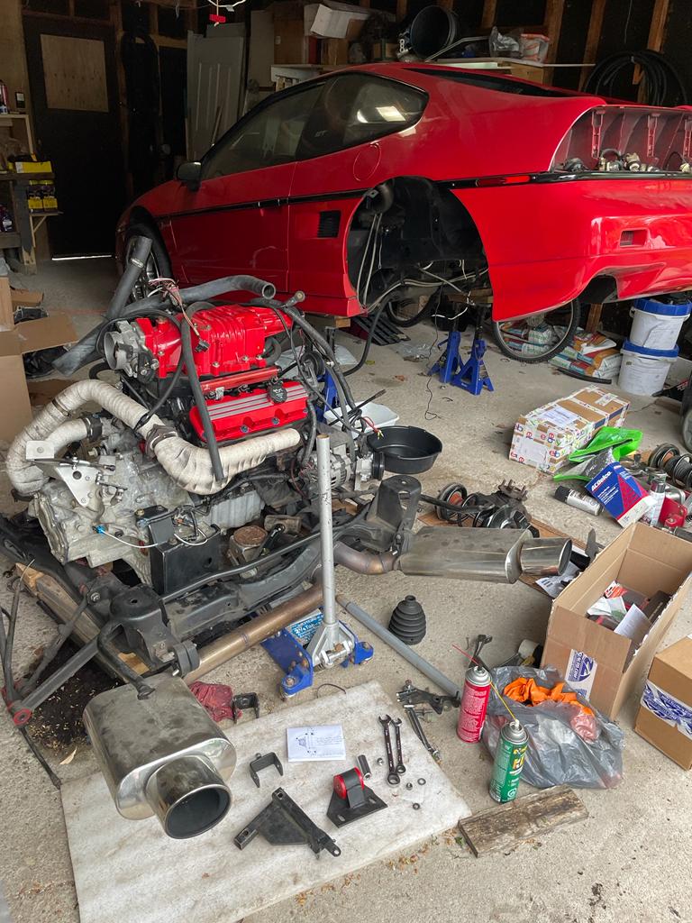

I currently have WCF headers on my 3800 that seem to be fine, but would like to put one muffler in the stock Fiero location. My current setup has 2 mufflers in the tailpipe location and looks/sounds terrible.
I do not want to cut my trunk, and hope to have minimal drone.
This is my current setup, which I want to replace with a single muffler.
Please post some pics or link to an old thread if you can show me the most common way to achieve this.  [This message has been edited by cam-a-lot (edited 08-06-2024).]

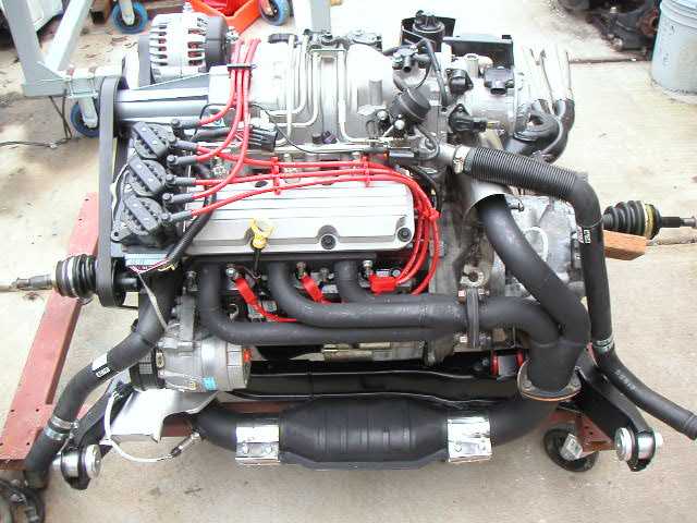

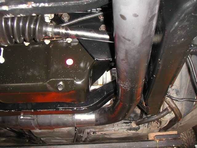

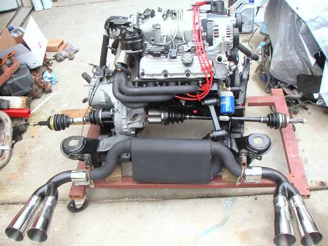

These are pictures of my exhaust with West Coast Fiero headers with 3" collector and 3" exhaust into a Flow-master Camaro crossflow muffler. The muffler has a 3" inlet and two 2 1/2" outlets.. The exhaust tips are stainless steel megaphones that are 2 1/2" inlets and much larger than stock megaphones.
I don't have part numbers, but all parts should all be available today. The exhaust tips were sourced from a motorcycle supply company in Florida. This installation was done in March of 2003 and is still being enjoyed by me 20 years later. It still looks similar to stock, but has a distinctly different sound, like something that breathes better, while not being too loud.
