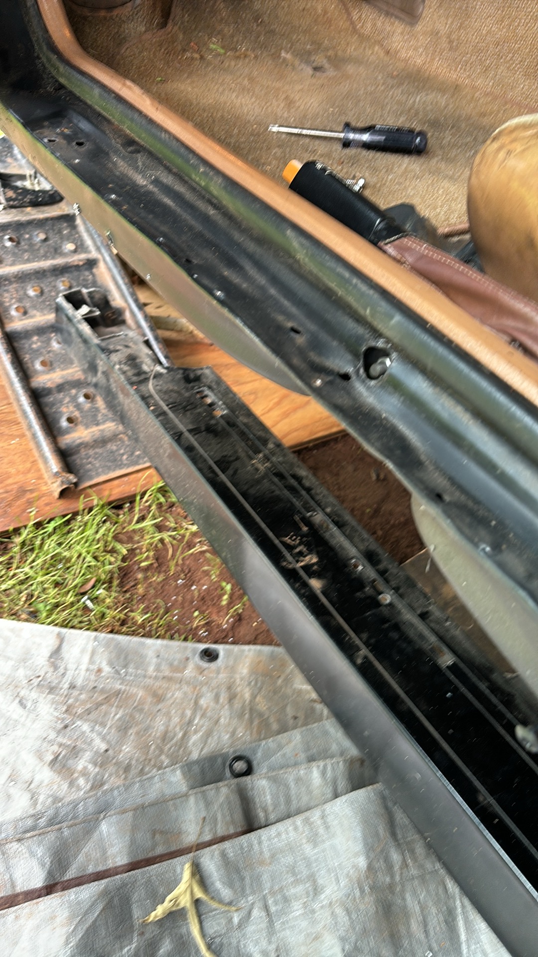

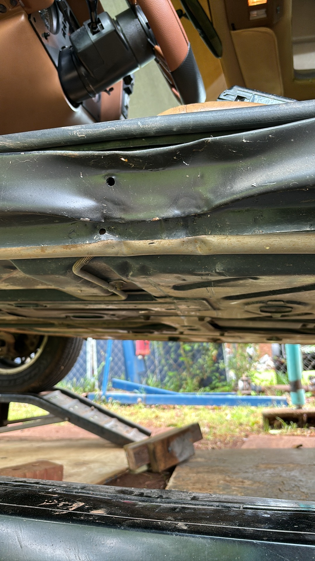

Hey Everyone!
I am looking to replace the inner rocker panel on the driver side of my 88 GT. Mine was damaged by previous owner by what looks like sliding sideways over a street sign. I don’t need the skit or the rocker extension, but the actual body-side rocker panel. I guess it would have to be either cut out of the chassis, or drill out the spot welds and removed.

JUN 30, 09:57 AM
Here is mine:

Couple of things... first, if it were me, I'd want to make sure the frame wasn't tweaked, in case there was anything that needed to be done before welding the fixed sheet metal in. I'd try measuring the distance between the door jambs from the passenger side and the drivers side, and a few other points, just to see if anything had been bent / damaged.
As for replacing the metal... there's a guy in Arizona (or is it Nevada?) who sells parts of Fiero frames (when he gets them) and he may have what you're looking for:
Mike at Mike's Fiero Parts boysatt1@gmail.com
Hope that helps!
