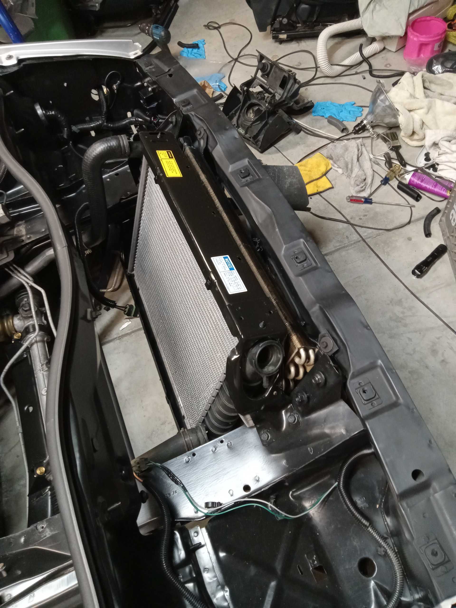

Hi ther, I'm want to replace my plastic radiator with a new one, the ones I found on ebay have hook up for AT Trans . mine is a 5 speed. Do they still make the non AT radiators anymore. ?

honestly I haven't seen a fiero without the trans cooler lone fittings before. should work fine on the manual though

No for Most brands & been so for many Decades. Reduces inventory numbers to just sell auto "cooler" type. Plug it w/ something just to keep road crap out. Don't tighten whatever plug a lot. Use pipe sealer so can't start "rust" there more so if plug metal is dif from cooler metal.------------------ Dr. Ian Malcolm: Yeah, but your scientists were so preoccupied with whether or not they could, they didn't stop to think if they should. (Jurassic Park)
