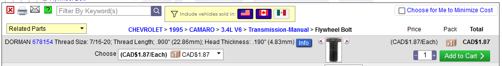

I got my bolts from Rock Auto. 93-95 Camaro/Firebird 3.4 manual transmission. Since they're Dorman parts, you can probably get them from your local parts store. I think another brand name is ATI or something like that.

The Dorman 678-154 flywheel bolt that is listed for the 3.4 Camaro has a 7/16-20 thread (according the the description):
The Fiero's threaded crankshaft holes are M10x1.0.
Do you guys have a different Dorman part number in mind, or is the description of the part wrong?
