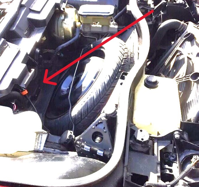

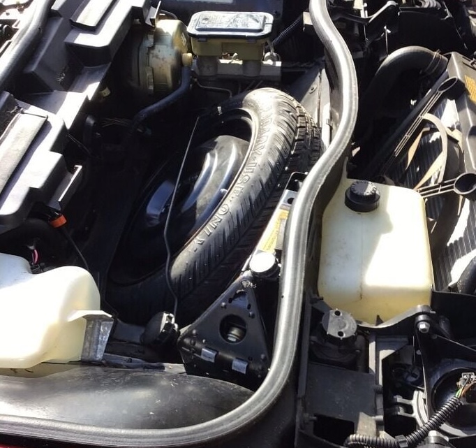

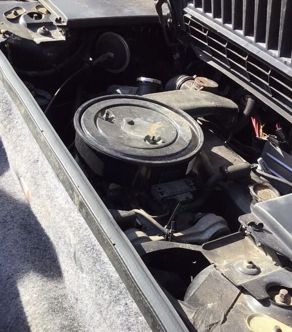

Weird question - is it possible to tell from these photos under the deck lid and hood whether this '84 SE has air conditioning or not? I'm guessing they don't show where the relays/ lines/ compressor would be but I'm not sure.

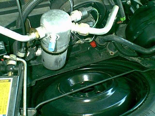

No A/C. You would see an accumulator in the front trunk area.
