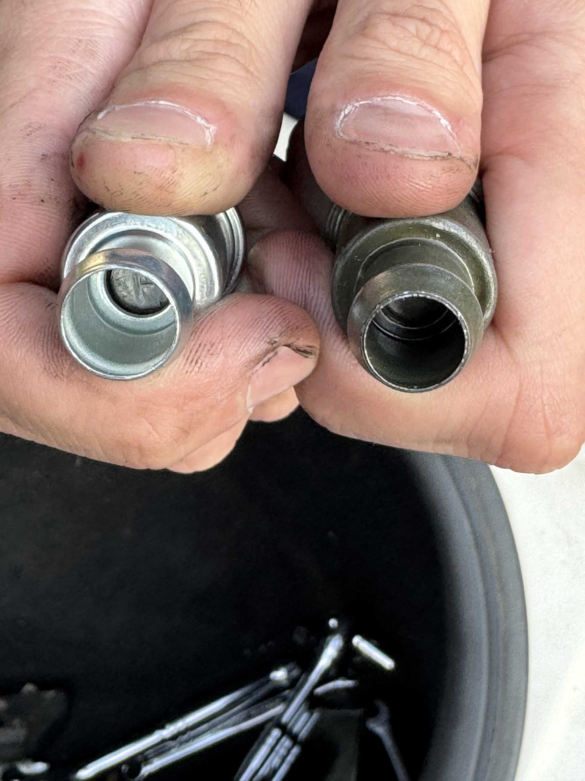

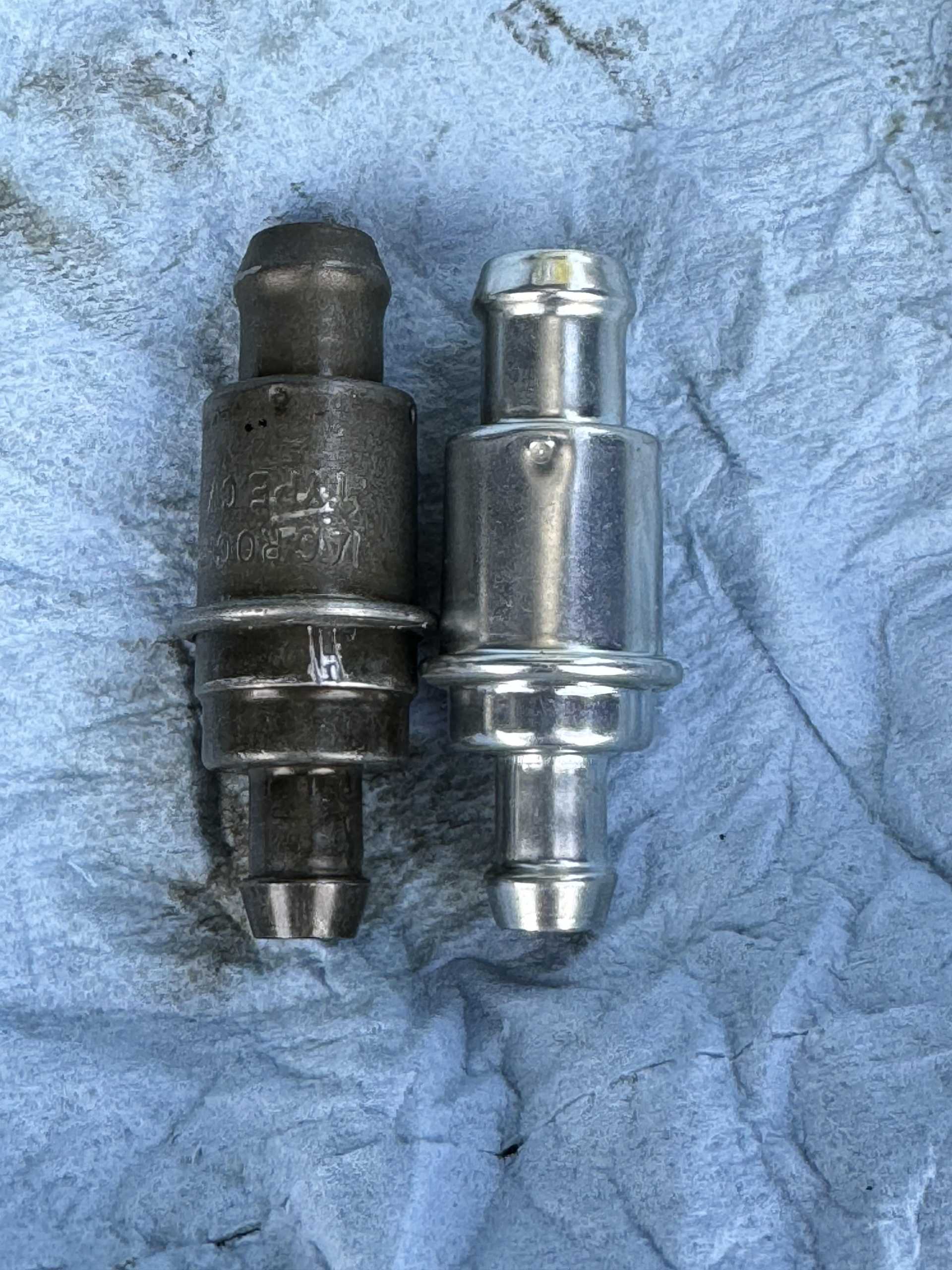

          | Hello again, I'm currently chasing a hissing sound near the airbox/throttle body of my duke. In doing so I was replacing the PCV valve. The new one I got is a bit different, shorter and the opening on one end is larger. Is it still compatible? I plugged it in and she seemed to run fine with it. Unfortunately it didn't stop the hissing though.
 (p.s) this was the one that my local autozone said would fit, don't know how accurate their database is though

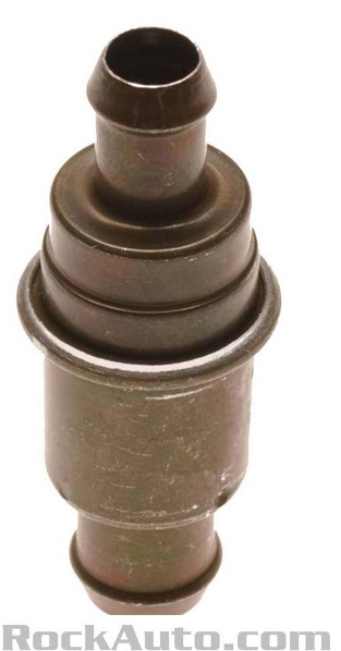

          | I'm a GM Original Equipment Fan.....
 1985 2.5L PCV - ACDELCO CV881C
  https://www.rockauto.com/en...ion+(pcv)+valve,5052
