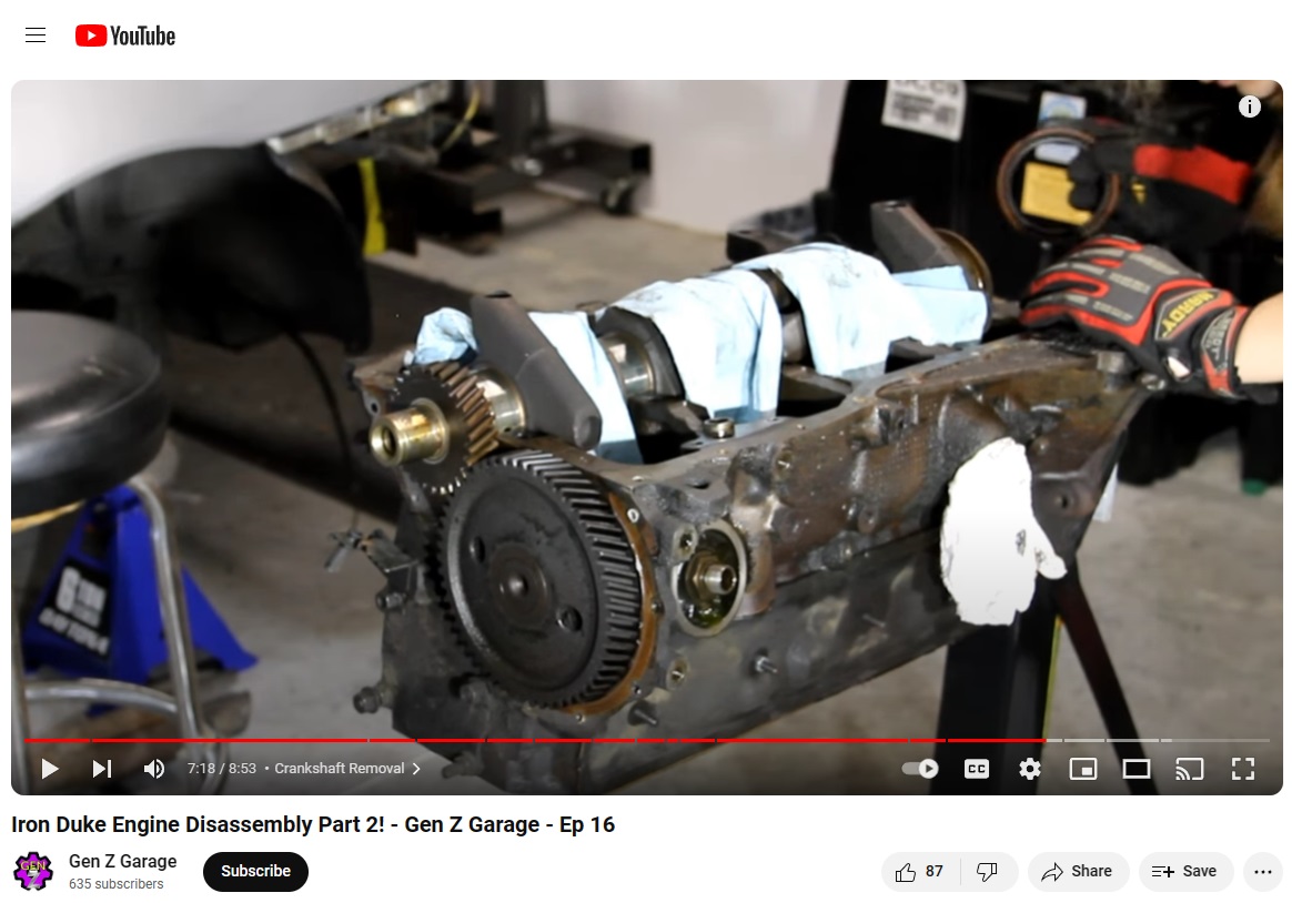

Joe, we've torn the ENTIRE car apart. We took 100s of pictures. Every screw was bagged and labelled, and lots of pictures... and tons of manuals, but this one thing wasn't covered in any of the manuals.
... I guess we DO technically have a video of it...
But shoot you guys are a tough crowd. I appreciate that you guys think so highly of me that you expect me to know these answers already... but I took a 14 year hiatus from working on cars. I'm ok looking like a complete idiot so long as everything gets done properly. Anyway, I wouldn't have asked... but I searched literally everywhere, and this was the closest thing I could possibly find that even slightly gave me an answer... https://www.scegaskets.com/...r-Main-Seal-Inst.pdf
