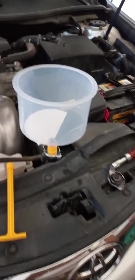

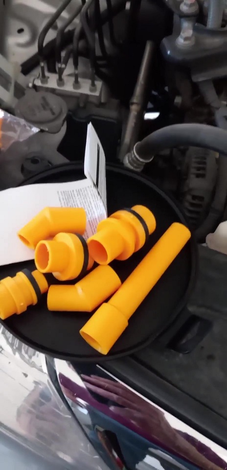

So... it'll fit on the thermostat housing?
APR 23, 09:21 PM
The ones we have do not, but we have had them for a while....
APR 23, 09:28 PM
I don't understand how this coolant fill funnel could be of any use on a Fiero... unless the front of the car is raised so much that the rad cap becomes the highest point of the cooling system.
Dodgerunner
APR 23, 09:41 PM
You still want the front low. It just make pouring coolant in much easier, and when it starts getting full blipping the throttle will not overflow out the fill over the engine or when a large burp occurs it does not runover, it just comes back up into the funnel. Sure you don't have to have one but it's just handy in many situations.[This message has been edited by Dodgerunner (edited 04-23-2024).]
