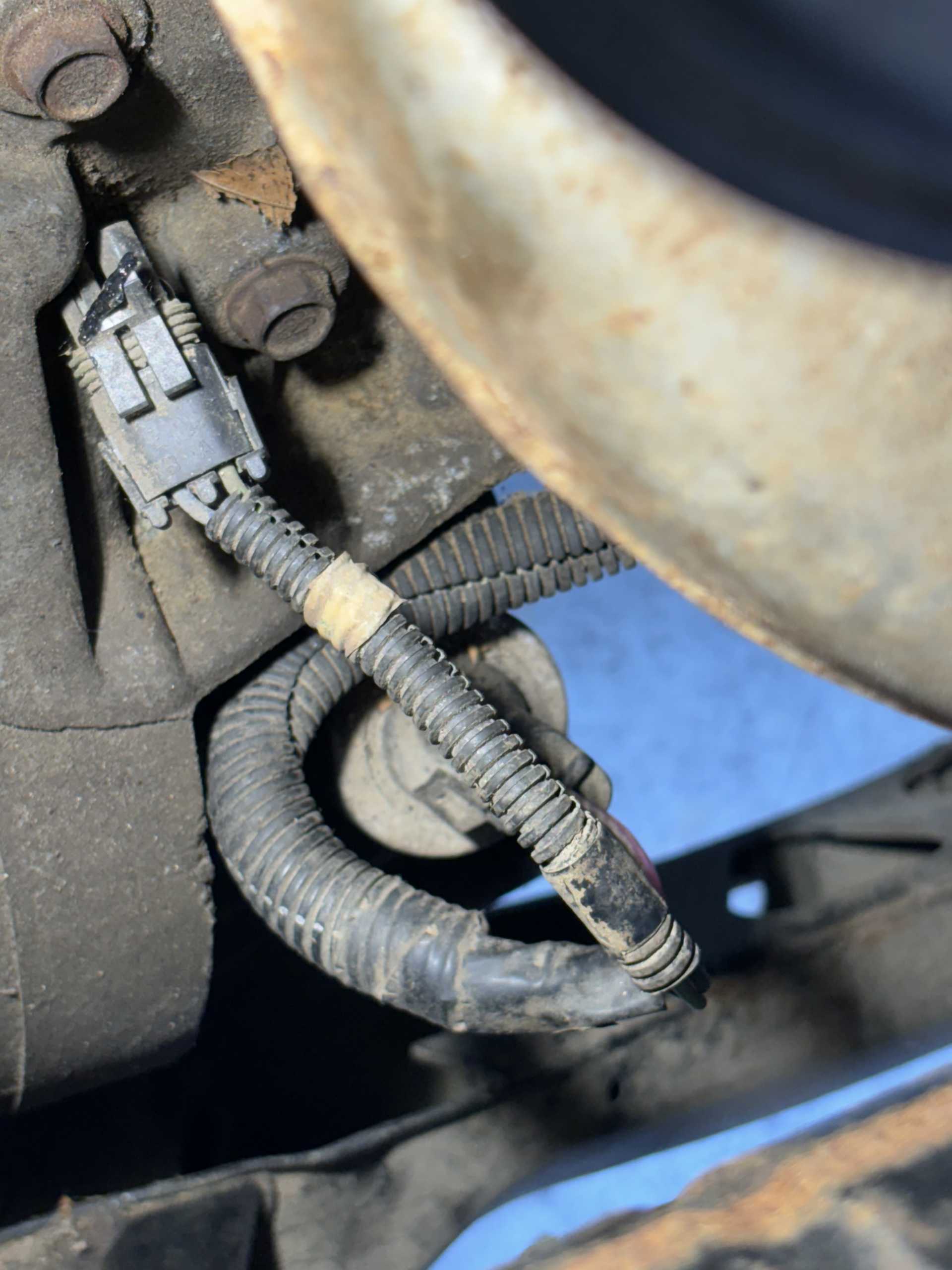

Helo All. I have an 86 SE 2.8 with a four speed. I found a plug that was not connected to anything. It is on the same harness and right by the speed sensor. Does anyone know where it plugs into?

It plugs into the backup lamp switch on the 5-speed transmission (which came in late 1986 models).
It is left not connected on 1986 4-speed Fieros.
