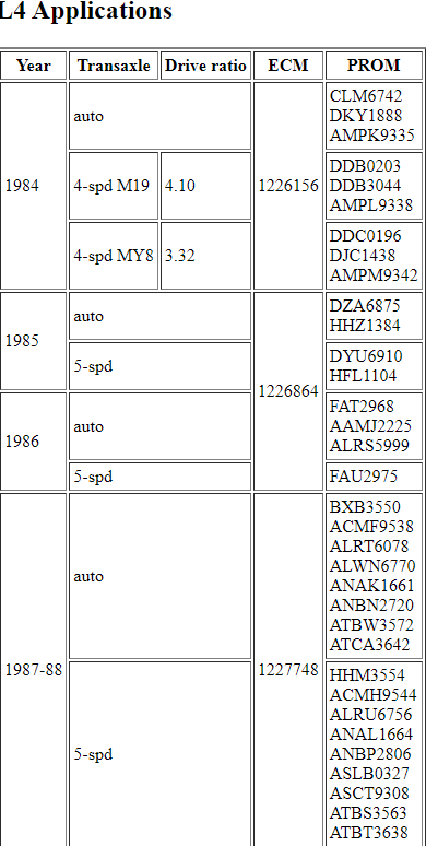

Hey guys, long story short... I'm planning on ordering a 1986 2.4 ECM because they converted to the V5 A/C compressor system (which is controlled by the ECM), in the 1986 model year. So it's a no brainer since I plan to convert to the V5 variable compressor.
Question though... my daughter's 1985 Fiero 2m4 SE has a manual transmission, and I know that with that, comes the "shift light" which I like, and I don't want her to lose that.
When I look either on Rock Auto or on eBay, there are tons of them available... but not a single one says it's for an automatic or a manual transmission.
I know specifically the manual transmission one supports the shift light, while the automatic one supports the torque converter. What am I missing here... does it not matter? Should there not be different programming for both? Or... what?
APR 06, 09:59 PM
I believe it's the PROM, not the ECM itself that's different for a manual vs an automatic transmission.
APR 06, 10:18 PM
I believe it's the PROM, not the ECM itself that's different for a manual vs an automatic transmission. |
Yeah, some of them (on Rock Auto), say that they need to use your old PROM, but others say "no programming needed, ready to go..." so that's where I'm confused. My guess is that they're putting on an automatic PROM, and therefore they cover both bases... but then I'll likely lose the shift light. Not something I'd want to eliminate, because that's super cool... haha...

Wrong. All ECM Does Not Care about what AC System(s) are used. They Only have "Final say" that the AC Clutch Turn On & Off & adjust engine timing etc as needed when On. Example: When you Floor the Gas, ECM Shuts Off the AC during the event.
Just Use Same ECM because in your case is already same ECM # anyway.
You will Bypass the Clutch Cycle Switch required by DA6 & HR6 compressor on the ACC/Drier can in front of car. Also need to Change the Control Valve In the V5 for using R134.
ECM doesn't about wiring etc because the PROM has right "flags" & code for whatever engine & transmission. In Stick cars not only changes 1 output pin rules for On/Off but also uses different engine setting overall & have different "Anti Stall" setting too. AT cars use Same ECM Pin to run TCC locking.

Thanks Ogre, this is really good information. MAYBE it's different in the V6, and that's where I was confused. I wasn't sure... but I bought a 1986 Service Manual just in case.
If there doesn't appear to be any difference then (as you say, the ECM doesn't care what kind of compressor), then I don't even need to go to a 1986 PROM anyway.
I'll dig into the manual when I get it, and then share what I find.
