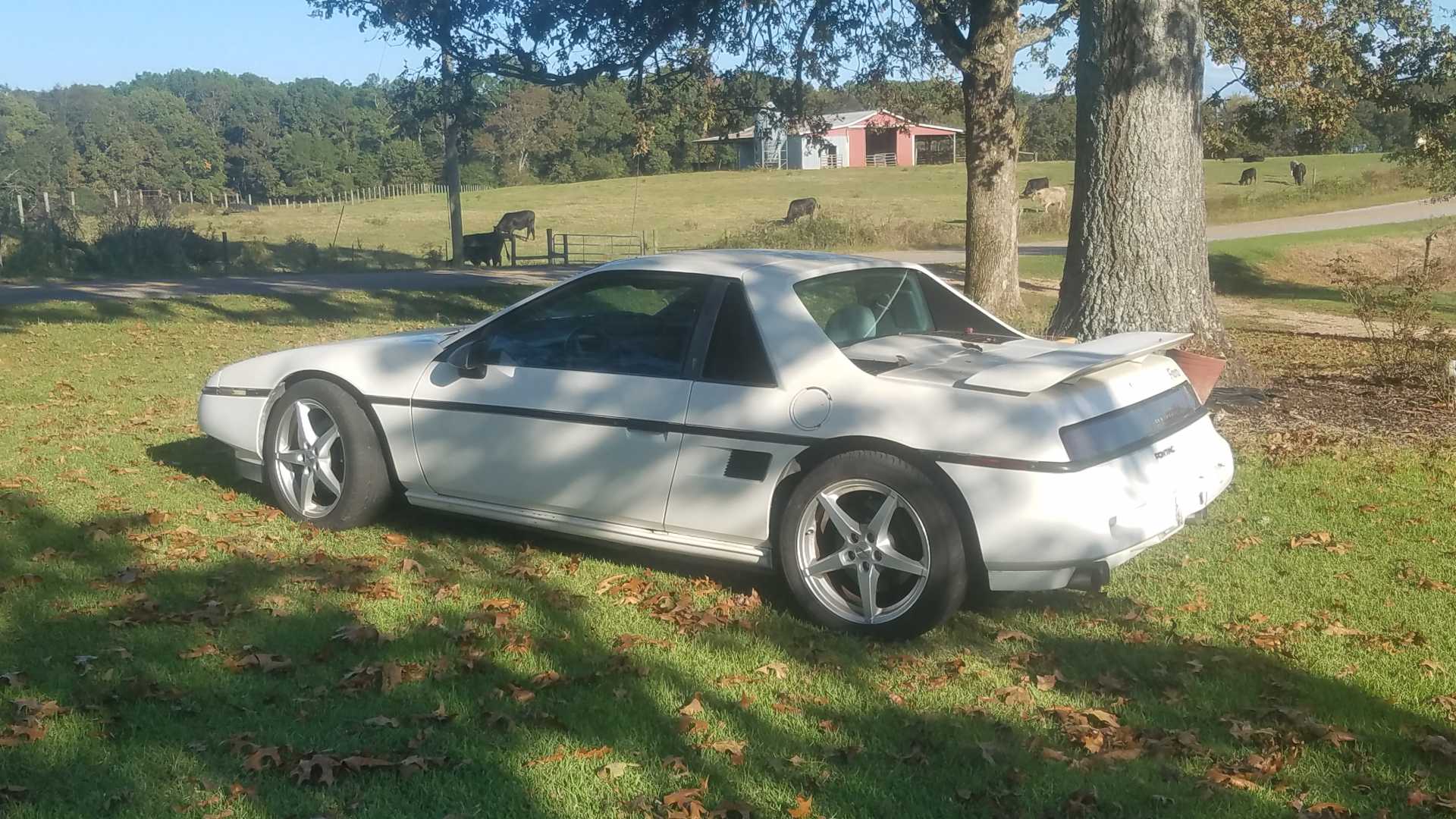

All of my cars (88s) have cut springs in the front. This one is cut by one coil. I have poly everywhere except the trailing links. It still rides fine. Monroe shocks and struts.
