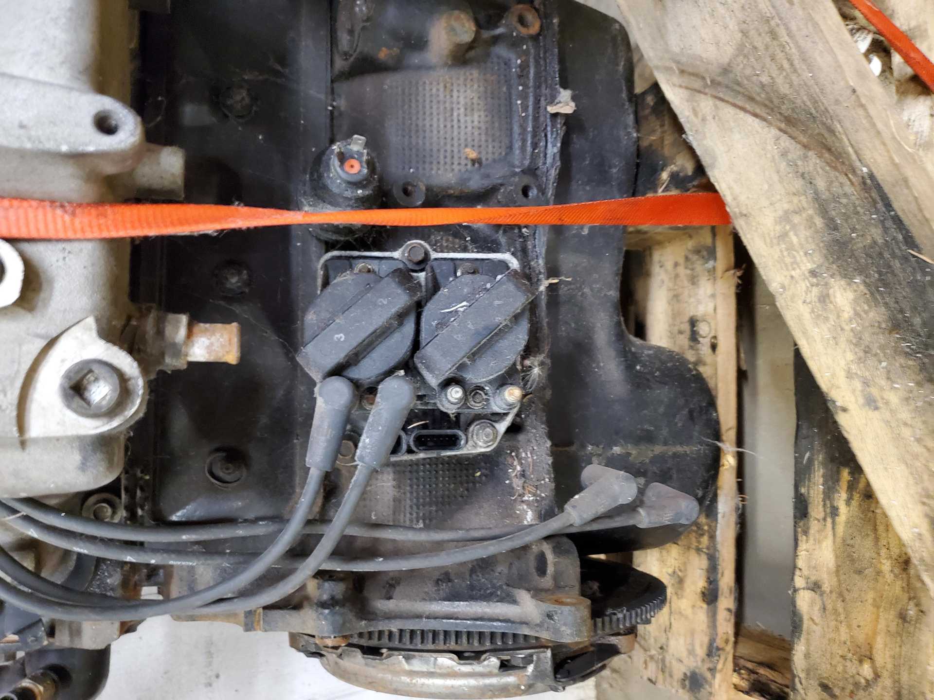

hey fellas i picked up a 4cyl engine to swap temoraritly just so i can move my car around and get it ready for paint ( I cant leave it in the space overnight). while i see whats wrong with my rebuilt. my car is a 84, i believe I saw 87 on the other engine . i picked it up at night so i didnt look at it until i was dropping it off. it doesnt have a distibutor it has coil packs and a different intake. if i remove the coil packs can I gain access to the hole for the distributor?? do i have to change the oil pump?? I have another intake and throttle body so im hoping that will fit i have an extra oil pressure sensor . The engine didnt come with the computer or wiring it also has 200.000 on the engine but it was running before he swapped it out last year and it was under cover . This engine is temporary pic of the coils
any help is appreciated.

You bought an '87 duke to "temporarily" fill in for an '84 duke? I'm afraid you've probably just caused yourself more grief. It's not a plug and play operation.

quote | Originally posted by Patrick: You bought an '87 duke to "temporarily" fill in for an '84 duke? I'm afraid you've probably just caused yourself more grief. It's not a plug and play operation. |
X2
87 & up is a completely different engine that "just" share a few parts in the engine & fit same mounting points to fit the car & transmissions. Can't even use 84 ECM & engine wiring hardness.

Dude, I'm so sorry. Just like everyone else has said, it is absolutely NOT going to help you out.
Among a few really important things:
1 - There is no hole for a distributor (only for a sensor) 2 - There is a crank and cam sensor 3 - The engine uses a completely different pulley set. 4 - The engine uses a completely different ignition system with totally different ECM. 5 - The engine uses a different cyl head, which has a different intake manifold and throttle body than your 84. 6 - The engine uses a different front motor-mount bracket 7 - The engine uses a different alternator, and A/C compressor. 8 - It uses a different pulley system.
With an 84... you can basically use any engine from a 1984-1986. Halfway through 1985 and 1986 it uses a roller cam (which is objectively better, but no available aftermarket cams from what I can see).
You basically do not want to use this, and in my honest opinion, it's not worth the hassle because there are so many other things you'll need to buy.
Can I ask how much you paid for it? I'm actually looking for an 87 (non-88) block and cyl head. I would be interested in buying it from you if shipping and everything isn't that bad. On the other hand, if you were willing to go through the effort and work... an 87 block would be an upgrade to your 84 engine. It was the first (Fiero) motor to use a belt tensioner, as well as DIS ignition. There's a lot you would need to do if you wanted to make it work, including buying a lot of parts that you're currently missing... but you could also go with a MicroSquirt ECM and build your own harness and just buy all the new sensors.
