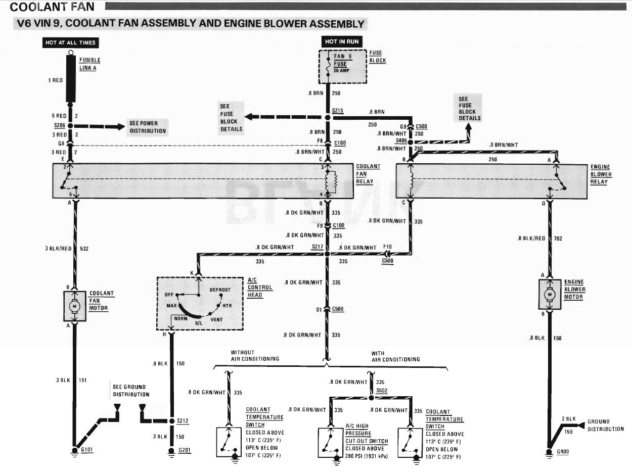

Here you go...
And Yes, it is normal to have full manual control of the Radator Fan using the A/C control and check the fan switch on the engine block (bottom on the page)
BTW - In 2003, I heard that my '88 GT Radiator Fan was "On" on a cold start with the A/C control "Off".
As the factory A/C stopped working (no cold air) and the compressor belt was removed years ago; I found that the A/C High Pressure Switch had shorted to ground causing the fan to run constantly.
By disconnect the A/C High Pressure Switch from the Compressor, the problem was solved, and the fan switch and the fan have been working properly after the event.
----------------------------------- Original Owner of a '88 GT and under 'Production Refurbishment'[This message has been edited by Vintage-Nut (edited 08-28-2023).]

Does the engine (trunk) blower come on?[This message has been edited by Patrick (edited 08-28-2023).]
Yes, both tubes are blowing.
