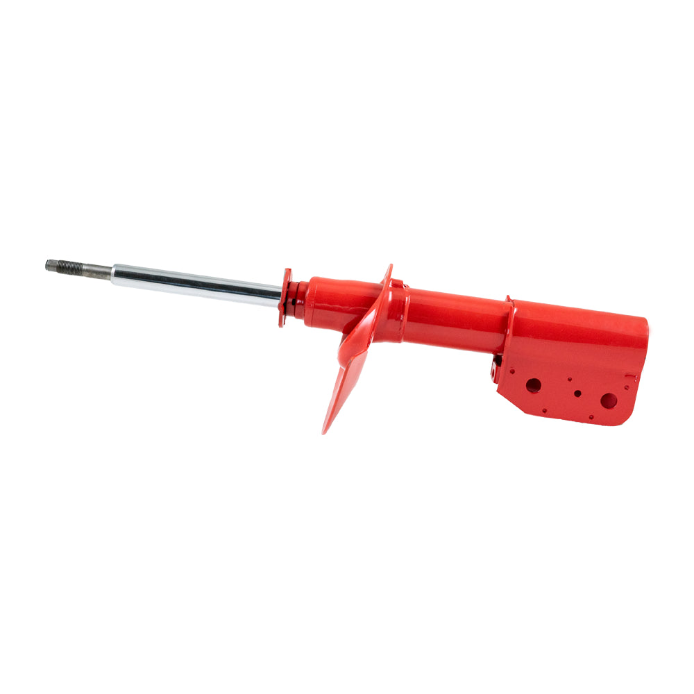

Anybody ever tried using them? i am working on an 88, and bought a gp front strut, compared lots of measurements and was very convinced it would work well. Then i called zzperf and the guy said oh, yeah lots of people try that, and something makes it undoable (he couldnt remember what). zz sells an agx adjustable strut for $150 each. little extra lard in the gp makes me think its struts will be valved heavier which would be good for my 350lbs/inch (thanks for posting info guru!!) springs. the body diameter was very close, the body length was very close. the shaft length was a little longer. the big bolt holes were over 1/2" further apart. i would keep the upper bolt hole and slot the lower one up to drop the strut body as much as possible. the mount was way bigger/unusable. any ideas whether or not it would work?

I think you will run out of material in the strut to knuckle flange.

The Chevy Citation strut is exactly the same as the Fiero strut....And the angle of the spindle mounting bolts is different on those Grand Prix struts.
A couple of guys have mounted a Bilstein cartridge strut using a cut down old Fiero strut as a mount adapter....But we really need to know which Bilstein strut they used. I have a friend who makes custom suspension parts for 1st gen Mustangs- really amazing stuff. He would probably be willing to make adapters for those Bilstein cartridge struts...

The weld bead for the spring perch on the Citation is about 1" lower on the strut body than the Fiero. Not a big deal if going with coilovers, but definitely not exactly the same either.
Fieros used to have a Bilstein non-adjustable strut, but is long discontinued. If you can find one of them, you can have them rebuilt/re-valved.
If the OP is looking for heavier cars that used a compatible style strut, the GM dustbuster minivans would be the place to look, but there are no performance versions for that application.

That first photo makes it look like the lower bolt holes almost line up. They do not. Gp strut was spread ~3/4” farther apart.
