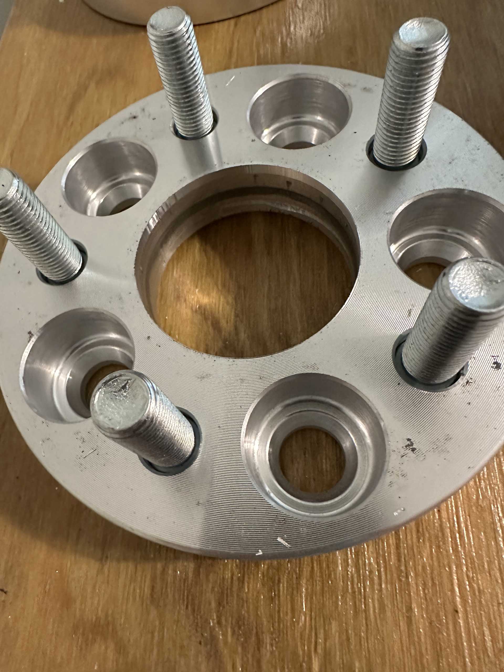

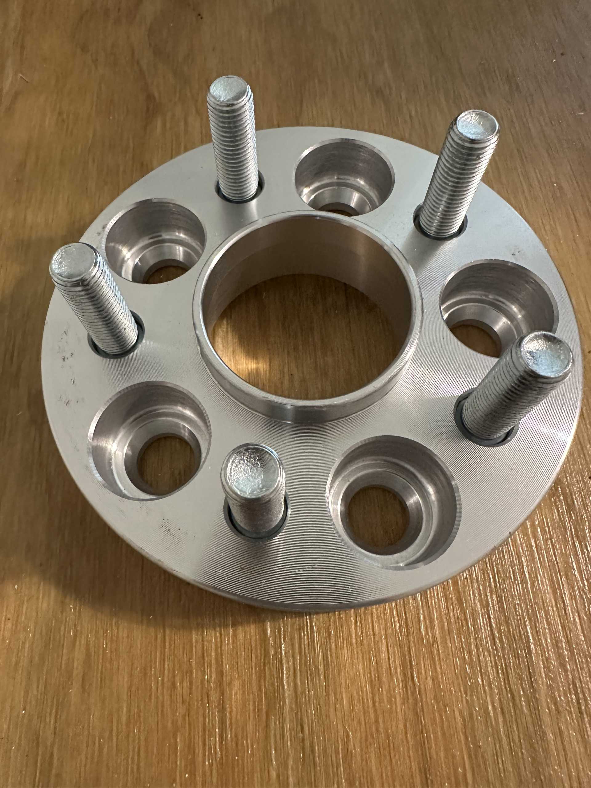

Started with a 1 inch 5x100 to 5x100 spacer with a 57.1 mm bore

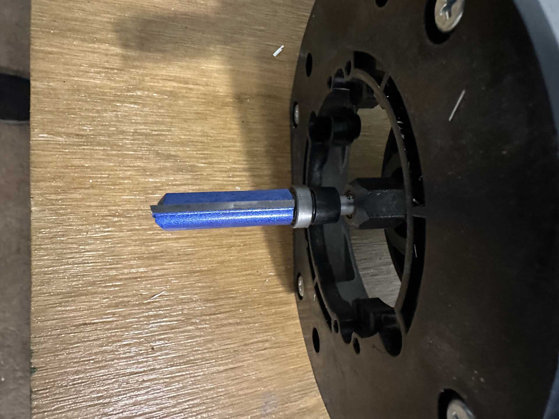

Using a flush trim top bearing router bit, I cut off the lip to make it a constant 57.1 bore.

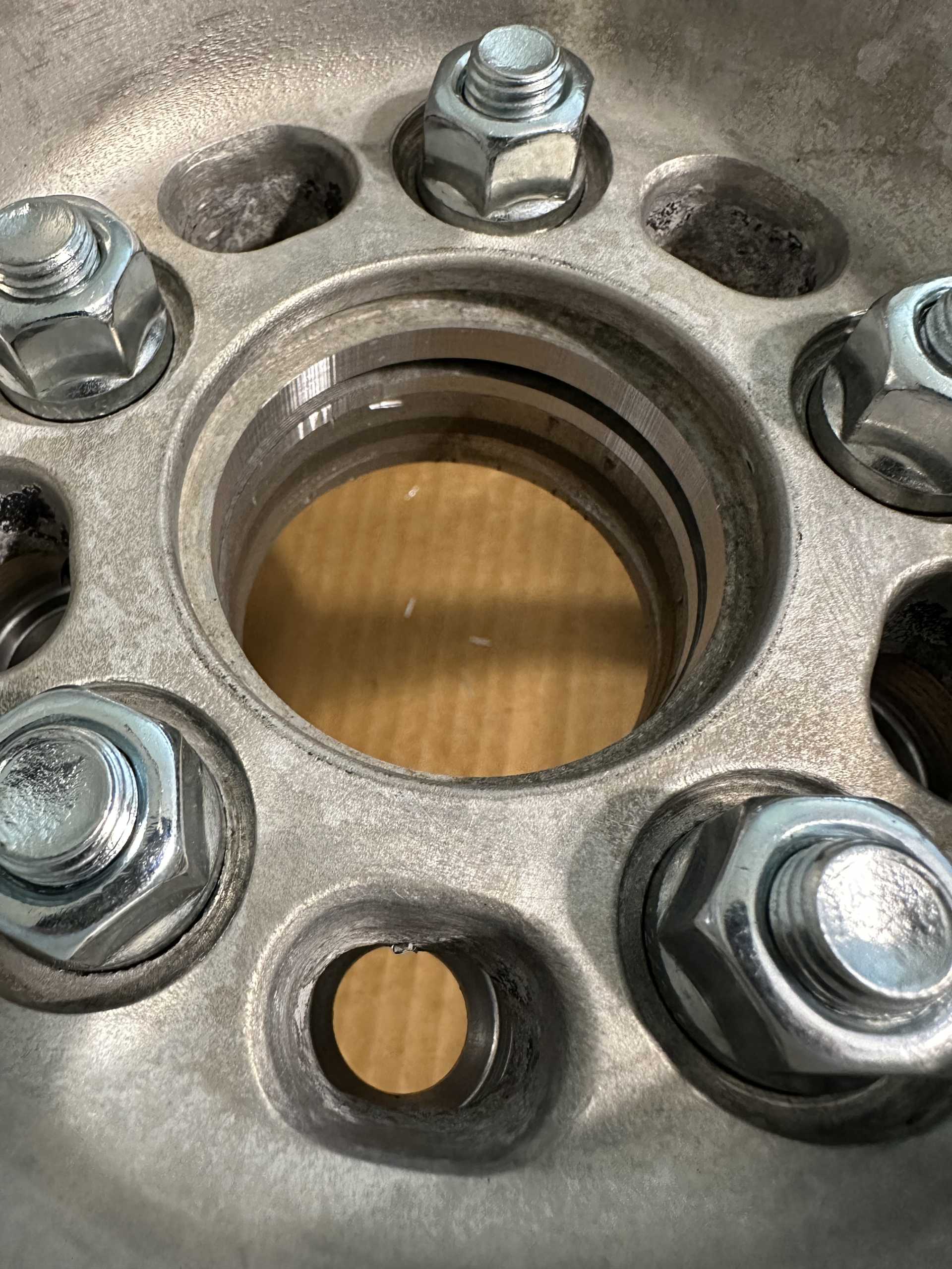

Bolted it up to the wheel and using the router again, machined the wheel itself
And now the wheels all have a 57.1 mm bore in about 20 minutes of time and $50 for the spacer and router bit
