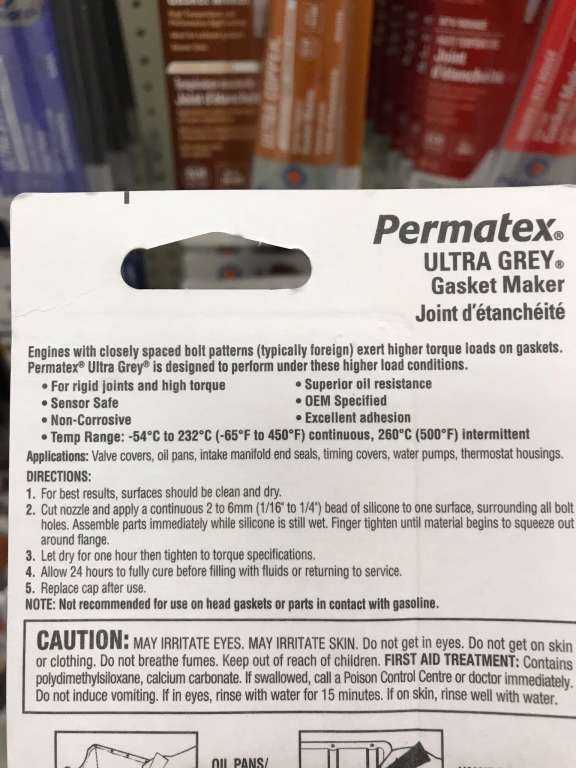

I'm not a real expert on RTV, but I understand the key is to get a good bead on clean dry surfaces, tighten the bolts just enough to start squeezing RTV out and leave it for a day to set up. Then tighten to spec. I wish the 88s had gaskets, but they don't. I'm going to get some extra bolts and cut the heads off to make locating studs to make installing the pan easier without messing up the RTV beads.

| quote | Originally posted by KennyG:
I'm not a real expert on RTV...
I've never replaced an oil pan on a Fiero, but I did it to my JDM Subie a few years ago (with the engine still in the car but raised a few inches). I had also never used Permatex Ultra Grey previously, and was concerned that with no actual "gasket" I'd have a leak afterwards. I spent a lot of time cleaning and preparing the surface on the block (the pan was new), and was very careful when lifting and positioning the pan onto the block. You only get one crack at it! However, it all turned out fine. I was a happy camper.
