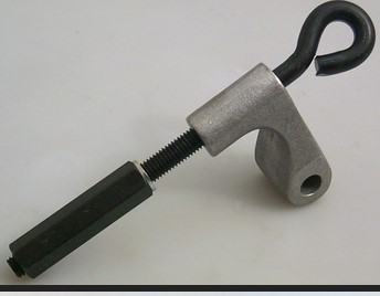

This is Fiero related because I bought new plugs for my new Fiero, but I don't know how I am going to get to the front 3.
https://www.reflectionk.com...rm=23856785746580126 Seems like it would be like a combination of a universal joint and an extension. And sometimes even universal joints are hard to wok into tight places.

There have been several questions about the front plugs over the years. Some people simply remove the dogbone and use a ratchet strap to tilt the motor towards the rear and that gives them enough access to use standard tools on the plugs.
I use that same bendable tool in your post for my line of work. They work very well but they also twist into a pretzel if the bolt is too tight. If the plugs have not been changed in many years, you will need to get your hands in there with a socket or you'll strip the sparkplug nut and then you'll have a real problem.
The other issue is that it might be easy to remove the plugs with that tool but you'll still have to get your hands in there to start the new spark plug threads so at that point, you could simply use a standard ratchet and socket.[This message has been edited by IMSA GT (edited 07-16-2023).]
