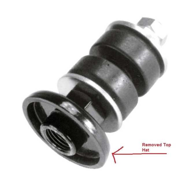

   Another problem I found was my QA 1 shocks came with the Camaro top stud kit which has a cap that was contacting the Fiero frame which caused some of the noise. It put the shock shaft in a bind against the side of the upper mount hole in the shock tower. I cut the cap down to fix that problem and now I can back out of my driveway without any pops or creaks and the front suspension is quiet on rough surfaces.
