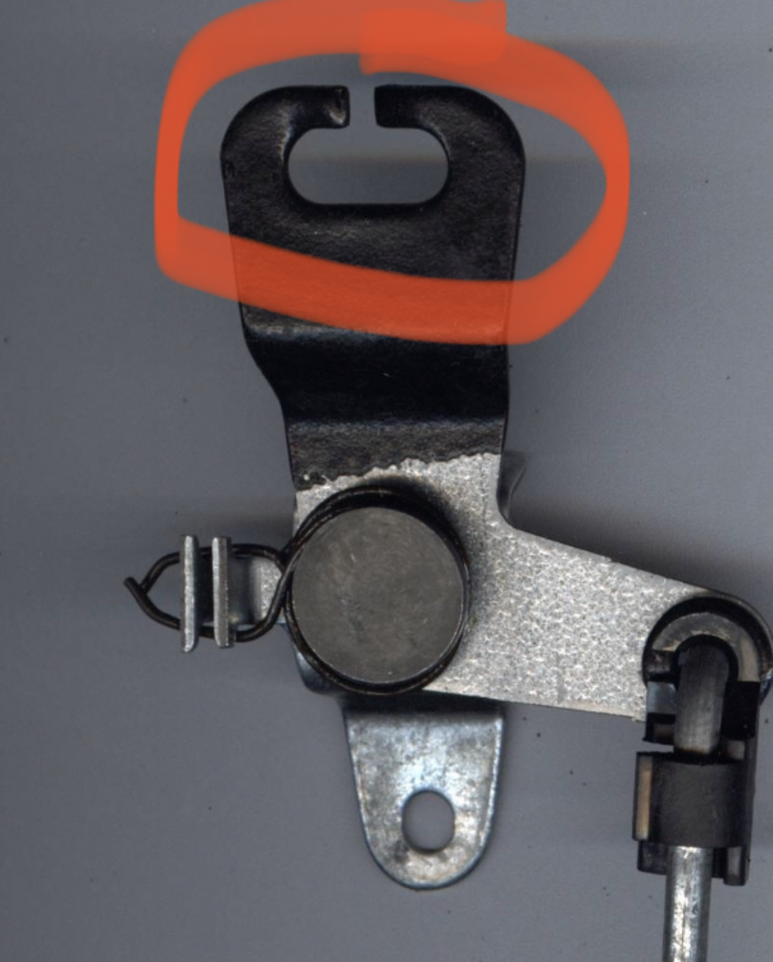

            This may have been discovered long time ago, but I couldn’t find it in the search.  Tired of my power locks not fully locking or unlocking (even after removing all components and degreasing, then re-greasing).  I went to the wrecking yard and pulled two rubber grommets “circled in the photo” off of a GM power lock solenoid, and stuck em into the empty space shown in the 2nd photo. PL’s work perfectly now. Took longer to remove the door panel than it did to fit the rubber pieces.     [This message has been edited by donuteater306 (edited 05-29-2023).]

            How does that affect what happens to the solenoid when you use the manual lock/unlock slider?

            When you slide the lever for the lock, the solenoid moves with it.
